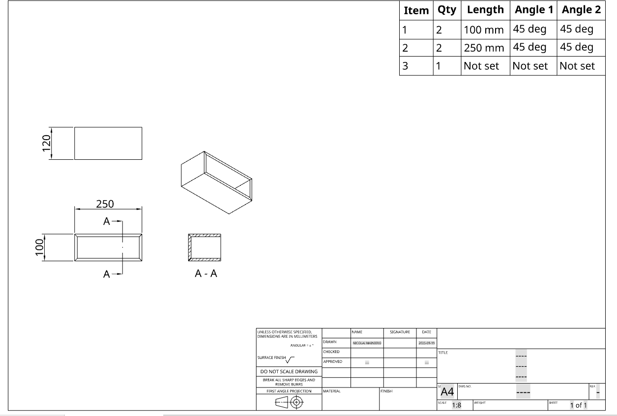

Hi,
I have the following simple drawing, which first extrudes a rectangle and then hollows it out to represent a box.
See also here in this document: https://cad.onshape.com/documents/214aa4eaf39eff0148bdd0a8/w/6379bcb6ab93cd75d52110e0/e/09e1f90190fabaca67885e49
How do I turn this object into 5 panels so that I can recreate it in wood, for example? I have tried cutting and Boolean operators, but that seems unnecessarily complicated to me.
Or am I thinking about it wrong, and this step is done later with other tools?
Any tips on how to do it correctly are welcome.
Thanks.

    There are a few different ways to do it. You could manually draw the shapes in your sketch then Extrude-(New) each one separately. Or you could use the Split feature to split what you currently have into individual pieces. Using split can be unstable if you are looking for a commercial grade model that is extremely robust, but should be fine for a simple box.

    @christopher_dziuba has a woodworking script called Make Skins that I've been using as the first step to my cabinet builds before I engage my Miter Warlock step. One day I'd like to combine the two into one feature that allows you to specify which edges of the cabinet body are supposed to be butt joints and which ones are supposed to be miters, but Cabinet Warlock is not going to be out in the near future.

    Another quick way to do it would be to create the "solid" outer shape and then use thicken on the faces to create the sides, you would need two features to do the opposite sides to avoid automatically making them one part.
    Then you can use boolean(s) or move face to create but joints

    Hi, thanks for all the ideas. Miter Warlock is impressive, but it's a bit over the top—I actually want to keep it simple and have butt joints.
    Make Skins seems like the better option to me, but I've noticed that when I select the back in one feature and then both side pieces in a second feature, the bottom disappears.
    Am I doing something wrong when applying the features?
  • christopher_dziubachristopher_dziuba Member Posts: 102 ✭✭✭
    @nicolai_mainiero So sorry to get back to you so late. Problem is you're using the latest version which I totally messed up. I'm trying to make the skins stable to downstream changes. V37 (Clean) is the current version I use for work everyday. Big problem is I can't seem to make the internal Part ID stable to selection changes. If you do use this feature make sure you get you're selection right the 1st time. Until I fix this feature anything that references those "Skins" is on thin ice.
    @nicolai_mainiero Scratch that! I've made it work :) Latest Version V43 (Clean) will work perfectly hopefully. Its robust and code is easier to understand for anyone wanting to mod.
