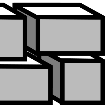

i wanna make this pattern on a curved surface
Can anyone help so i Can learn more of this awesome program 😀
I tryed but nothing close 🙃

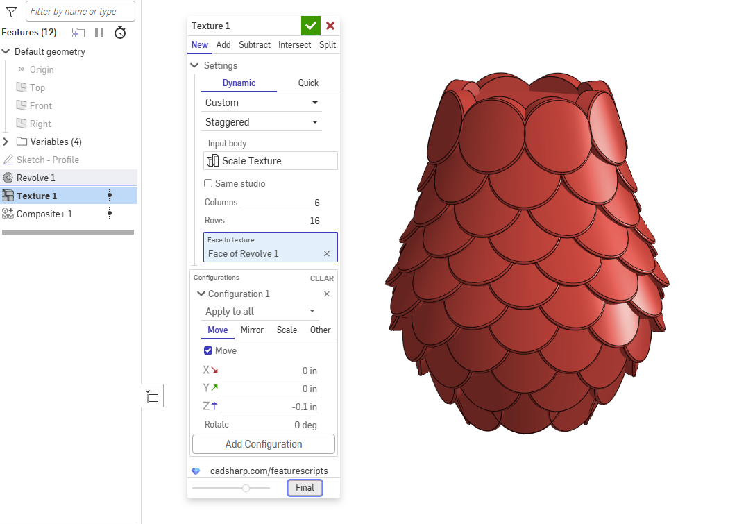

There are a few ways you could do this. One way would be to create a iterating feature pattern or variable feature pattern, but these can be overly complex.
A simpler way would be to use a custom feature like
Texture. Just add it to your toolbar, then use it to pattern your own texture templates. Here is an example of how to do it in relation to your image:

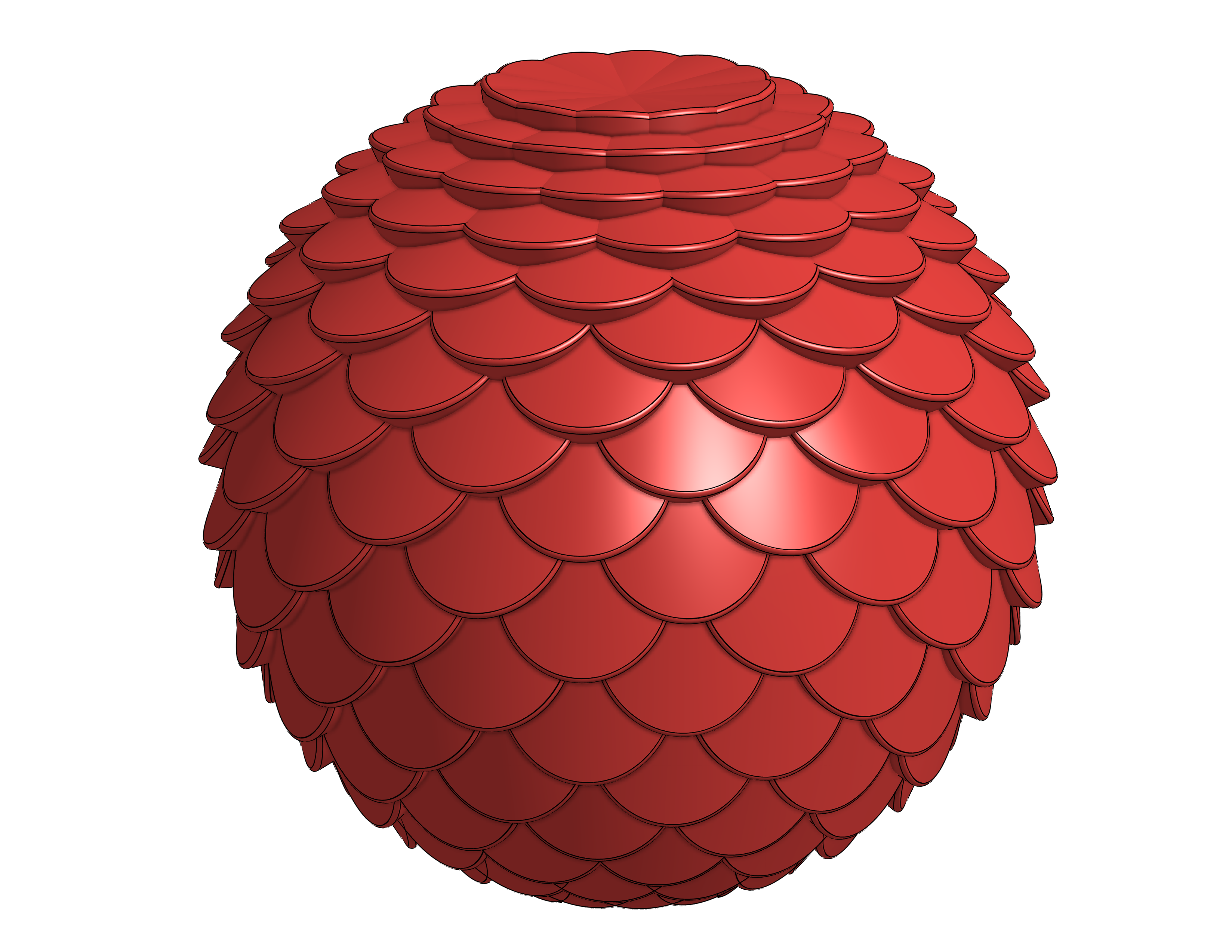

now trying to put it on a half sphere and a full sphere but cant see whats wrong :)
can u help @MichaelPascoe

With the current version of Texture there is a bug when trying to do spheres. If you leave a small region open at the top and bottom, it will work. The new version fixes this issue but isn't complete yet.
Here is an example of how to do it with the current version of Texture:

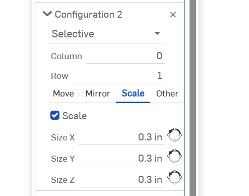

is it possible to get less dots in the bottom so i looks like the top
Not currently with the Texture feature.
You could adjust the width of each of those parts one row at a time like this:

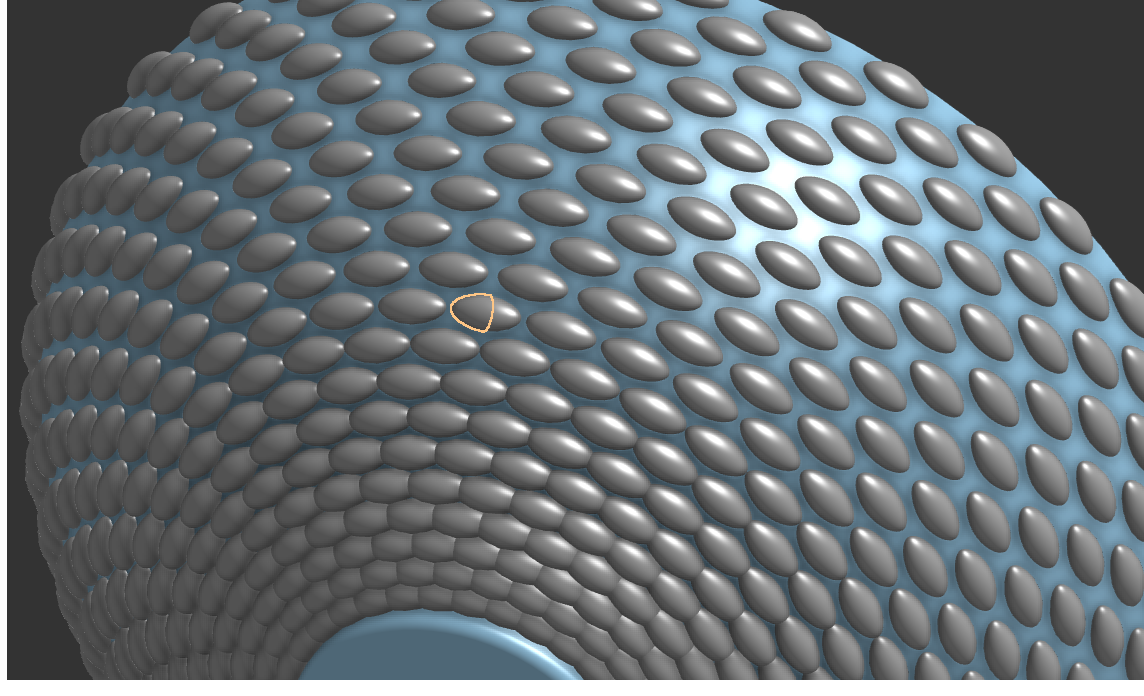

Also you could use @EvanReese's Attractor Pattern feature.

It's been on my backlog for a while to update Attractor Pattern to handle periodic surfaces (ones that form a closed loop), but right now it doesn't do great with them. Otherwise this would be a great use-case.
