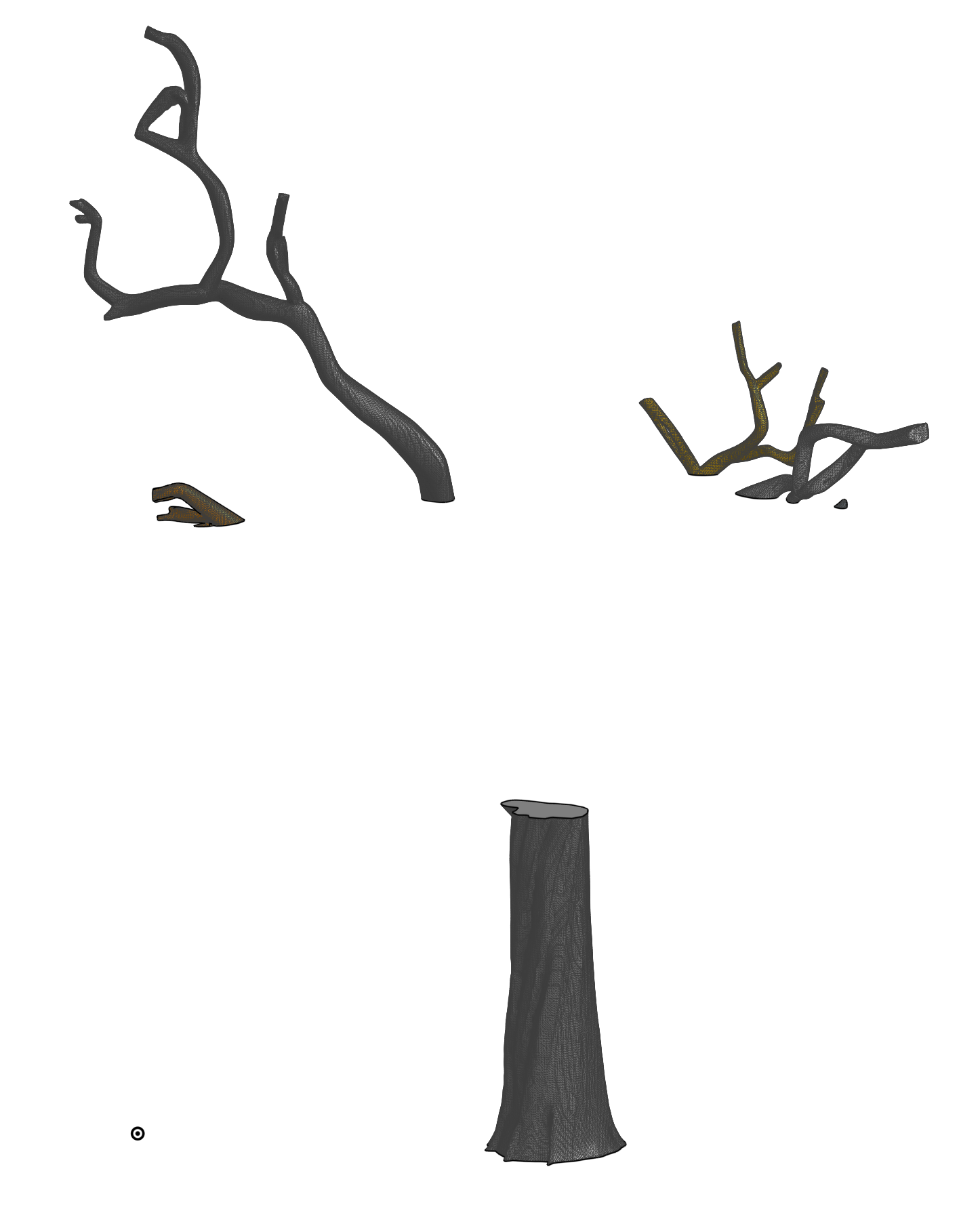

    Here's my project. I made it a public one.
    Tree2D-3D-mesh | Tree skelet
    It's indeed with several problems, and not water tight. How can I solve that?
    Gr, Hans
  • MDesignMDesign Member Posts: 1,286 PRO
    you could do a series of splits/encloses to narrow down the problem area but with a tree that could be a nightmare.
  • Matt_ShieldsMatt_Shields Member, Onshape Employees Posts: 899 PRO
    Yeah, I was able to enclose a few sections, but that thing is going to be a nightmare.

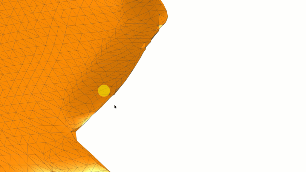

    I checked it. there are no holes. not sure what the issue is. I had another STL last night that was acting the same way. no holes but would not import solid. had to remesh the problem area to get it to work.
    No holes, but lots of non-manifold geometry.
    Ah good catch Matt. That makes sense why it won't work then.
