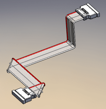

Is there an existing Featurescript out there for folded ribbon cable routes? Or does anyone have a nice workflow?
This is a task that has been quite tedious without 3d sketches. I'm currently using a combination of routing curves, many orthogonal sketches, and a collection of sweeps for the flat bends.

    I would use the sheet metal tools. Then you either need to live with weird transitions where the 45 degree bends are, or you need to create a straight cable and use the bend feature which will make it tricky to line everything up.
    Is your main goal to make sure that you have a reasonably accurate length and pin 1 lines up with pin 1? Do you need perfect flat pattern drawings?

    Thanks Simon, I was hoping for the auto-router from SOLIDWORKS, but seems like this is all being manually done. I'll need to dedicate some time to see if I can replicate it in FS.
    I use sheet metal tools for flat flex and rigid flex, but I limited my thinking to only rectangular cross sections. I can definitely use this for ribbon.

  • armandoRRarmandoRR Member, pcbaevp Posts: 30 PRO
    It's not too bad, but it's definitely an abuse of sheet metal. I do like the use of unfolding the model to get an approximate cable length.
