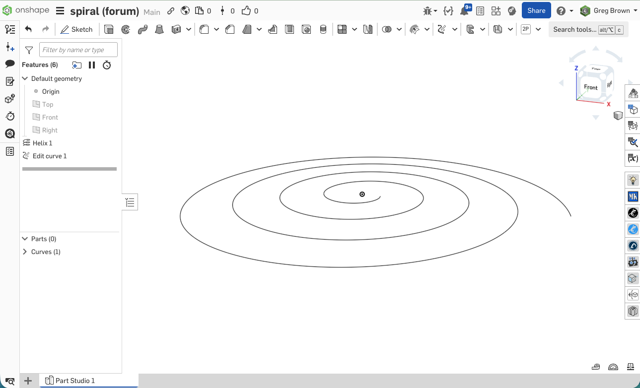

Helix curve then use Edit curve to planarize and reapproximate (smooth)

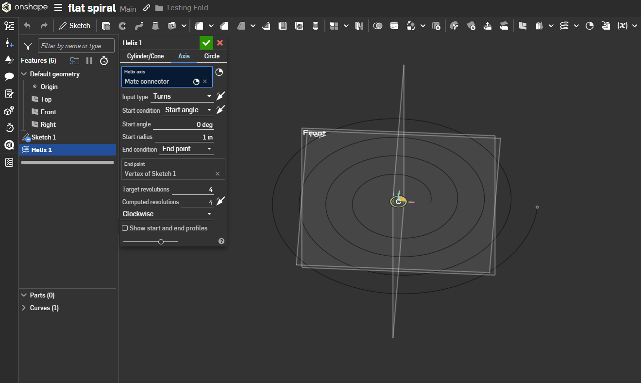

You can actually achieve a flat spiral with the helix tool without needing the edit curve step if you use the axis mode and draw to an end point. I was messing around with opHelix when writing some curve features and it supports flat planar outputs as well as cylindrical / conical outputs. Weirdly though it doesn't support cylindrical AND flat outputs simultaneously (i.e. a flat circular arc output) so I had to write my own 3d circular arc functions to compensate.
