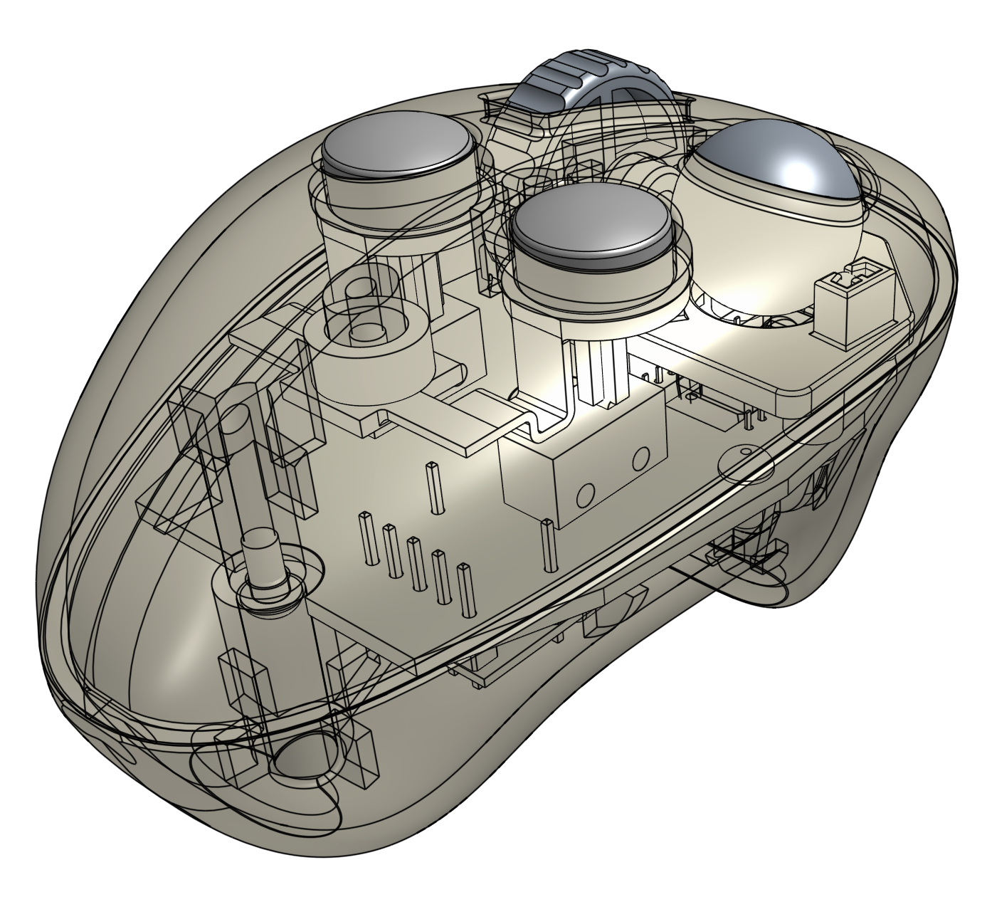

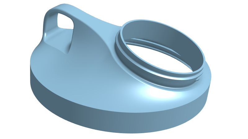

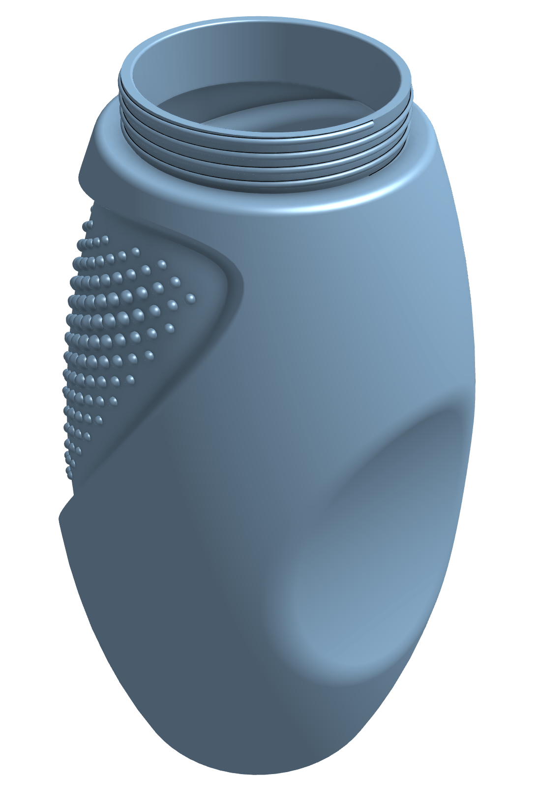

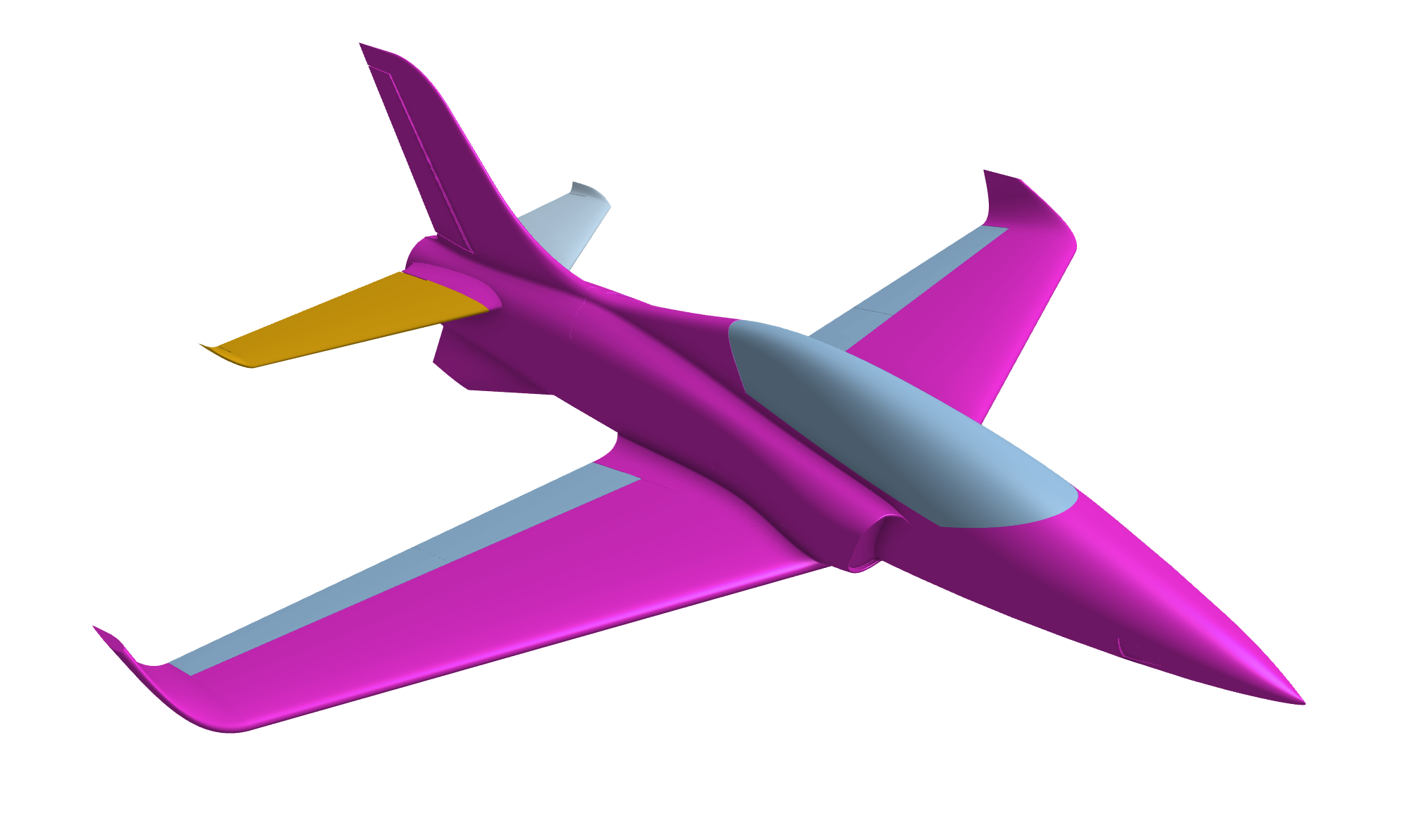

  • Matt_ShieldsMatt_Shields Member, Onshape Employees Posts: 843 PRO
    The short answer is yes. I have seen some amazing examples of complex and robust surface modeling from the Onshape Forums and from Onshape commercial customers. Complex surfaces are defined by curves which are in turn defined by parameters. The underlying math of how the surfaces are formed is complex, but it isn't random.
    There are some good examples in the surfacing courses in the Learning Center.
    Maybe not a laundry detergent bottle, but here is a very cool bottle from Evan Reece.
    I also love this video:
    Other examples:

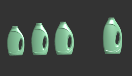

  • euan_dykeseuan_dykes Member Posts: 33 PRO
    Here's a use case that I see great benefit in having robust model. We have this bottle design, and there's like 20 size versions of it. There's also versions that are PP and PE, slight geometric changes to improve mould-ability of each material. I can already see the common design features. E.g. the upper label bumper on the right 3 is almost the same height. The handle is the same size and form for each bottle.
    There's also a level of CAD that is above robust, I call it adaptive. Our suppliers do this, they can deform the surfaces to adapt to how the moulding shrinks. Those front faces might be perfect for labelling in CAD, the bottles that come out can cause issues.
