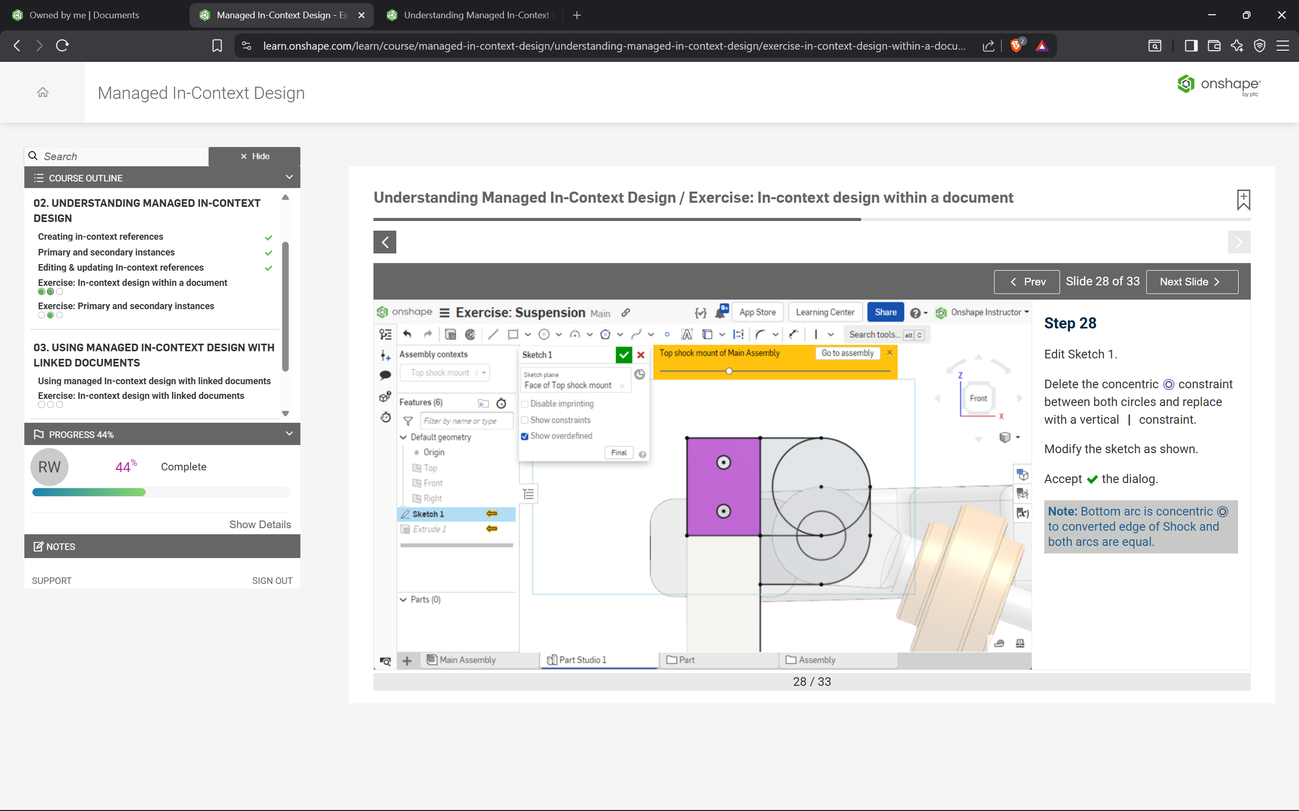

Understanding Managed In-Context Design, In context design within a doc, step 28

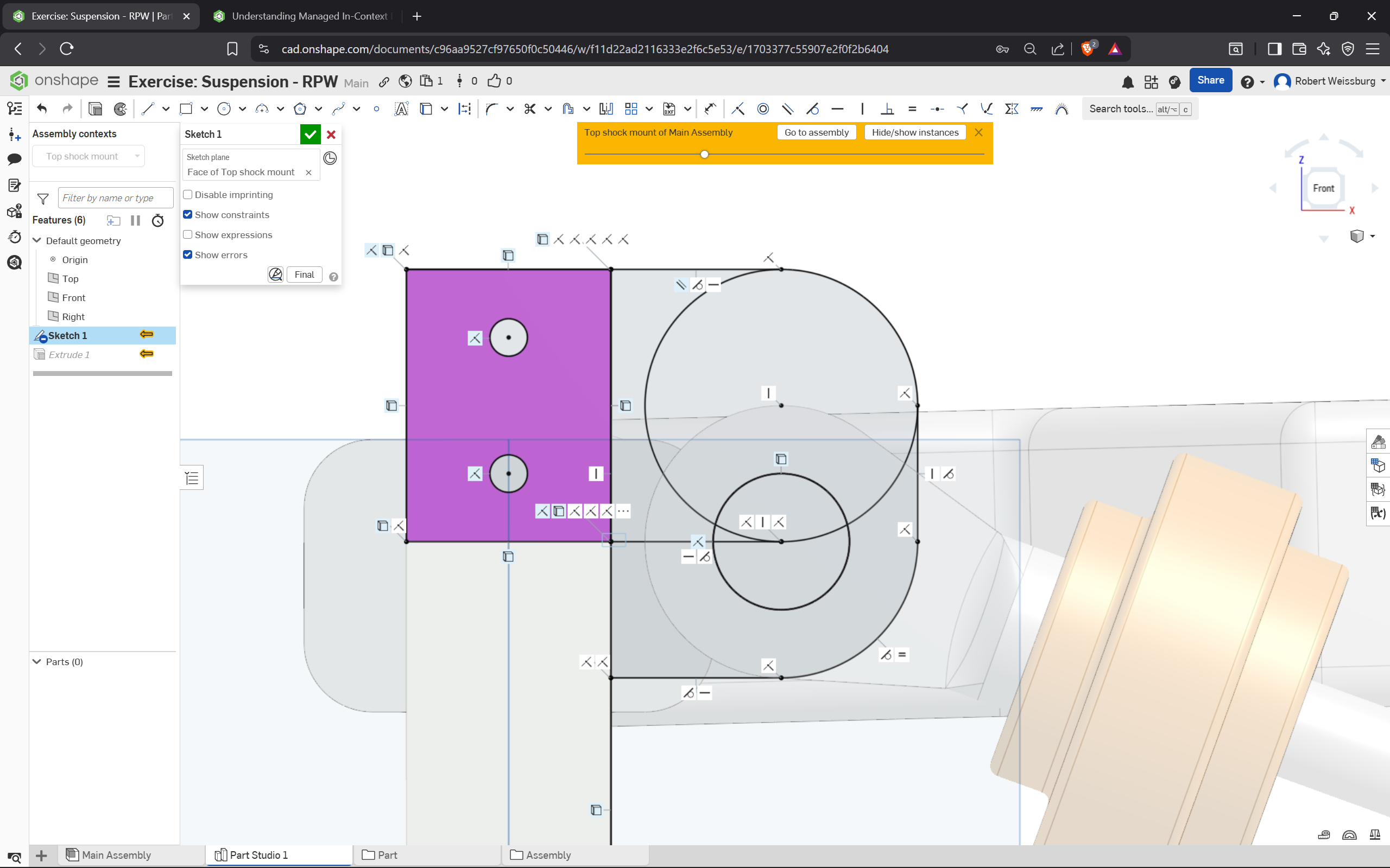

I have to admit (and hate to) that I'm stumped. I have spent 15 hours on this one step on 3 days, but can't get the bracket modification fully defined. All the lines of the sketch are black, but I need to add to dimensions to get that, which aren't present in the slide in the tutorial. The feature still shows not Fully defined. What am I missing? I have done every combination of constraints I can think of without improvement on this.
  • Matt_ShieldsMatt_Shields Member, Onshape Employees Posts: 902 PRO
    The lines might be black, but look carefully for some blue line endpoints. When I did the exercise, I had two endpoints I had to constrain.

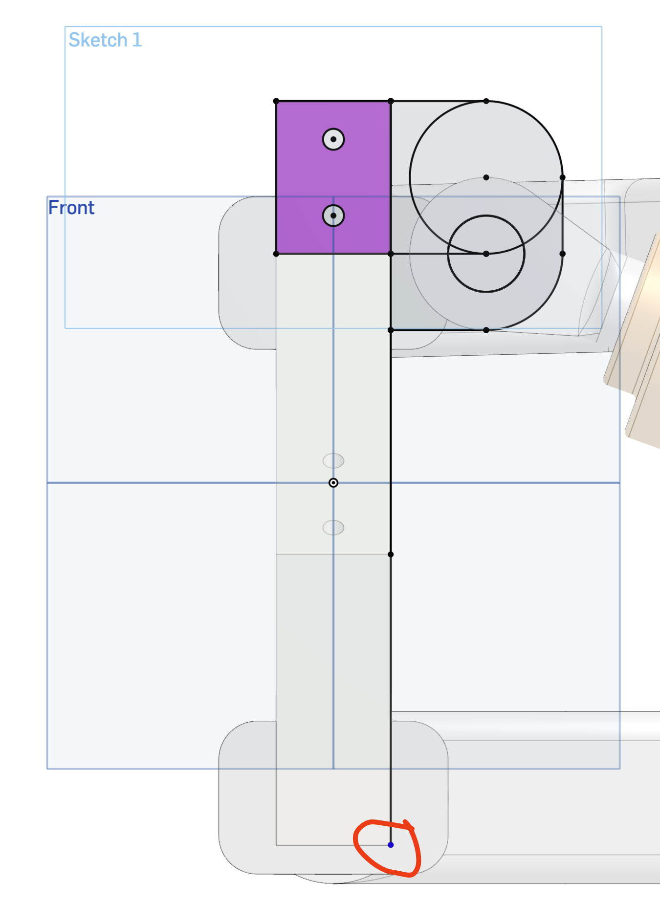

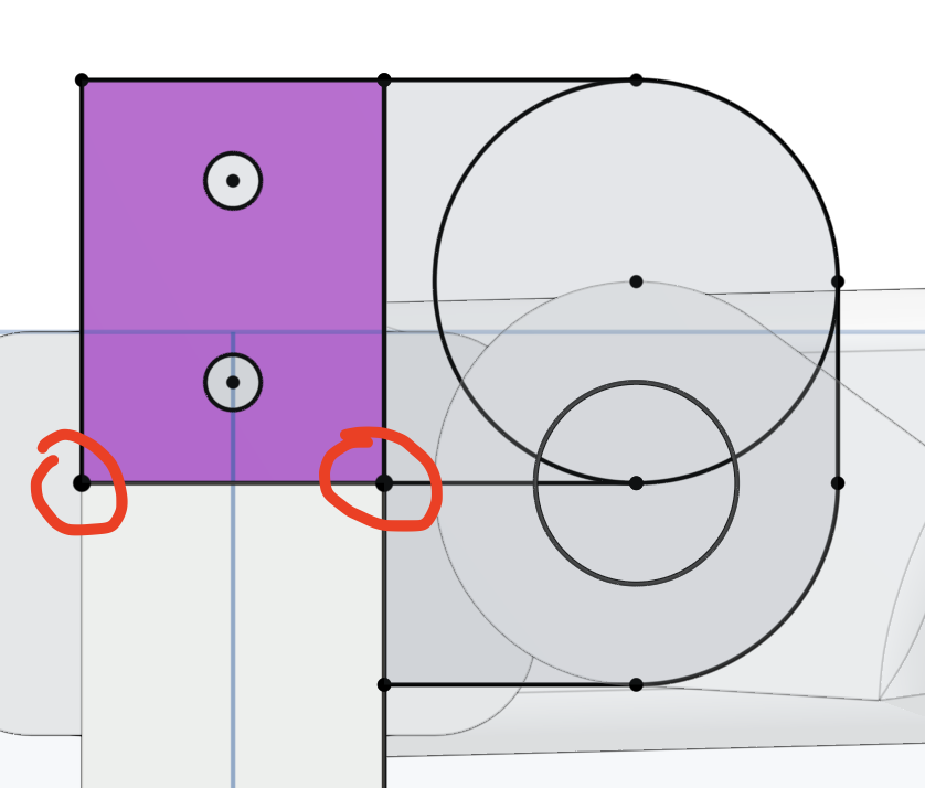

    These all look blue to me. Click and drag them to see what's not defined. Or share your doc.

  • robert_weissburgrobert_weissburg Member Posts: 33
    My doc is public. Don't know how else to share. I wasn't able to move the right and lower points you circled, but I could move the other. I moved the end of the left line to the right a bit and used coincident to attach them together and it couldn't solve, giving this.
    The right and lower points were black and now the right one is blue. Would have been nice if a better contrasting color was used than blue.

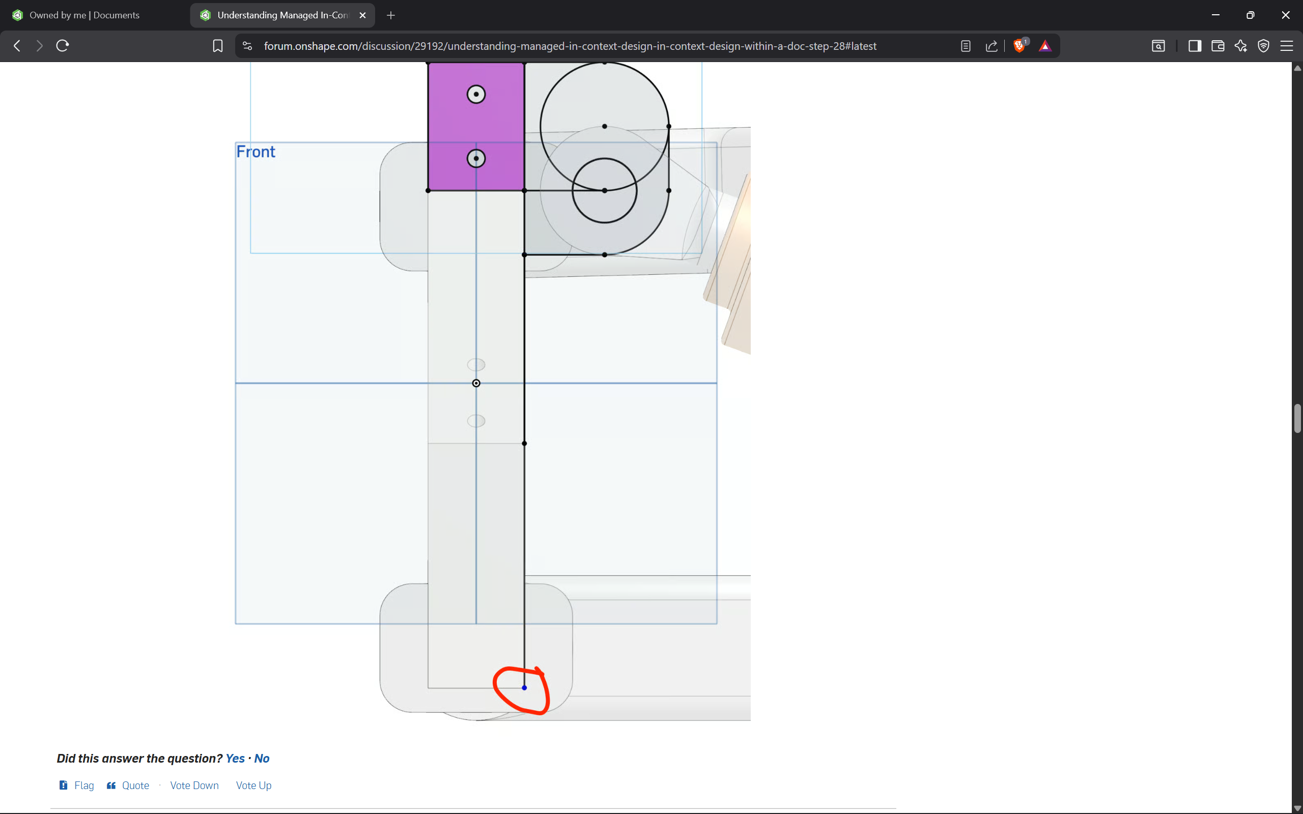

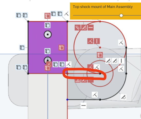

    It's subtle, but the size of these vertices is your clue. There is some underlying unconstrained geometry.
    I played with it for a couple hours and now have this.
    Scroll down :)

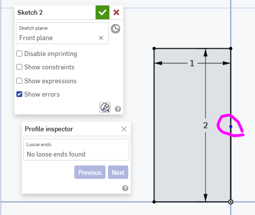

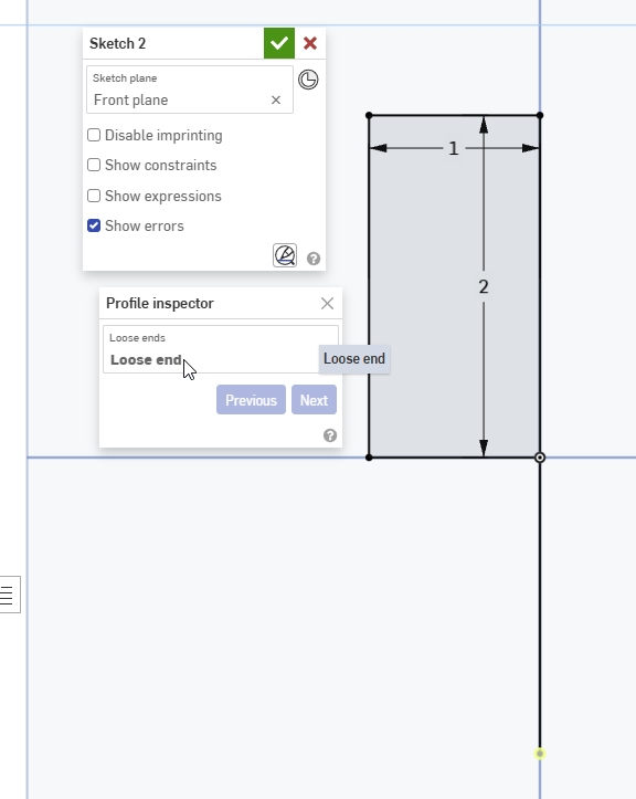

  • eric_pestyeric_pesty Member, pcbaevp Posts: 2,532 PRO
    The "Profile inspector" tool is made to find these… I just wish it highlighted points that are "on an edge" as well:
    It finds these:
    But not these:
    Or alternatively a filter option in the constraint manager for "under constrained"
    The Profile Inspector. I've done many of the tutorials (2 dozen?) and no mention of this yet. I was trying to find such a tool.

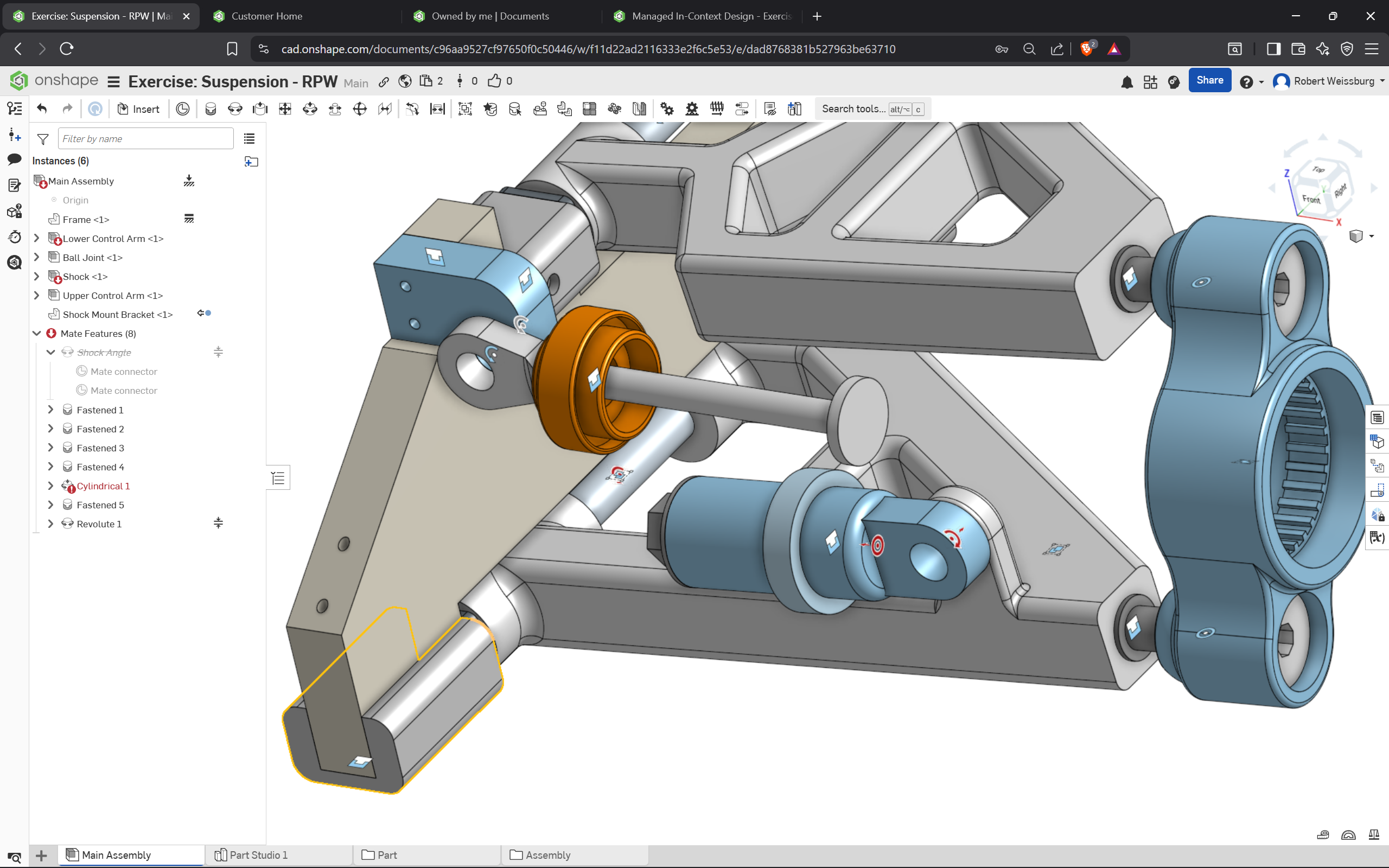

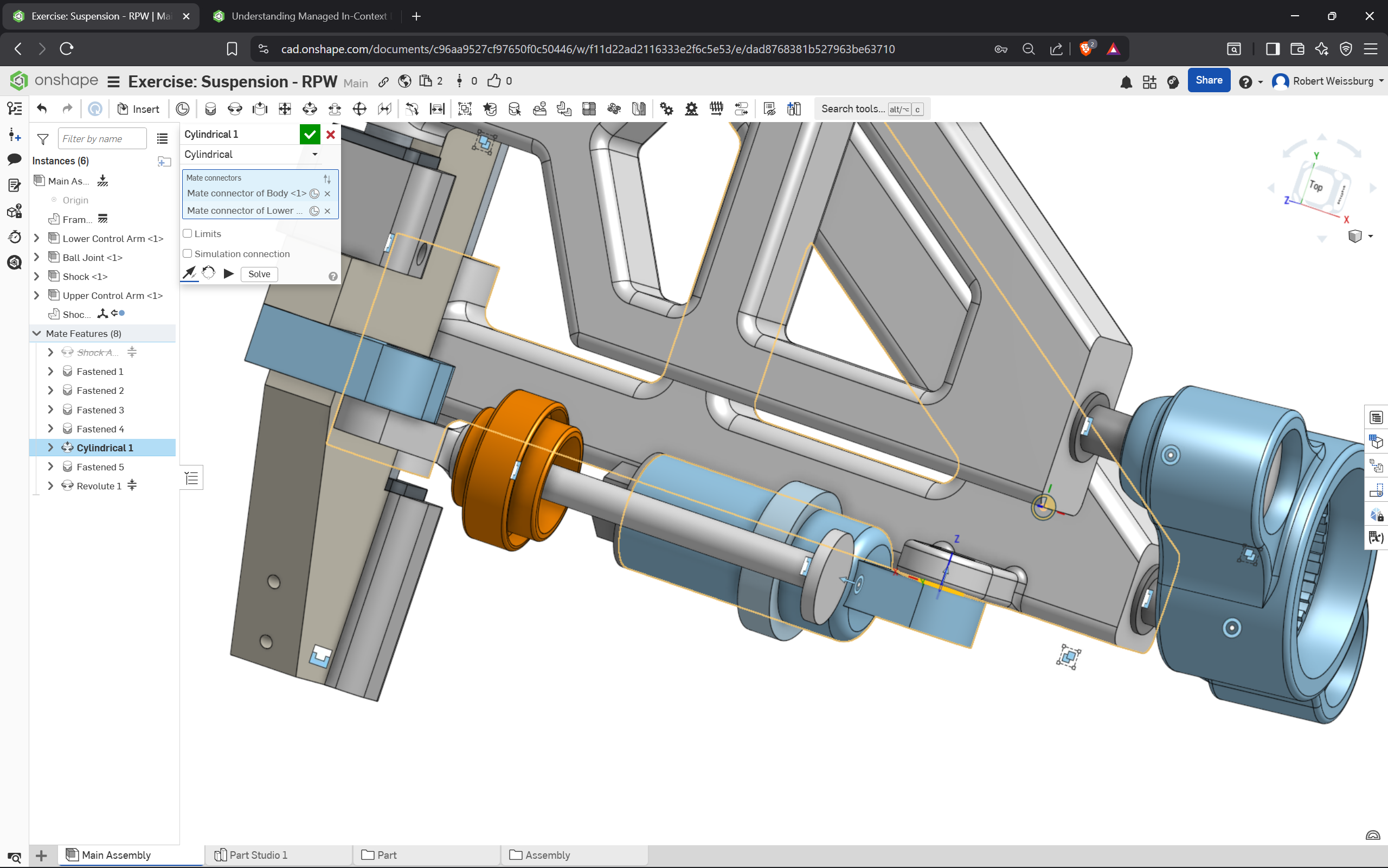

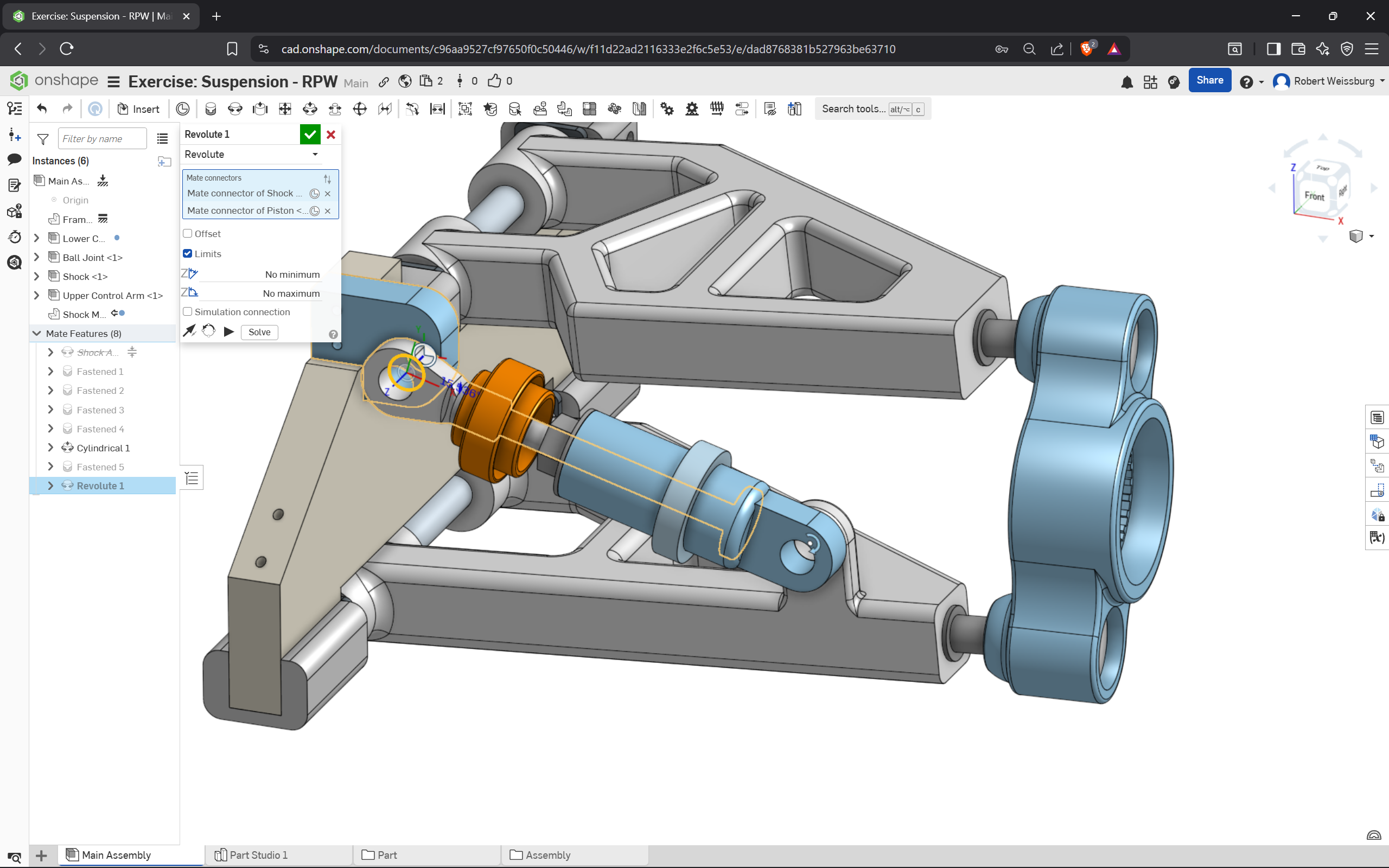

    Well, I didn't get far before getting stumped again. I assume this must be a result of an earlier error of some kind, probably in the context bit, though everything I did gave the result expected. on doing step 32, I have an error on Cylindrical1 mate, saying it is over-defining the assembly. I see two other mates not part of the exercise that are red associated with the lower shock and pivot axle. I can't figure out what is the problem.
    The assembly moved as expected on the previous step, before setting the limits in step 32. This happened then.

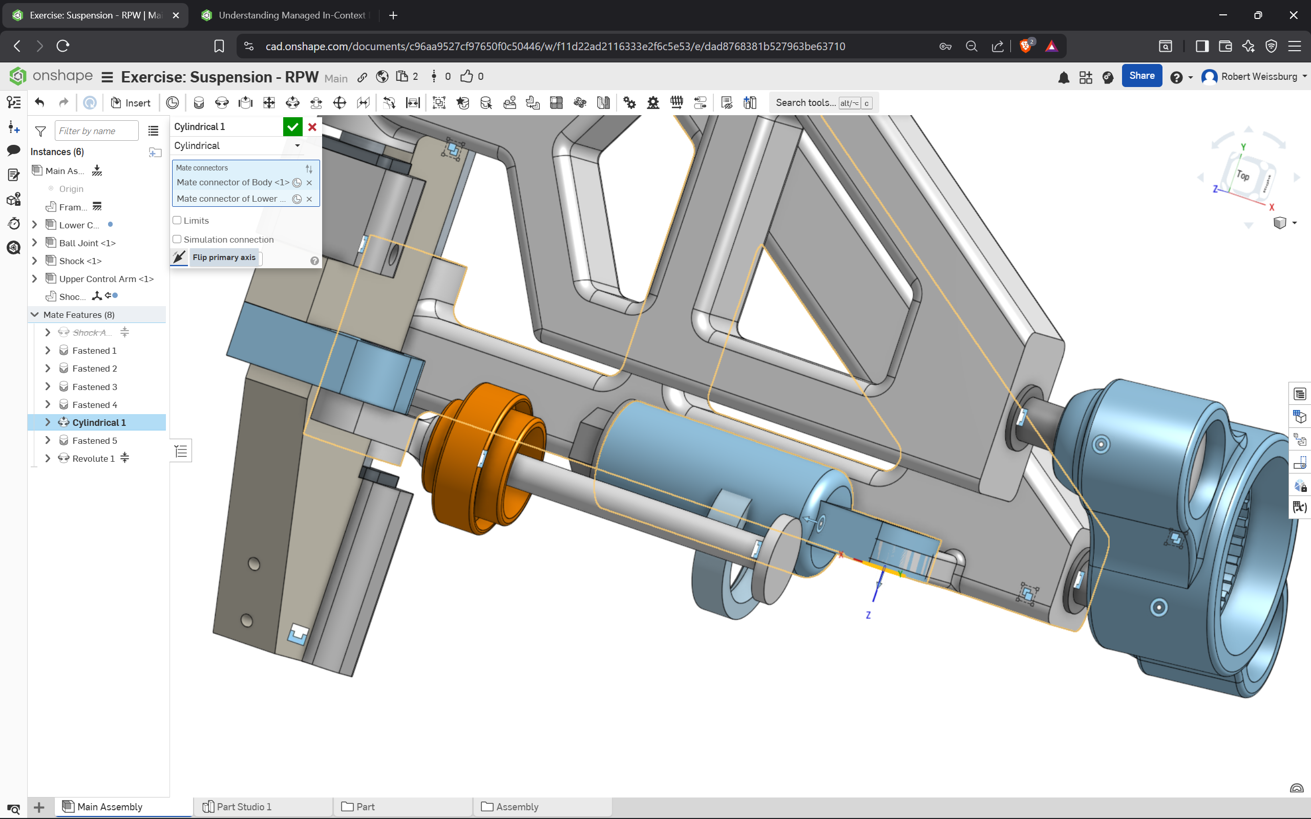

    Yikes. Maybe flip the primary axis on the Cylindrical mate?
    That just puts the shock mount point inside the mount bracket.
    before
    after flip.
    Somehow the shock has lost its selfness. I would have thought there would be a mate of the piston face to the bottom of the cylinder, but I don't see a mate for that. Although, I don't see how doing that would change the definedness (new word!) of the Cylindrical1 mate.
    Mind you, if I delete the limits in Revolute1 (min and max are set to 0 deg in the exercise). The shock goes back together and it looks like it should. I don't understand what that 0 deg was supposed to accomplish, but as soon as that is added, the shock comes apart and the overdefined error appears.

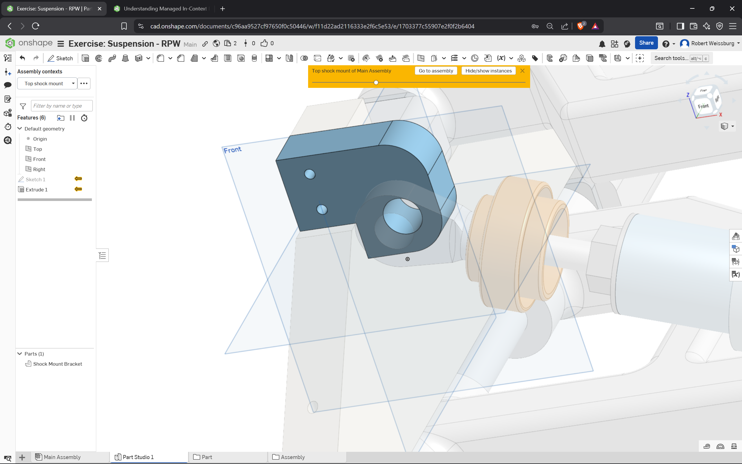

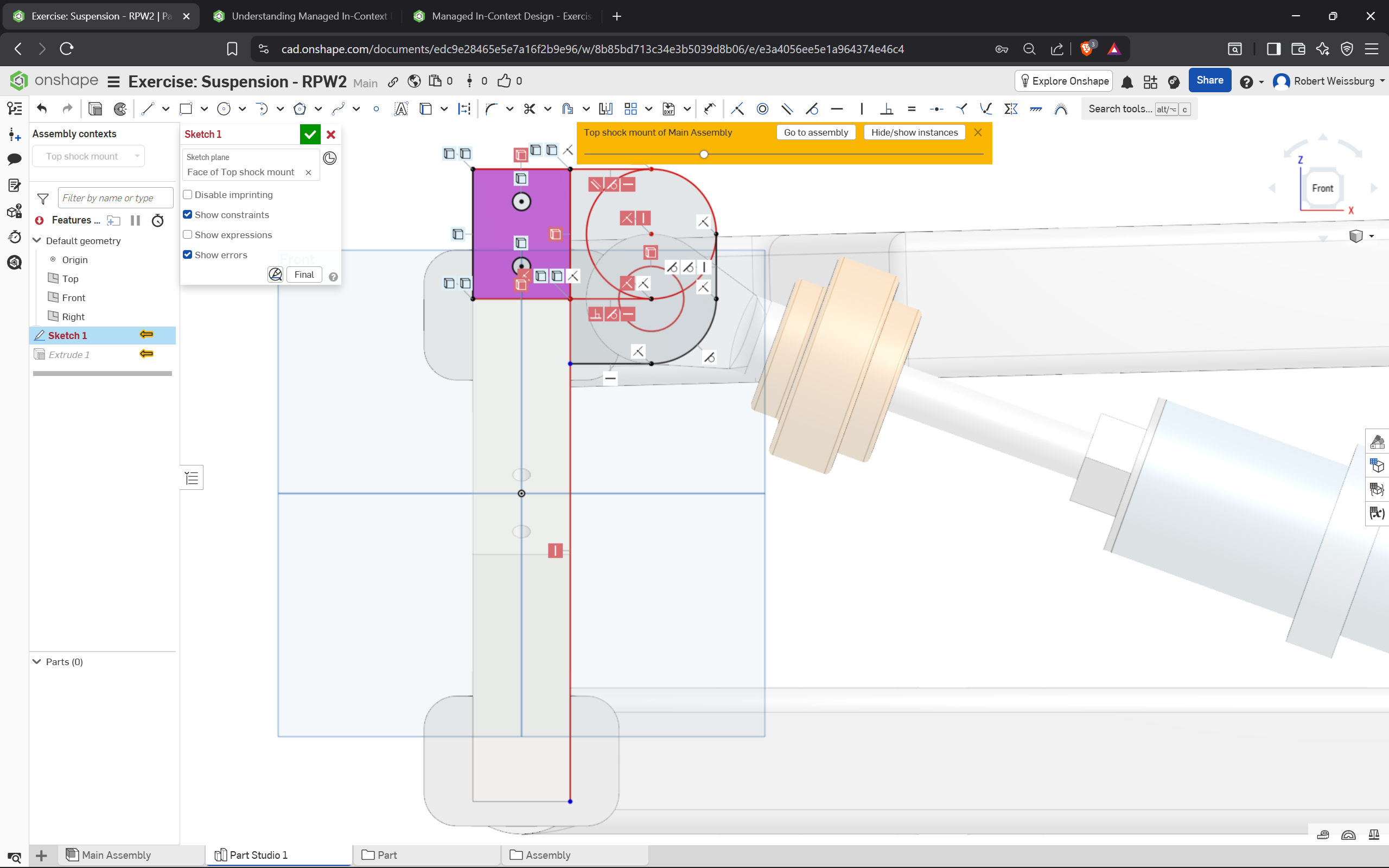

    I decided to start over on this tutorial and I have gotten stuck again at step 28, but in a different way. The sketch is complete, except that I can't draw that long vertical line on the right side of part that the new mount is attached to. In the previous attempt it was possible to make the lower end of the line coincident with the bottom line's right end point, but this time that is not possible. I've spent 4 hours trying to figure out why, but don't see what the difference could be. I don't really understand why it worked before, as the corner of this part isn't even in the same plane as the sketch and it hasn't been made a reference with the context feature, but it was simple before. Very frustrating. It looks fine below, but there is a gap at the lower point.
    https://cad.onshape.com/documents/edc9e28465e5e7a16f2b9e96/w/8b85bd713c34e3b5039d8b06/e/e3a4056ee5e1a964374e46c4?renderMode=0&uiState=6930f4d35d73ad86aa118d1e
    I think starting over was the right call. In this sketch, I can see a line in the middle that I don't think is supposed to be there.
    That line is there in the tutorial drawing. It does seem like all you need in the periphery and the whole. I still don't get why I can't select the bottom point for the long line, like you showed me to do last time and I could just click on the corner and the end of my line and it connected. Now it won't connect to that corner.

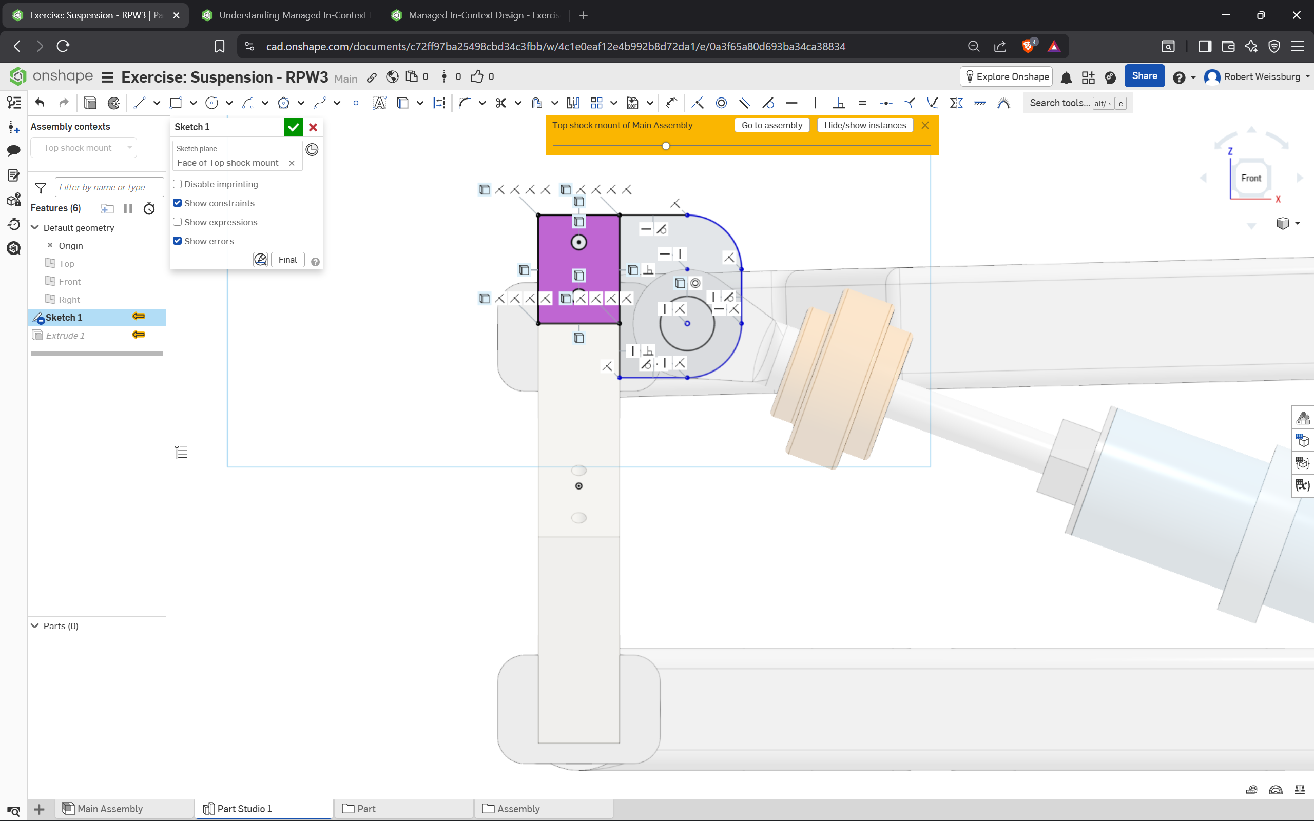

    I have done the whole tutorial now a third time and am stuck here. I still can't select the any points on the stucture that the mount that's being drawn in attached to, as Matt had me do in my first attempt. The points highlight if I hover over them when no tool is selected, but if I have the line too selected (or any tool) when I hover over them, nothing happens, so I can't draw, or make a line end coincident with the corner. There are no gaps and the curves are tangent. Can't figure out why this is not fully defined, except for that.
    https://cad.onshape.com/documents/c72ff97ba25498cbd34c3fbb/w/4c1e0eaf12e4b992b8d72da1/e/0a3f65a80d693ba34ca38834?renderMode=0&uiState=693cbe289ca0f2da58693027
    This is the view from my first attempt, where Matt told me to extend the line shown to that lower point. This is the point (or the one at the corner above it) that don't highlight now, when hovered over. What would affect this behavior? These points just stay grayed out now, when I hover over them, if the line tool is selected.
