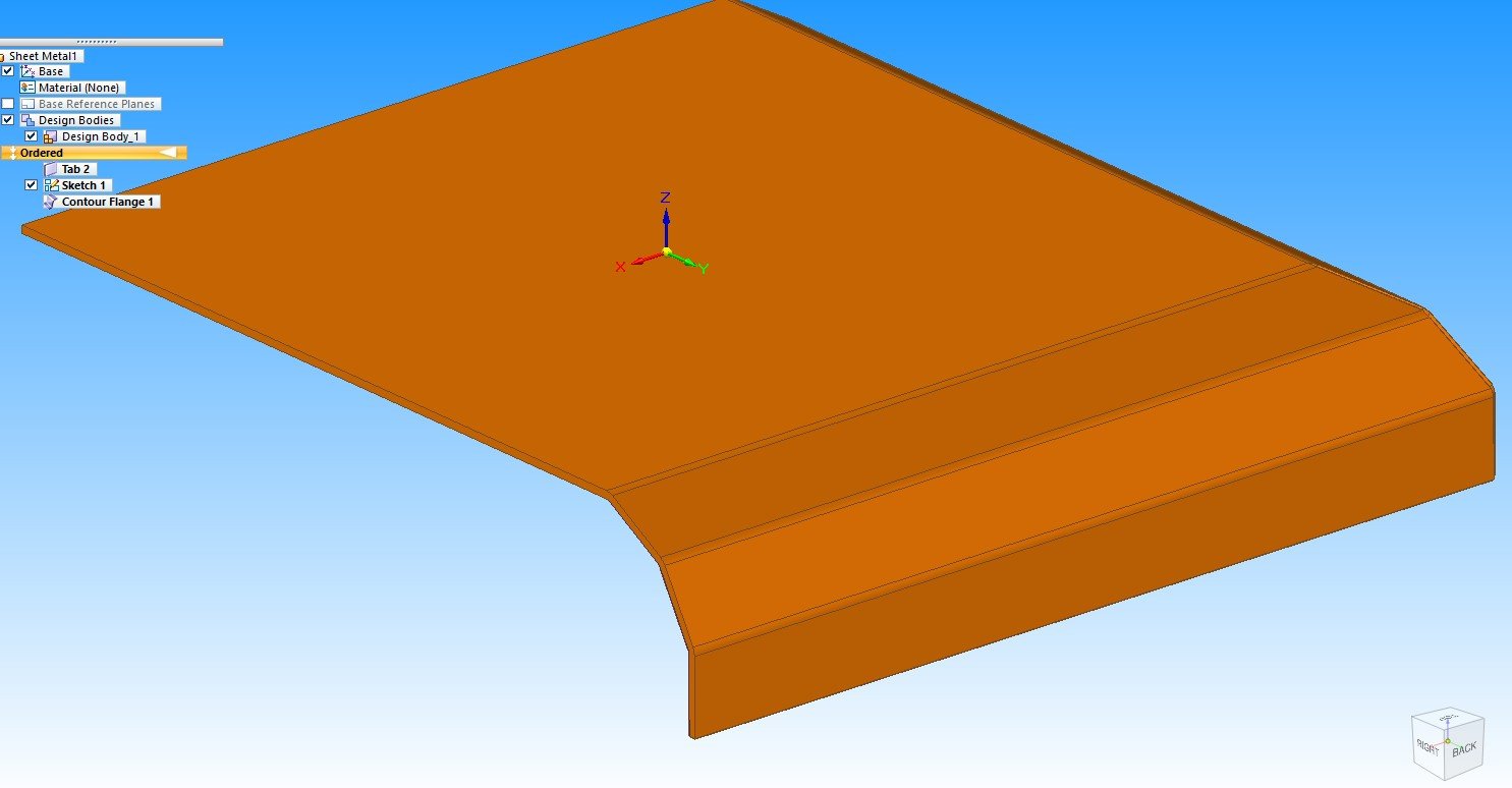

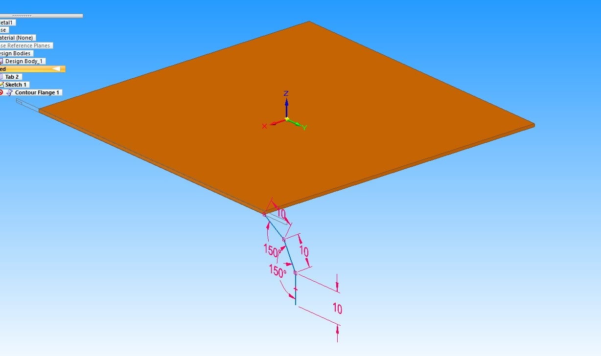

Contour Flange in SE allows me to quickly turn this sketch:
into this:

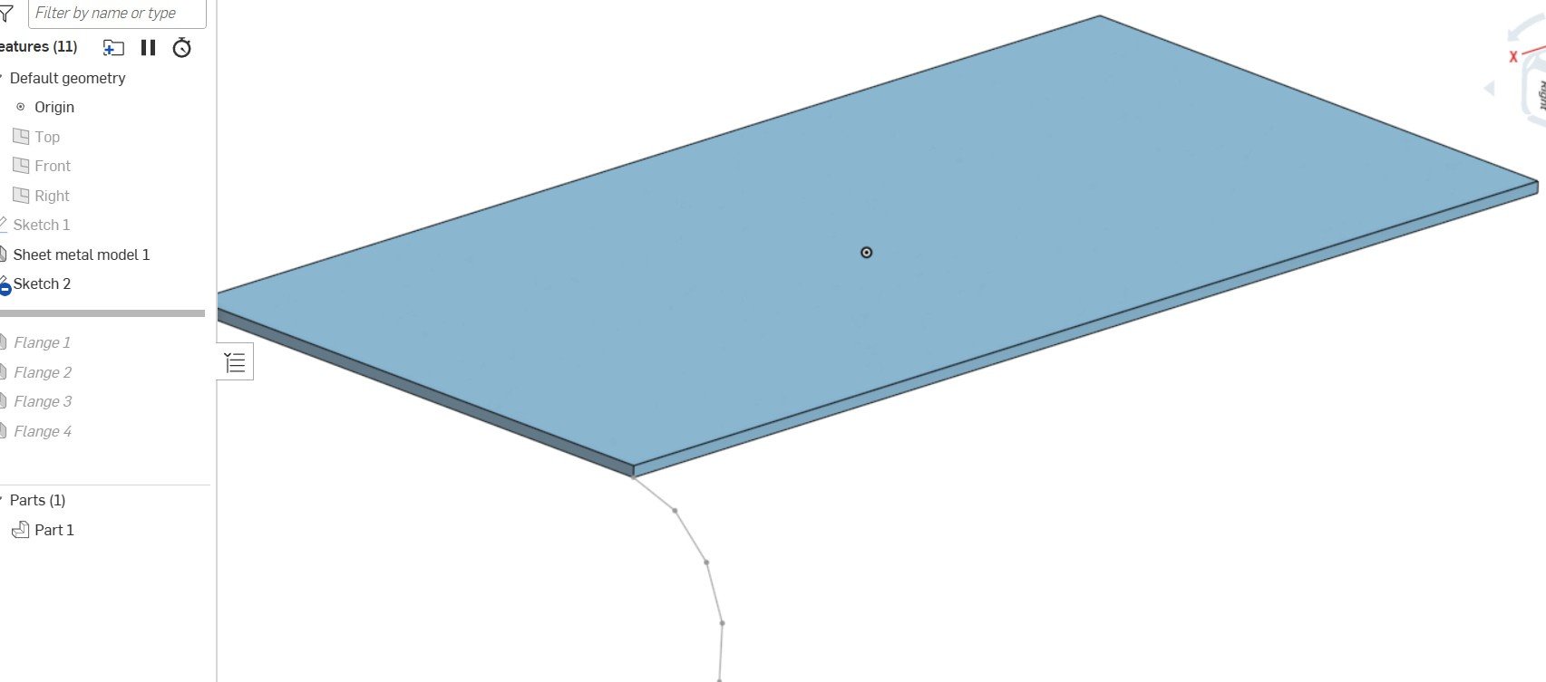

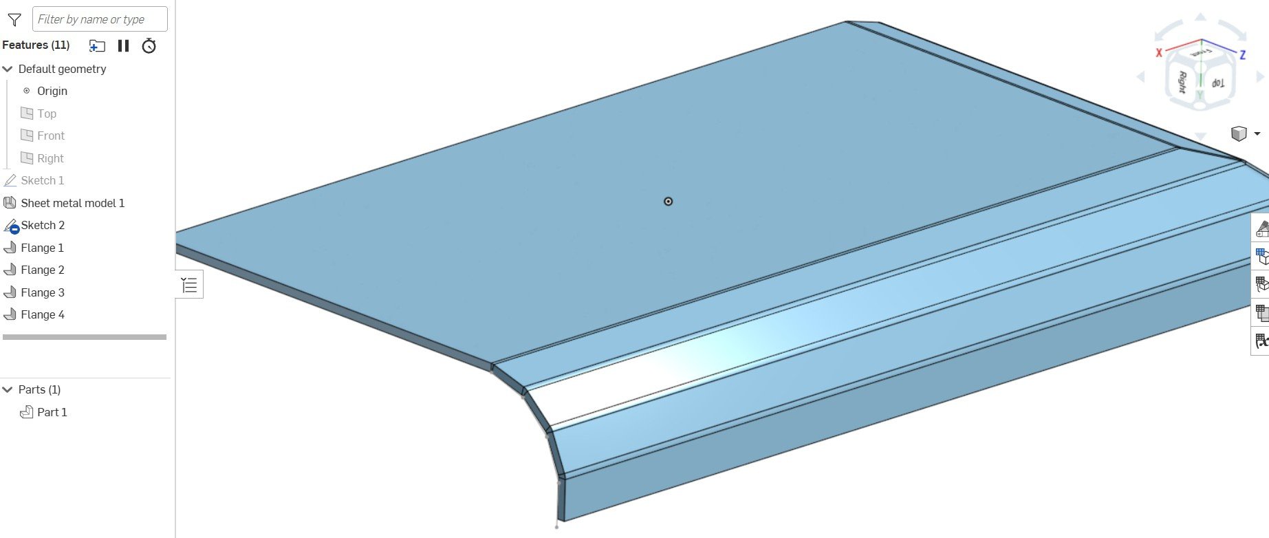

In Onshape I need to do something like this:
and build up the bends one at a time to look like this:
But that is cumbersome when I want to quickly convert sketch geometry into a few flanges.

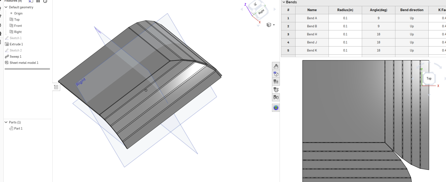

    Here an example of how that works:
    And this is taking it "to the extreme":

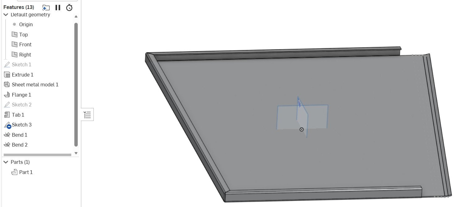

    To illustrate, this is the simple part where I started to scratch my head:
    The part is basically converted to sheetmetal from a model. But I'm not sure I could have converted to curled bit on the RHS even if I had predicted it.
    Thanks for the feedback. Gordon
  • gordon_ross588gordon_ross588 Member Posts: 6
    Hello Martin. Thanks for the reply.
    In general I start my parts with a converted model, like the simple part above. As the design evolves though it is necessary to add flanges and other details. It's the curled edge on the RHS when I started scratching my head. In my Solid Edge/Solidworks brain this is a very simple thing (as shown in original post). I have also tried to create another adjacent part and booleaning them together which works, but the result doesn't flatten successfully.
    Thanks for your help.

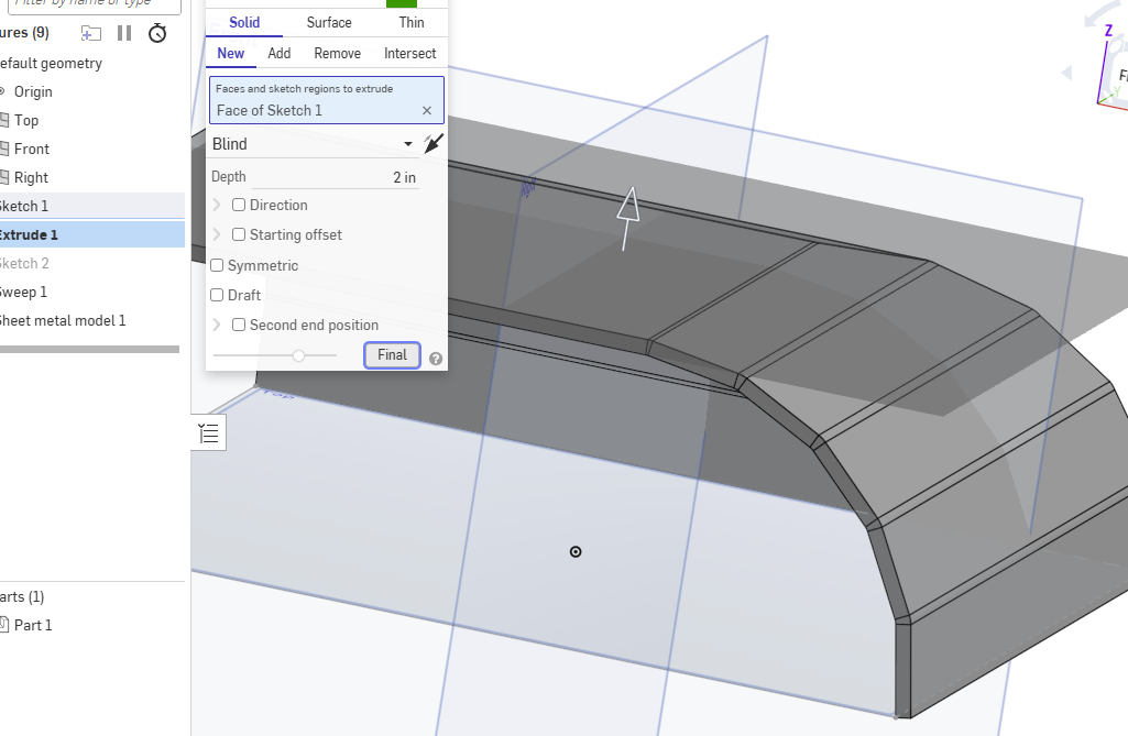

  • glen_dewsburyglen_dewsbury Member Posts: 1,181 PRO
    This works as convert solid to sheet metal. This is robust enough to allow change depth of extrude or the initial length and width in sketch 1.
    https://cad.onshape.com/documents/9a16e90e97ff0f49350854fe/w/8b1147e1bb96ce49e97d63d0/e/3e88da18014ccf9f76230d64
