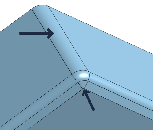

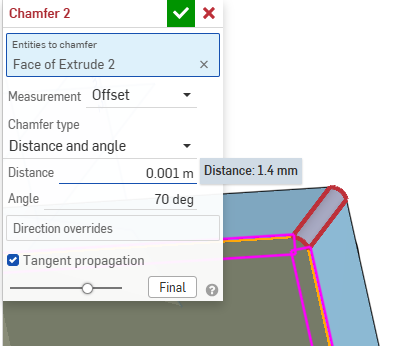

I have reverse-engineered a part that I'd like to 3D print. To make it look somewhat like the original, I want to have a fairly large (10mm radius) fillet on the edges of the bottom. The bottom will also be on the print bed. However, most FDM 3D printers cannot handle overhangs of more than 70 to 80 degrees. Therefore, I would like the bottom part of the fillet to be a 70 degree chamfer, until the angle of the fillet becomes less than 70 degrees and it can continue as a fillet.
I managed to get this partially working, but only with a tiny chamfer and tiny fillet:
Knittax S Parts | Sides
How can I do this in a nice way with the large fillet? Thanks!

    You mean like this? Order of operations matter.

    not sure what exactly you aren’t able to do but you can apply a fillet to a chamfer edge if that’s what your after
  • martin_kopplowmartin_kopplow Member Posts: 1,198 PRO
    He doesn't want the fillet to end tangent with the base face (printbed). Instead he wants a small chamfer-like face to extent tangentially from the fillet at say 70° or whatever overhang angle his printer can do.

    The issue is the main corner radius of 3mm. You need to make it much bigger if you want a larger chamfer and/or fillet to be able to wrap around it.

    Precisely! In the part I linked, I have done precisely as suggested above, namely first created a 70-degree chamfer and then applied the fillet to the top edge of that. This works in the sense that I could now print it. But I would like to have a nice big round-over (like a 10 mm radius big) and the chamfer doesn't generate if I make it bigger than 1mm:
    So I guess my question is: how can I make this chamfer (arbitrarily) large(r) so I can whack on a 10mm fillet on the top edge 😊

    You can change the units to mm instead of m. It will be much easier on your eyes and brain when inputting numbers.
    The first sketch is WAY too complicated. At minimum, all the radii and dogbone corners should have been added separately. A basic outer shape, with a later shell, would have probably been the better way of approaching this shape.
    Your rounds are set to conic. IDK if you intended that, but usually that's not needed unless you are designing an iPhone corner.
  • no_thanks454no_thanks454 Member Posts: 7
    Yeah! That looks pretty much like what I'd want! How did you achieve that?
  • MDesignMDesign Member Posts: 1,288 PRO
    get rid of your corner fillets in your sketch. Start with square corners and follow the gif
    edited November 2025
    I should note this isn't quite perfect but.it is the easiest and closest with out fussing with where the big fillet precisely fall in the cross section of the part. (I.e. the fillet is not tangent with the large flat surface. It's tangent to the chamfer)
