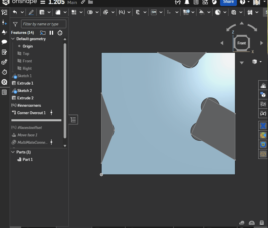

chamfer / fillet for inside undercut corner.?
see picture. the corner is 45*. i want to undercut, like the black line.
like chamfer or filet but inside for inside corners.
i know i can probably use the arc or circle tool but with a part with ALOT of inside corners this will be a huge job.
any suggestions?

    I think the corner overcut FS might be able to do the job?
    https://cad.onshape.com/documents/b99915c0b73924ca981bc57f/v/615cb6d9633a595a6bc99f8a/e/14458d1263a98640a0cf663c
  • GregBrownGregBrown Member, Onshape Employees, csevp, pcbaevp Posts: 370 image
    +1 to Eric's answer. Also, if you have lots of edges to select, then a Query variable will likely be your best friend…

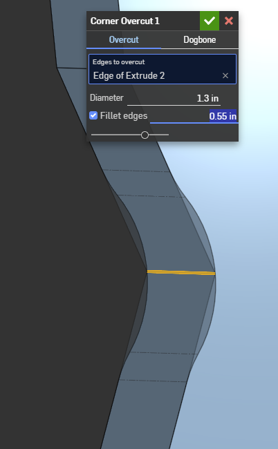

  • Derek_Van_Allen_BDDerek_Van_Allen_BD Member Posts: 591 PRO
    On that subject, I'll plug @hendrik_kueck's powerhouse of a CNC Overcuts feature that does the edge grabbing automagically and picks the logical CNC direction for each part you select.

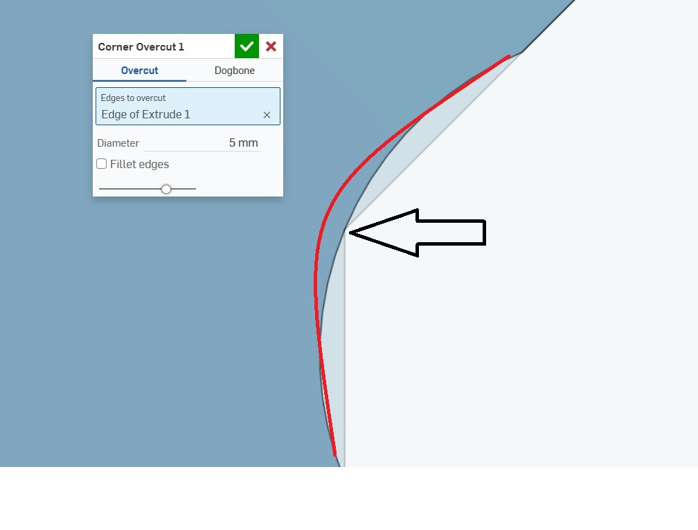

  • michael_valbergmichael_valberg Member Posts: 7
    very nice tools, very nice suggestion thank you so much, BUT
    its probably m taht can*t use this tool probably but the corner is still there…

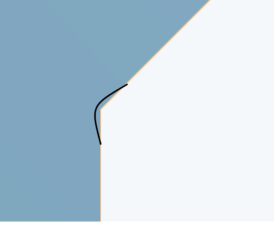

    i want the corner to look more liek the red line.

  • eric_pestyeric_pesty Member, pcbaevp Posts: 2,502 PRO
    The tool is meant to remove enough material so that another part with a "sharp" corner would fit.
    If you want more room, you can just add a "move face" feature after to add some clearance. If you have lots of edges, you can automate the selection with query variables:
    perfect solution! thank you so much, =)
