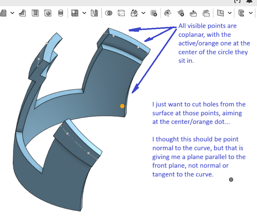

It's not actually a ball, but I believe this is the same problem. I'm just trying to drill straight into a curve, and/or to make a plane tangent to the curve in the process. None of the plane types seem to work. (Selecting the curve and a point on it just stays red for "Tangent Plane". Point Normal comes out unrelated to the curve… It ends up parallel to the front plane for some reason. Curve Point plane is the closest I've gotten. Curve Point at least gives a result that is related to all of the input geometry, and I may be able to get there with further drawings and planes from that. But there muse be an easier way, no?
Thanks for any tips.

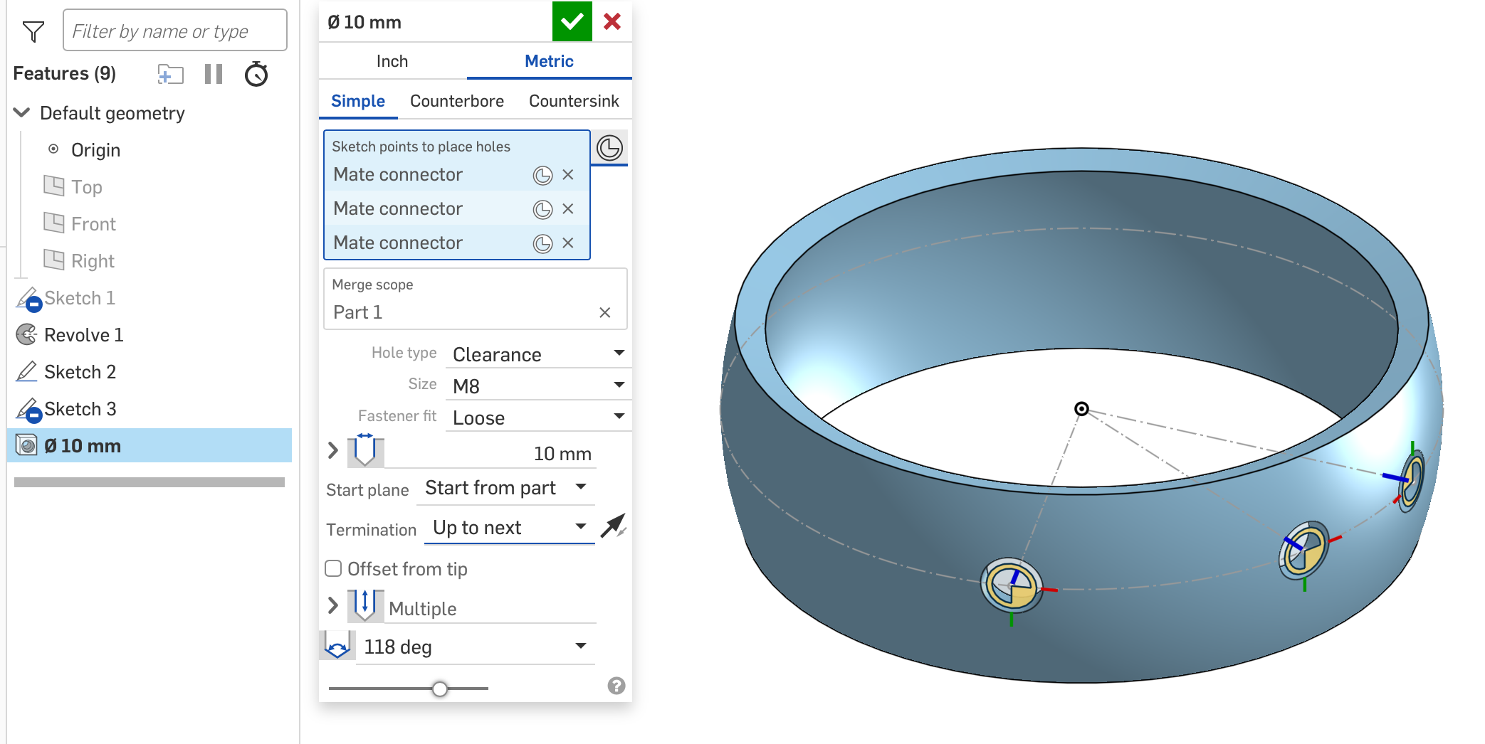

One quick solution: add lines from the points to the center. Then you can easily create a hole feature using a mate connector on the end of the line.
https://cad.onshape.com/documents/e7c5e0b836ec95210e8786f5/w/750ad5b90a511153db1d7333/e/1316d4a2fa31c143fc66d64e

since they're all coplanar, wouldn't it be better to just cut one hole, and use a circular pattern (axis at the orange point) for the second in the same protrusion, and then another circular feature pattern to copy those holes to the other protrusions?
