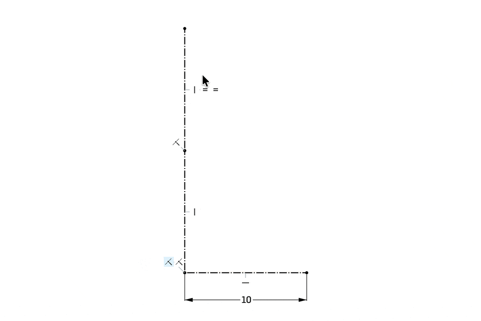

    Any idea if this is going to be addressed? It seems a bit crazy to me that I have to create a variable external to the sketch. Often I will just want to make another dimension half of the referenced one (for example). I would not want the referenced dimension to have a representative variable cluttering up the variables table, which I would generally reserve for significant parameters. I've not used a CAD program that does not allow other dimensions to be referenced within the sketch.
  • S1monS1mon Member Posts: 4,054 PRO
    For something as simple as one dimension being half another, I just use construction lines as necessary and set them to be equal.
