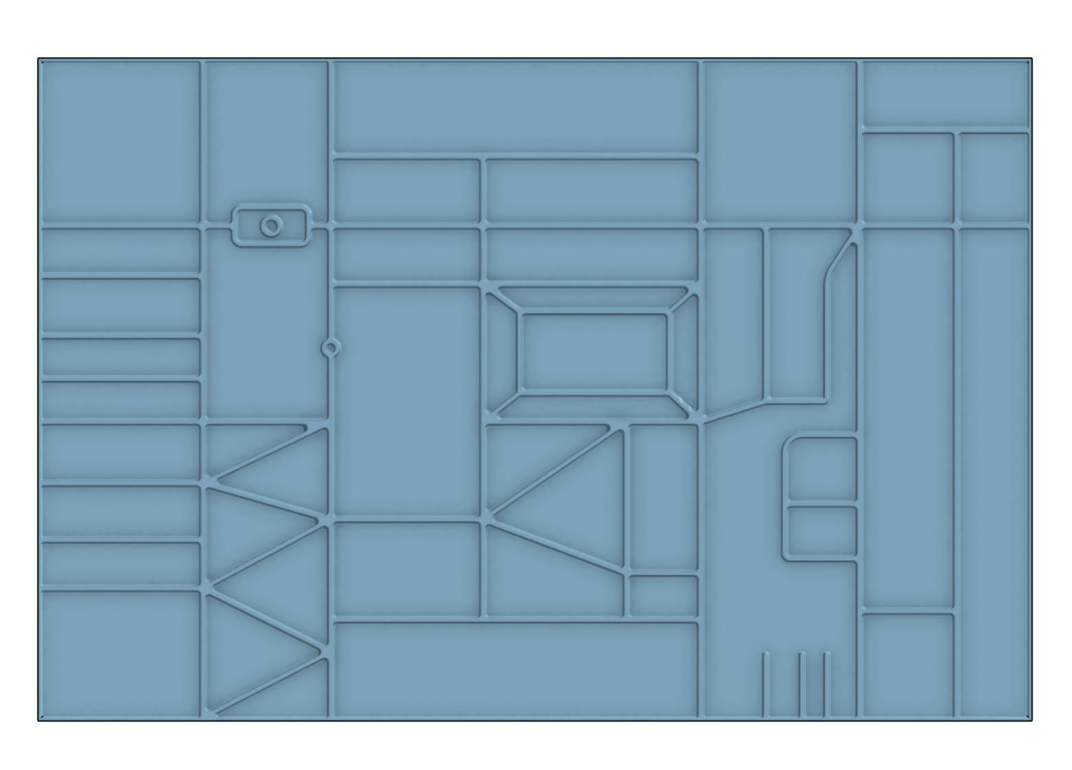

This custom feature creates a network of planar ribs based on one or more sketches with full control of draft and fillets. It's actually a few years old, but I've dusted it off, fixed a ton of bugs and published it. Enjoy!
https://cad.onshape.com/documents/67de1cda4399707a3649fcdf
This was created from one sketch:
