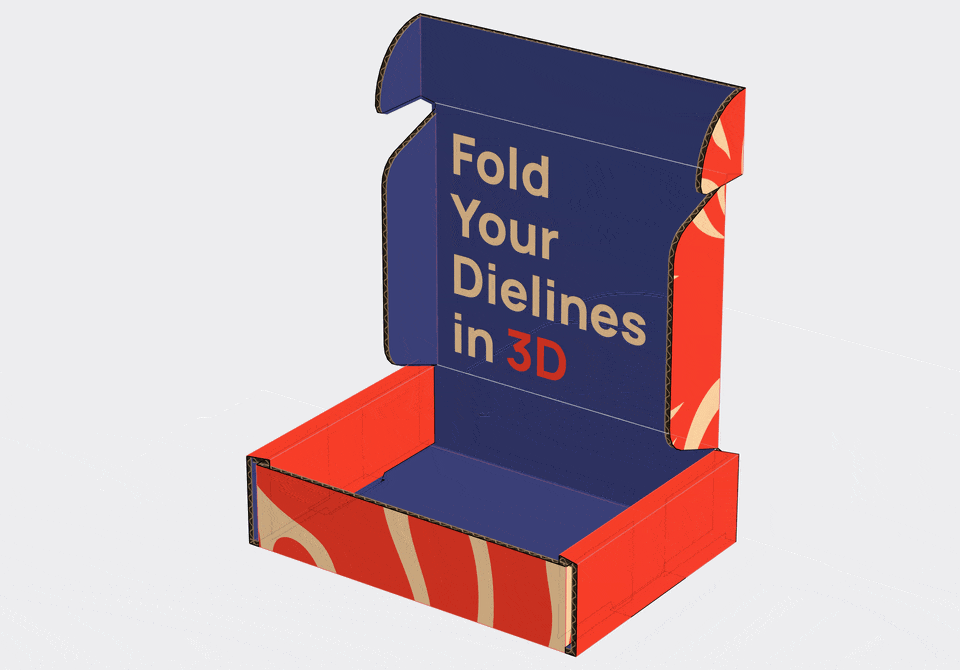

  • S1monS1mon Member Posts: 3,891 PRO
    There's a new third party SaaS CAD tool in development which can show folds step by step. It's aimed at packaging development, but it seems like it could work for many sheet metal models as well.
    https://packcad.com
    https://app.packcad.com/mockup/
