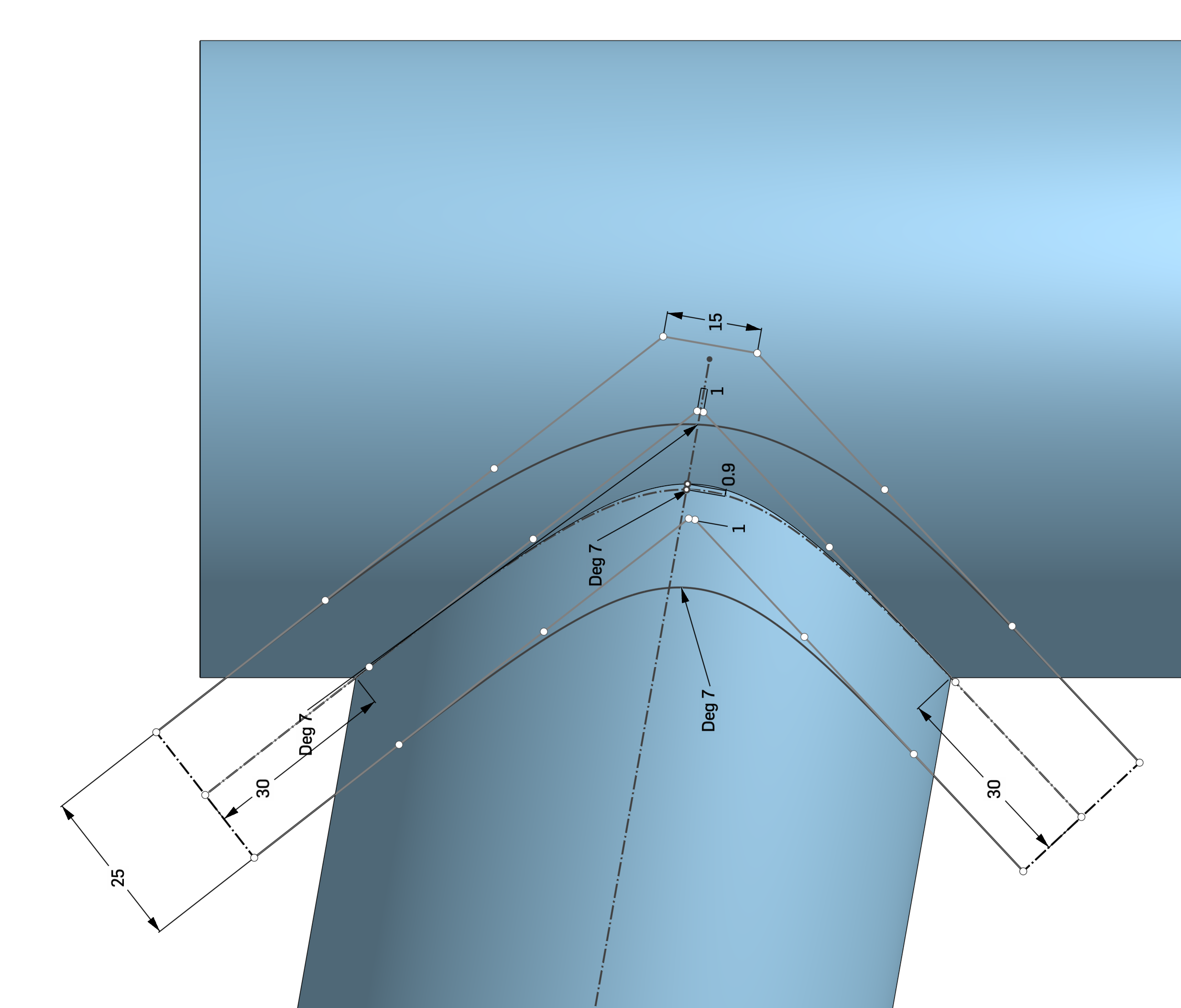

Because of @EvanReese's series on equations, variables, etc. in Onshape, I ended up getting sucked into the FeatureScript rabbit hole. Needless to say, I'm hooked. I'm not a real programmer, but I'm still pretty happy with coming up with something that'll automate a pain point in my CAD workflows. Plus, then I get to share this with the rest of my team.
Link to FeatureScript: Loft Fillet
I created a feature to help avoid the very common (but also very niche) occurrence when that arise from creating edges that terminate on smooth edges, tangent faces, you name it. They generally result in fillets that taper to a point or else just failing altogether. Usually, the workflow to get around this is to:
1. Sweep a circle
2. Extend sweep faces
3. Trim away main body faces
4. Create bridging curves
5. Loft between the open edges
6. Remaining cleanup with booleans, fills, and additional splits
Needless to say, it's a very involved process that requires a few steps and a ton of clicking. Loft Fillet does all of that in one feature. This feature was inspired by @MichaelPascoe's Analyze Fillet. I saw he had a Split Sweep feature, but I couldn't quite get it to work as I intended. I tried to handle as many use cases as I could think of, but obviously, I can't think of everything. Appreciate any feedback that you guys might have. If anything, feel free to peak under the hood to see if there are any optimizations I could implement.

    I figured this feature is a pretty niche, but I find myself going through the workflow way too often. Some of the test cases are covered by the vanilla Fillet, but I needed some quick geometry to test trimming away end caps and filling gaps.
    I can add implementation for G2/G3. It's a pretty simple change in the code. I wanted the feature to be up and running before introducing more complexity to it as I'm still really new to FeatureScript and haven't dealt too deep into programming, really.

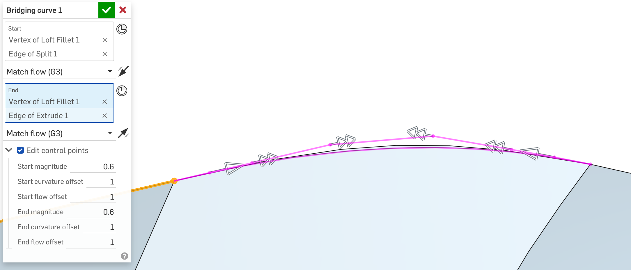

    • The "Loft Magnitude" amount doesn't seem to do anything, at least for the case that I'm playing with.
    • I'd love to have an option to use a Boundary surface instead of a loft. I realize that it wouldn't work well for many complex cases, but Boundary tends to produce cleaner surfaces than Loft.
    • I get that in general edit control points for the Bridging curves could be more complicated, but what I'd love to see is to have the magnitude control apply to the first values of each end of the Bridge curve controls.
    edited December 2025
    • I'll try to add the Boundary Surface option. It might take a bit, though. I'm not sure how fast it'll be for me to implement. But on paper, it shouldn't be too bad since all the inputs are already there.
    • Regarding points 1 and 3, that was the original behavior of Magnitude (i.e. Affects both the loft and bridging curves). When I added the option for G3 in Bridging Curves, you lose the option to set the Bridging Curves by Magnitude/Bias (or at least, that's what I saw in the native Bridging Curve feature). The Loft Magnitude does affect the profile, particularly further away from the guides, just way less so if you have Bridging Curves turned on. I'll explore this a bit more and get back to you on that one.
    • Would you rather have all of the Briding Curve parameters included? It felt to me that the more I added, the less user-friendly the feature would be. Then again, I could set the Edit Control Points option available and turned off by default.
    Edit: I just re-read your third point. And I can definitely add the influence back in if it's just on the first point. I just didn't want to do it for all three, because of the havoc that would cause.

    I wouldn't include all the Bridging curve parameters, but I would include the Start and End magnitudes, with edit control points on. Here for example, I would like to see 0.6 as the magnitude that is exposed to the user in your feature, but under the hood these would be the settings:
    Pushing another update. I took your suggestion and implemented the change where Magnitude control the start magnitude of each Bridging curve side. That took like 10 minutes to do.

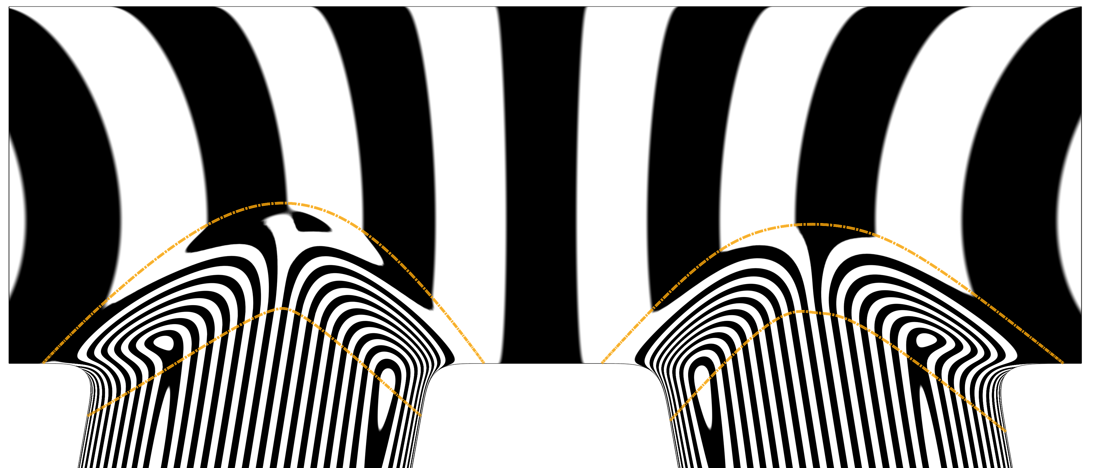

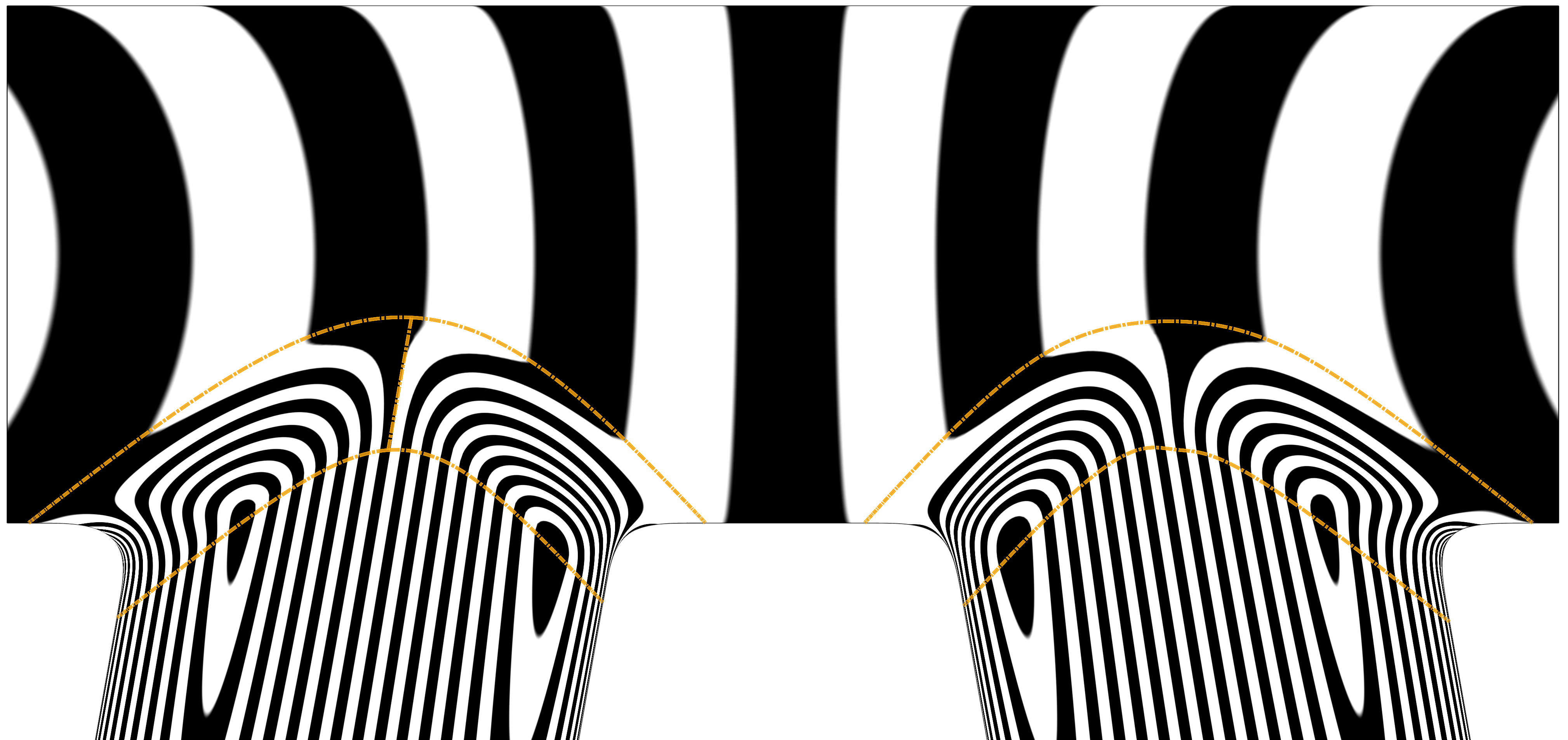

    I spent some more time directly comparing the results of the built in fillet tool and the loft fillet in this case (loft fillet is on the left, regular fillet on the right).
    You're right that a curvature fillet with width control is pretty good. Some of the trim is a little weird, but overall it works well. In this case, if I was really trying to dial this in, I'd end up building this transition by hand so that I could simplify the trims as much as possible to keep the complexity of the transition surface as low as possible.
    One thing I see people doing with Plasticity, Alias, Rhino etc, is taking the original edge and rebuilding (approximating) that curve to be as simple as possible first, and then sweeping the circle along that to get the trims.
    Here's a version where I hand built the trim curves and added a bridging curve in the middle and then built the transition surface with two boundary surfaces. (left is hand built, right is stock curvature fillet with width control.) This makes the highlights at the apex of the transition behave better and keeps it from wobbling so much.
    One could noodle this a lot more.
    I saw in Michael Pascoe's Split Sweep feature that there was an Approximate Curve option. I did add that at some point, but the connection points got all messed up from the resulting edges of the adjacent surfaces (say, if side 1 has three faces vs side 2 having one). The edges would probably need to be split evenly to make for good geometry. Do you have any examples or videos you could share where someone approximates the curve? I've been watching some Plasticity videos and have been curious about how close we can get to its results with Onshape (sans xNURBS).
    The whole goal of the script was to reduce the amount of steps I need to take when Filleting produces unde (i.e. when it tapers to a singularity point), particularly because the whole Sweep→Split→Trim→Bridging Curve →Loft workflow is pretty time-consuming. However, I'll say that if I wanted even more control, I'd be in your camp and build the surfaces manually.
    Ramon Yip | glassboard.com
