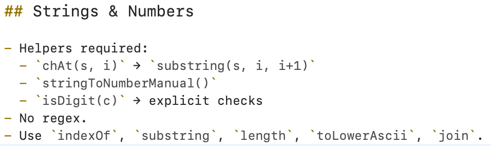

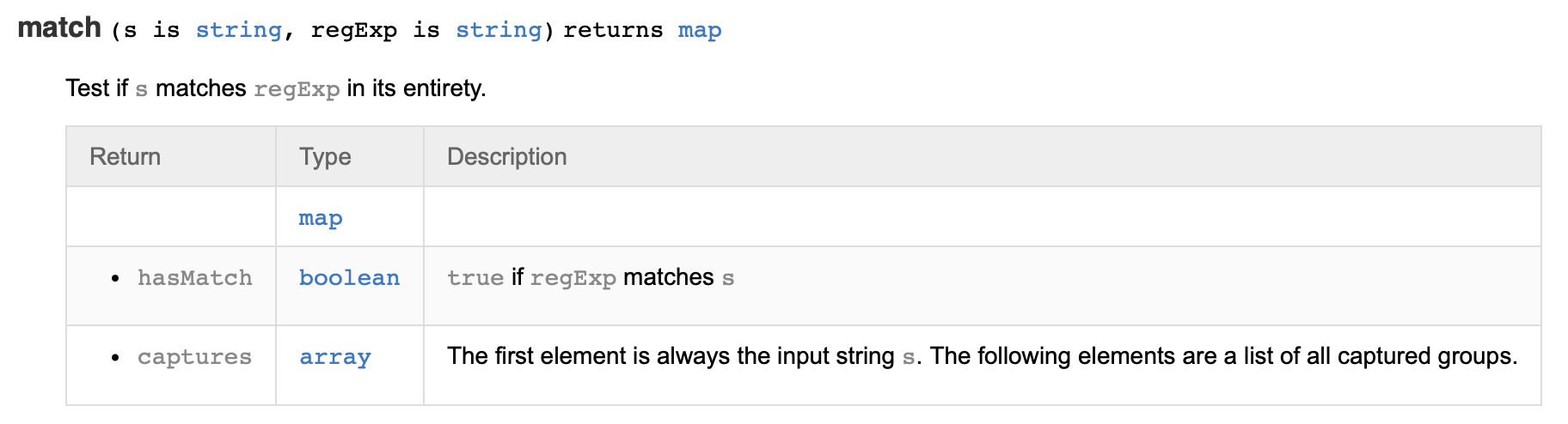

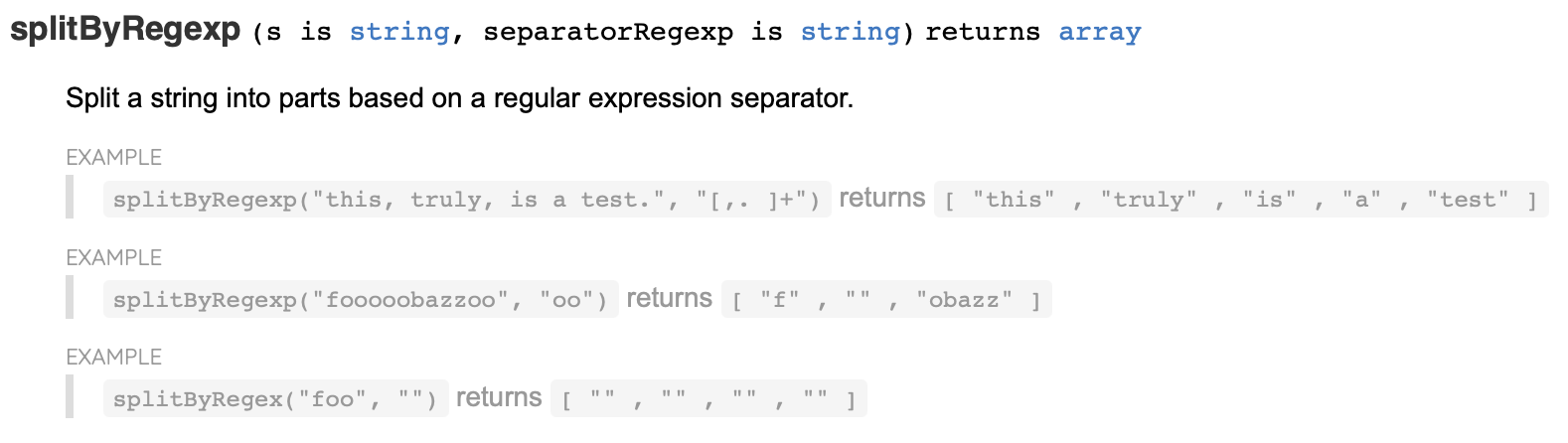

    I am a little confused by your guide that you're using. For example, your notes say "No regex", but there is support in FeatureScript for regex. I would think there would be good ways to simplify the code a lot using some regex functions.
    Here are some sample functions which use regExp in FeatureScript:
    I am surprised that there's no built in way to do toLowerAscii. The if/then/else if/then/else if… in the code seems unfortunate. Seems like there has to be a better way to do that. But it works, which is much better than not having a solution to importing SVG.
