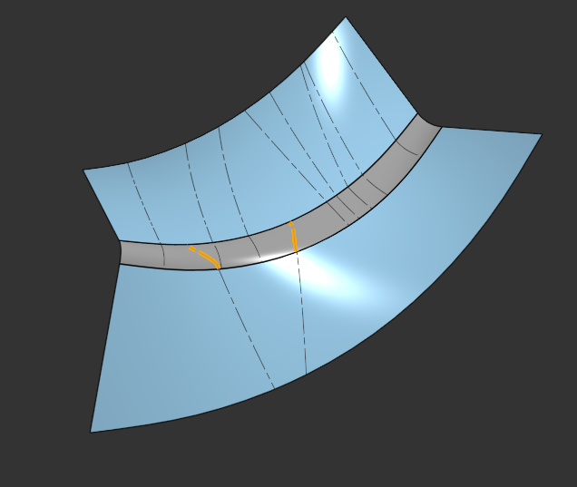

    I spent some more time directly comparing the results of the built in fillet tool and the loft fillet in this case (loft fillet is on the left, regular fillet on the right).
    You're right that a curvature fillet with width control is pretty good. Some of the trim is a little weird, but overall it works well. In this case, if I was really trying to dial this in, I'd end up building this transition by hand so that I could simplify the trims as much as possible to keep the complexity of the transition surface as low as possible.
    One thing I see people doing with Plasticity, Alias, Rhino etc, is taking the original edge and rebuilding (approximating) that curve to be as simple as possible first, and then sweeping the circle along that to get the trims.
    Here's a version where I hand built the trim curves and added a bridging curve in the middle and then built the transition surface with two boundary surfaces. (left is hand built, right is stock curvature fillet with width control.) This makes the highlights at the apex of the transition behave better and keeps it from wobbling so much.
    One could noodle this a lot more.

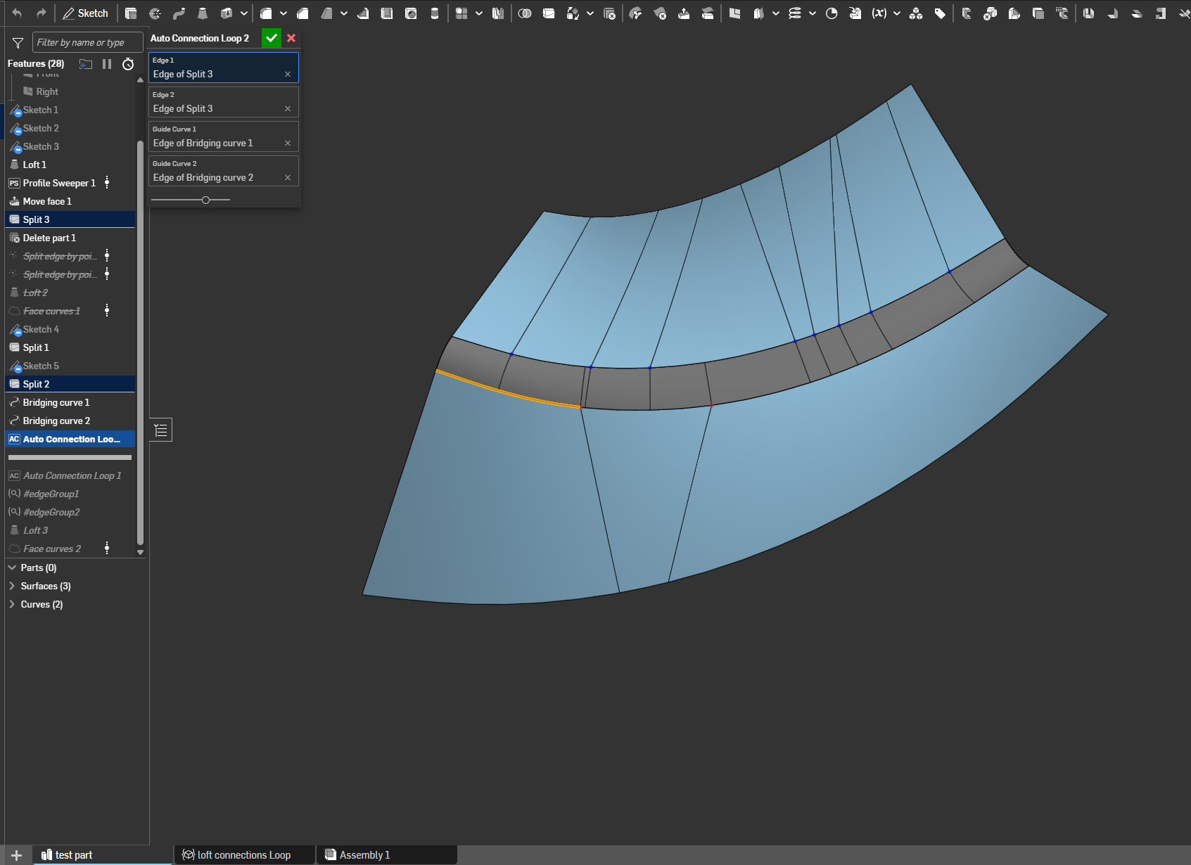

    Upfront link to maybe new script? Auto Loft Connections. Still highly a work in progress, but I thought I'd post it to get some ideas on how to improve it.
    I've implemented support for Boundary Surface and published the script. I'm not sure how good the Boundary surface implementation is since I feel like it might be limited by Onshape's capabilities. You guys will have to let me know.
    I'm also attempting to support a mismatched number of edges and have made some good progress but it's not ready yet. @EvanReese's method of using evDistance worked great, but I need to implement it for both loft profiles and not just one group, it seems. The is mainly in the name of the Approximate option that's been thrown around.
    Here's the script that I've made to test out the functionality that I'm attempting to achieve, i.e. Auto Loft Connections. I'd really appreciate some feedback since I feel like I'm starting to feel like I'm out of my depth. I struggled for quite some time last night trying to figure out how the proper syntax for connections. Featurescript just didn't seem to want to play nice. The orange edges highlighted are the rogue edges that haven't been dealt with yet.
    The script itself seems like it might be useful all on its own, so I might just polish it up a bit. Or else, does it exist already? If it does, I can has the cheat sheet?
    Ramon Yip | glassboard.com
  • Derek_Van_Allen_BDDerek_Van_Allen_BD Member Posts: 672 PRO
    @ry_gb I've got a similar domain matching issue that I haven't yet solved with tween curve to support composite curves with many (and potentially mismatched) segments as an input. The as-yet unapplied thought process was to evaluate the length of each of my curves and the composite segments, normalize the values to a total curve length of 1, split both composite curves at all positions from the normalized unique locations in both lists so that there are a guaranteed matching number of segments that are proportionally the same length of their input curves, then tween each new matched segment.
    This means if I have 3 curve segments on input one and 3 curve segments on input 2 my middle curve might be 3 segments but it might also be 5 segments depending on where the lengths align.
