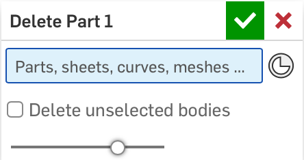

I have a little customized delete feature that lets me delete from the part studio the inverse of what is selected. Sometimes I will import data and there will be alot of stuff in the part studio. So, I derive the studio into other ones and I use this inverses delete feature to select the parts I want to keep and delete everything else. Then I can sort of divide and conquer the large studio into smaller chunks for precise editing. I cannot figure out how to remove the default planes from the selection of qEverything.
