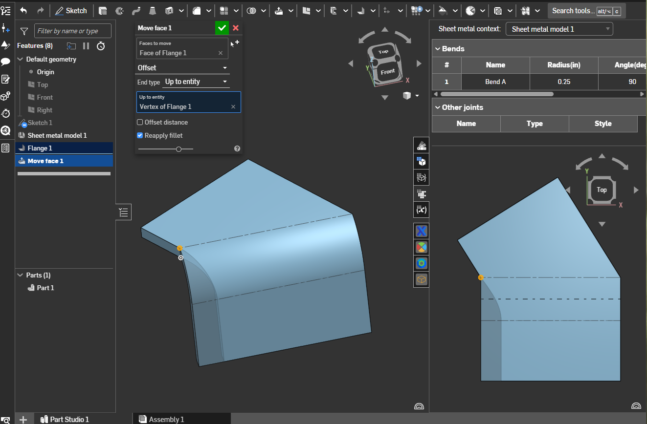

How can I modify a flange so that the two side faces are aligned to parallel planes?
jsejcksnjsejcksn Member Posts: 15
edited December 2025 in Community Support
Here's an image of the desired part geometry as a reference:
I would like to model this as a sheet metal part, but I'm not sure how to create identical geometry with the flange feature. Here are the existing flange feature details:
It appears that when deselecting "hold adjacent edges", the effect is only applied to the back edge and not the front edge. I would like for both side faces of the flange to be parallel and aligned to the implied perpendicular planes colocated at the ends of the flange edge. How can I modify the flange so that the resulting geometry is identical to the reference part geometry?
Here is a link to the example document:
https://cad.onshape.com/documents/882b7f47d2b8ceb345b3ef64/v/933e0940bbcde4ee5e5494c3/e/d2902186bbcab6b54bc04204?showReturnToWorkspaceLink=true

    I'm a bit confused. Looks to me that you already have what you're describing except that there is a non flat around the bend. That is the nature of sheet metal because of the normal cut used with most machines to be used. I have seen plasma torch set up with tilt head to cut counter sink on heavier material, but most not.https://cad.onshape.com/documents/7dce41e4fd270f1e6c28b5c0/w/74be216b7bf558a460f0ab0b/e/38e44e0536412f22b9c7ecb7

    @glen_dewsbury I’m not sure which wording is confusing, but I would like to modify the flange so that the resulting geometry is identical to the reference part geometry — to end up with exactly the reference part geometry using only sheet metal features.
  • eric_pestyeric_pesty Member, pcbaevp Posts: 2,648 PRO
    It does look like turning off the "hold adjacent edge" only "removes" material (i.e. doesn't add some to fill in the near corner). It looks like what you are looking for is a "bend ends normal to flange" or whatever you would call it….
    While I don't see a way to do this in a single step, this is easily achieved using a "move face" feature:

    @eric_pesty Thanks for the suggestion. The screenshot in your comment doesn't show all of the details of the move face feature operation (e.g. which face/faces were selected, etc.). Can you share a link to a public document with the feature applied? It would be ideal for the continuity of this thread if you can create a copy of the example document in my original message as the starting point.

    So it turns out Onshape can be a bit weird with sheet metal corners… The method I showed works fine until about 30deg but doesn't behave properly at 45 where it does this:
    The annoying thing is that it doesn't let you select the bend end face to move it after the fact. One workaround is to "reset" the corner by cutting it out like this:
    Then you can select both the end of the flange and the bend and do the "move face":
    It's a bit of a convoluted workaround, unfortunately we tend to run into these sort of situations once in a while with Onshape. Onshape is generally really predictable but sheet metal is the one area where strange things like this can happen. There's almost always a way to fix it but it can get annoying…
    I'll submit a ticket as this kinda looks like a bug…
    Here's the link to the document:
    https://cad.onshape.com/documents/7be2b2937e5c1c5b8f0d6e22/w/4def68282a50bbb157d470fc/e/bac6b5ed2c69fdc088b95065

    By the way, the move face option I showed is supposed to work for all angles, there is a bug report against it now…
    @bryan_lagrange, I think the original question was about creating the geometry from "native" sheet metal tools. The "reference" was just an example of the desired end result.
    Using convert or thicken is definitely a good approach but in this case the flange and move face should still be the "simplest" in terms of number steps. 1 sketch for the first face, sheet metal "thicken", flange feature, move face to align the "near" end.
    Going back to the original question, this might actually be another bug as unchecking the "hold adjacent face" only seems to apply to the one end!

    @eric_pesty Thanks for the link to the document — it helps clarify and I appreciate the demonstration of the move face technique applied to this scenario!
    In addition to that workaround, I'm aware of others like the one mentioned by @wayne_sauder:
    create the part oversized and cut away the extra
    (as shown here in a branch in the example document) …but ultimately I'd like to avoid these kinds of "hacks" and stick with only sketches and features that convey design intent. I guess it seems like this is currently a limitation or bug in Onshape's sheet metal tools, based on what you said — thanks, again, for the research and reporting efforts.
