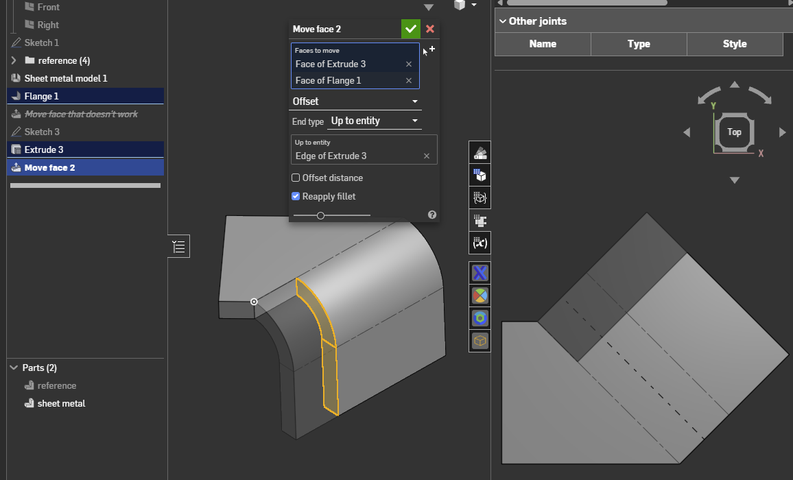

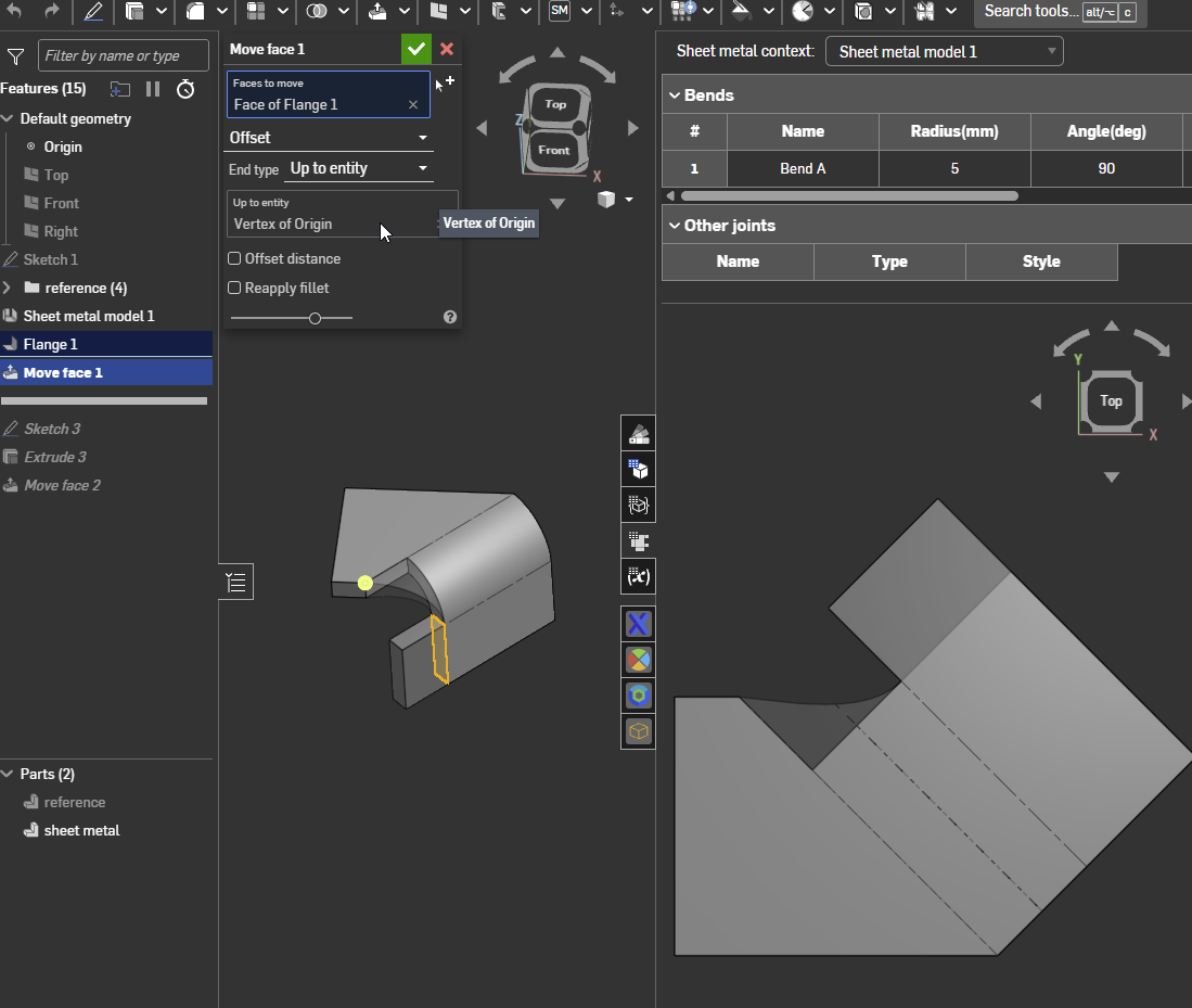

    It does look like turning off the "hold adjacent edge" only "removes" material (i.e. doesn't add some to fill in the near corner). It looks like what you are looking for is a "bend ends normal to flange" or whatever you would call it….
    While I don't see a way to do this in a single step, this is easily achieved using a "move face" feature:

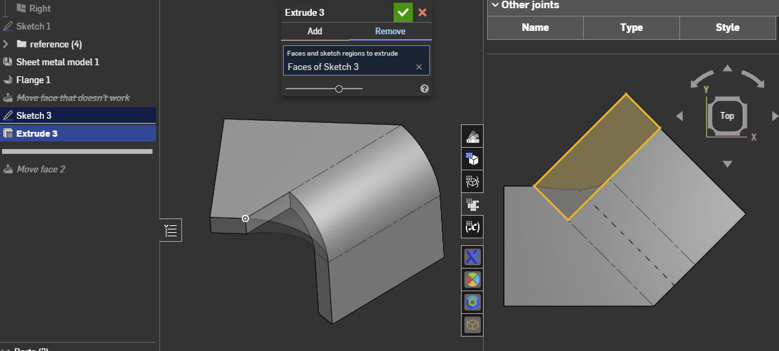

    So it turns out Onshape can be a bit weird with sheet metal corners… The method I showed works fine until about 30deg but doesn't behave properly at 45 where it does this:
    The annoying thing is that it doesn't let you select the bend end face to move it after the fact. One workaround is to "reset" the corner by cutting it out like this:
    Then you can select both the end of the flange and the bend and do the "move face":
    It's a bit of a convoluted workaround, unfortunately we tend to run into these sort of situations once in a while with Onshape. Onshape is generally really predictable but sheet metal is the one area where strange things like this can happen. There's almost always a way to fix it but it can get annoying…

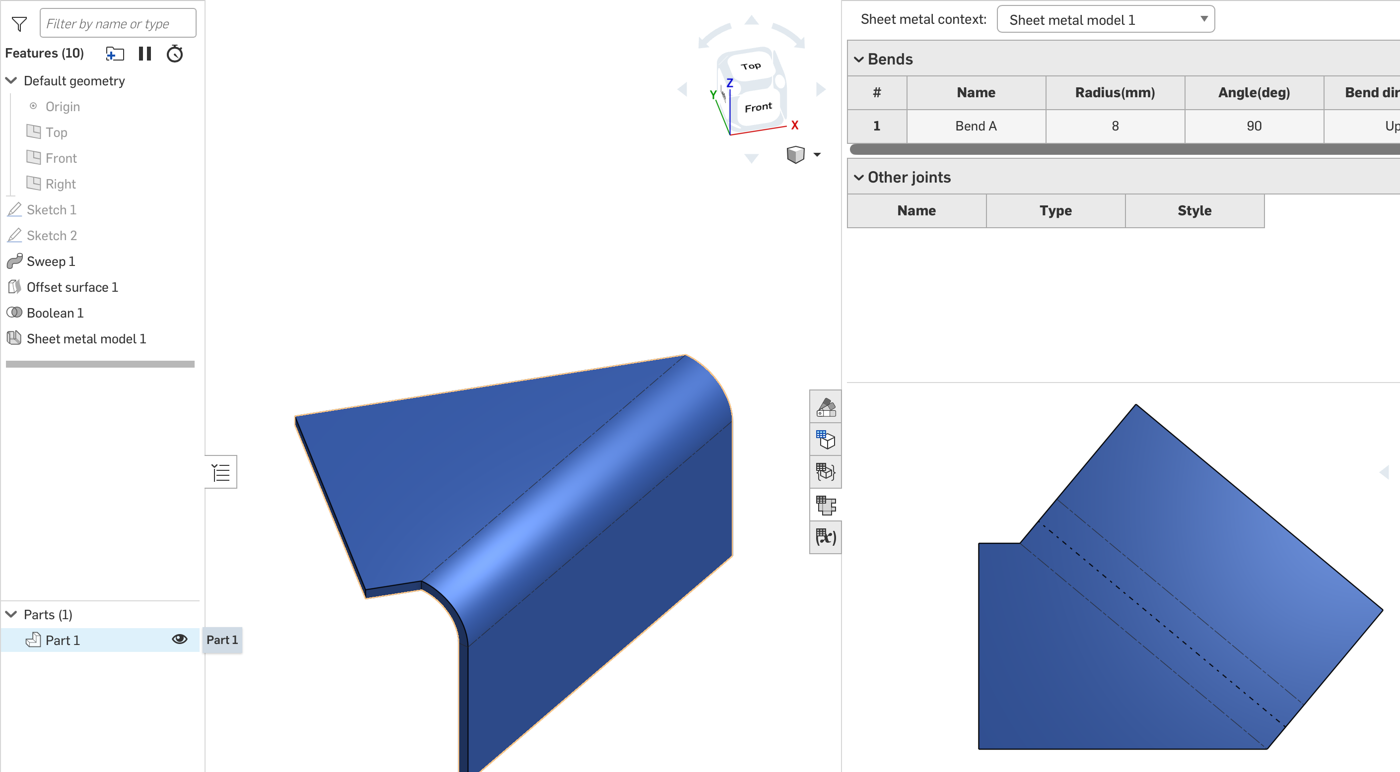

  • S1monS1mon Member Posts: 3,978 PRO
    Sometimes what makes more sense to my brain is to build sheet metal models with surfaces or solids, and then convert to sheetmetal. Here's another way to get what you want with the flange.
    https://cad.onshape.com/documents/295040ac1b60a6fc26138eb5/w/08d73507fa5106d8e0e2924b/e/2bedde1f3e8708cc50b6ae92

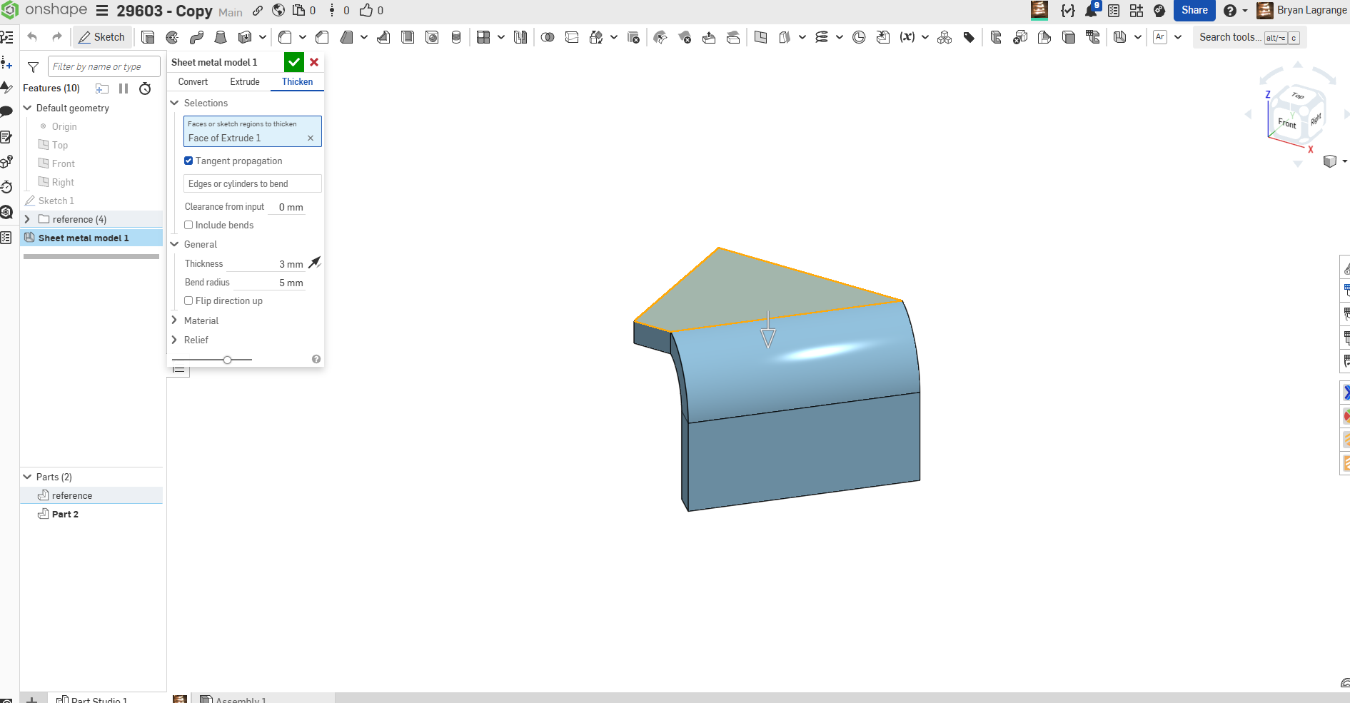

  • bryan_lagrangebryan_lagrange Member, User Group Leader Posts: 976 ✭✭✭✭✭
    How about select tangent propagation during the sheet metal translation to keep it the same as reference.
    https://cad.onshape.com/documents/348d58de247234d86de95d49/w/72cce5692a0488547f1ffc13/e/04afa1d0aeb4195944d83a11

    By the way, the move face option I showed is supposed to work for all angles, there is a bug report against it now…
    @bryan_lagrange, I think the original question was about creating the geometry from "native" sheet metal tools. The "reference" was just an example of the desired end result.
    Using convert or thicken is definitely a good approach but in this case the flange and move face should still be the "simplest" in terms of number steps. 1 sketch for the first face, sheet metal "thicken", flange feature, move face to align the "near" end.
    Going back to the original question, this might actually be another bug as unchecking the "hold adjacent face" only seems to apply to the one end!
