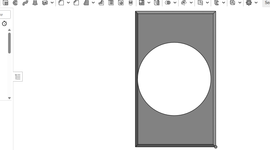

how do i centre holes?

    Best would be to create the hole on the middle. There should be a Mate Connector at the center. Use that as the input for the hole tool. Else, make a sketch on the face, draw a circle, constrain it to the center of the face, extrude. Or, if the hole is in an imported part, use the move face tool, translate, select the hole center as start point and the face center as the target point.

    Most of the time, here's how I do it. Construction line corner to corner. Place point at center of construction line. - Scotty
