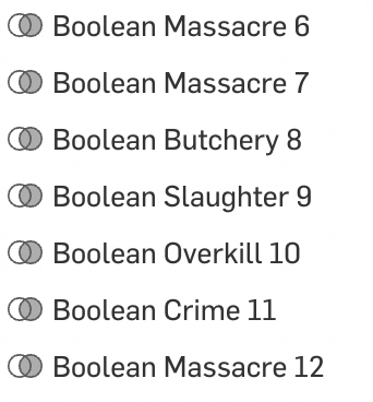

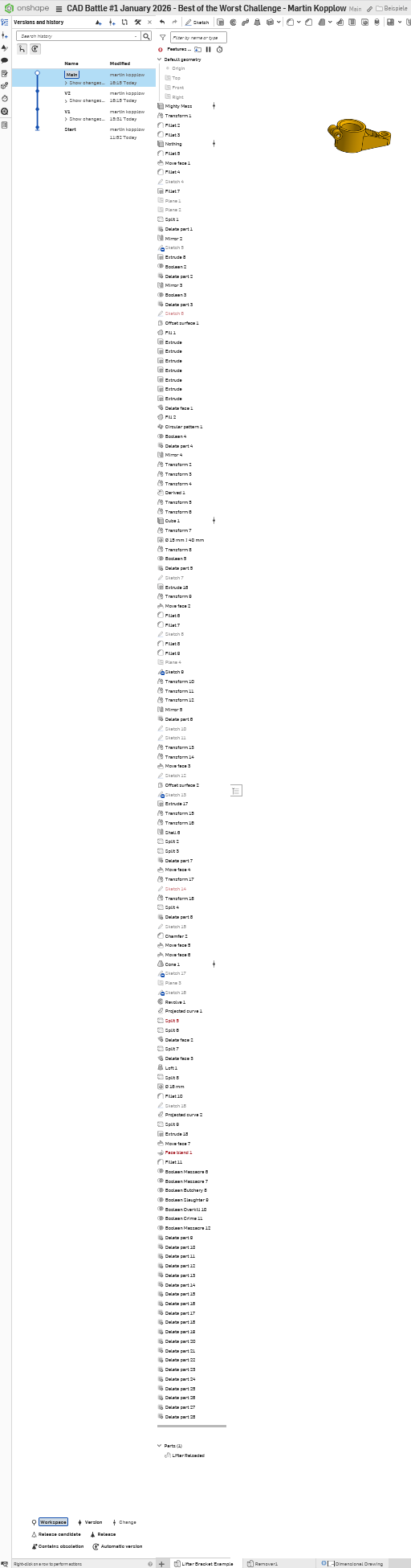

    Okay, inspired by what I saw yesterday, here's my entry:
    https://cad.onshape.com/documents/a2c036d694ddf06c748a1cbb/w/f4f105d026f325bf616e8833/e/0ea9b9d430f224fd2b2081bb?renderMode=0&uiState=696cf9426370003b337fb085
    I did in fact use some features, but tried to do it in the least meaningful manner, and never in a straight and targeted way or hardly for what they were meant to be used. I used booleans for things that could have been done 'cheaper' in many other ways, for example when creating a pin by booling away a slab from another slab that had a hole in it, only to use the pin obtained to create more holes by more booleans. And if a sketch may appear fully defined, I did not do it on purpose and it's pure coincidence. I made round things out of slab primitives. I also used an awful lot of transforms and deleted a lot of stuff. Also, I used a special Sawblade Feature to split solids at different angles. As a designer, you gotta take tinto account what tools they do have in the shop, don't you?
  • Derek_Van_Allen_BDDerek_Van_Allen_BD Member Posts: 589 PRO
    @martin_kopplow all of the crimes in that list are real things that I've seen people on my team do. Though I suppose I am guilty of giving them advice along the lines of "You see all that yellow in the feature tree? You know what yellow means? That the model built successfully, send it" so I can't hold it against all of them. Except the one that based the core of their whole catalog standard on the backside of the right plane and forced me to redraw the whole dang cabinet line from scratch. That one I'll never let go.

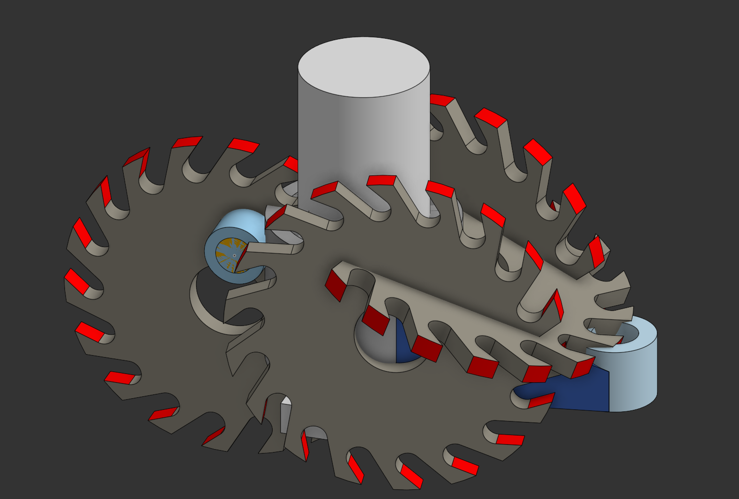

    I am tempted to relax the rules a little to allow this submission because there's an elegance in execution on display here that I think ought to be appreciated. I mean look at this:
    Marvelous.

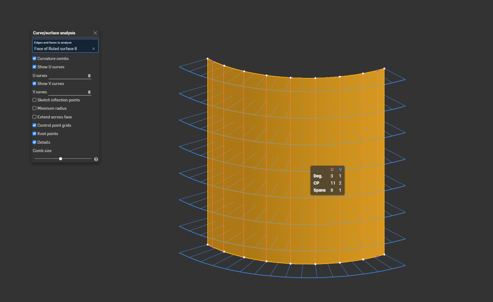

    @EvanReese you deviated a little bit away from the front pocket geometry with that squared face instead of following the curve of the main clamp part like the reference doc, but aside from that this is a fantastic sketchless example. I'm glad we got at least one Routing Curve example in here, there was a moment in the development of some of my curve utilities scripts that I thought about using Routing Curve's fillet capabilities to draw 3d curve arcs since there's no native function for that. Was gonna overdraw some lines and remove the straight bits much like your example does. In the end I couldn't get that to work in a continuous chain so my arc utilities just draws temporary sketch planes and then removes the construction objects to get the pathing to work.
    It's interesting that the ruled surfaces for the circular bits evaluate as B spline surfaces instead of cylindrical surfaces even though the top and bottom edges evaluate as circular arcs and it's got a well defined extrusion direction.
    This explains why I couldn't use a ruled surface operation for my sheet metal tab and slot feature and why the boolean kept failing on the circular tabs. I never realized they didn't come out truly circular. I'll have to keep this in mind next time I'm scripting with it. That does mean that this probably won't pass the Matching Bodies query in the end because the surface definitions aren't the same, but you'd probably pass the mass properties evaluation used by the CAD Challenges app to grade submissions with this part once that pocket gets fixed.
  • EvanReeseEvanReese Member, Mentor Posts: 2,759 PRO
    @martin_kopplow Your model is viscerally repugnant. In all my years I have never witnessed such an odious feature tree. It is truly horrendous.
    @Derek_Van_Allen_BD I thought that was an interesting learning too. As for the model not matching, you're not going to believe this, but there was a feature error in the model that prevented it from being perfect. It's perfect now.
