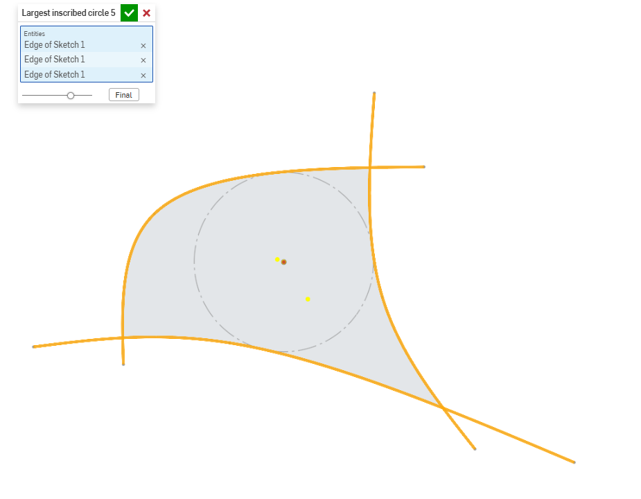

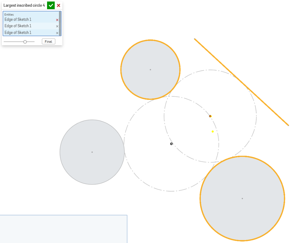

  • Derek_Van_Allen_BDDerek_Van_Allen_BD Member Posts: 647 PRO
    I've been puzzling through a Largest Inscribed Circle problem that's a related class of problem set. I don't love the iterative solver approach but I've struck out on finding an analytical approach that works.
  • Konst_ShKonst_Sh Member Posts: 123 PRO
    edited January 23
    @Derek_Van_Allen_BD yep, this also a good use for it, interestingly it allows not just triangles, but any combination of curve segments:
    https://cad.onshape.com/documents/ae329b71917362861fcd1689/w/03830fe502efd40ceb6c2ef5/e/d2f3ba050a24e149eefc2964
