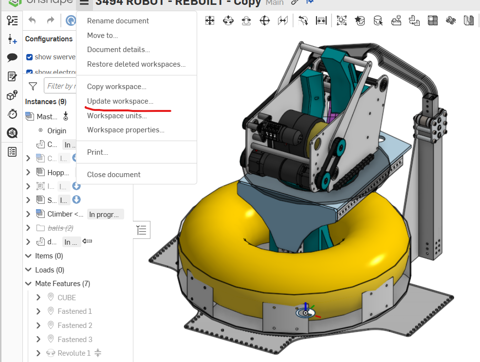

    I waited for this document to load which took a while.
    Then I asked for a work space up date. Loads much quicker now.
