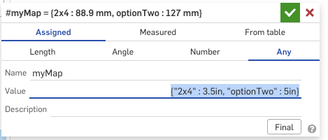

Btw you could declare all of the width's in a single map variable if you want. Something like:
#widthMap = {"2x4" : 3.5 * inch,"2x6" : 5.5 * inch,};Then later you can get them like
#widthMap["2x4"]The Onsherpa | Reach peak Onshape productivity
Oh, so that's how you get maps to work inside of studios? You may have mentioned it in a video, but I must've forgotten. I kept trying to use dot notation.
Ramon Yip | glassboard.com
dot notation will work for strings as keys, but something in my liminal conscious was saying that a string starting with a number would mess it up. I just checked and that seems right. In this map #myMap.optionTwo works and #myMap.2x4 fails, but the bracket notation works for both.
Yep, it was with numbers that it didn't work. Thanks for catching that distinction.
