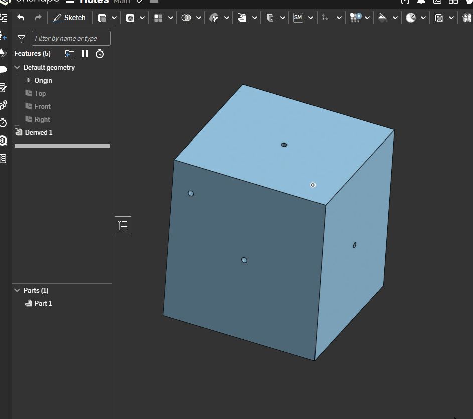

Hi if i imported a part that has multiple holes on it
then what is the quickest way i can add points on the centres of those holes all at once so I can use the hole feature to define a certain hole.
Doing a sketch on top of the existing hole takes too long which is why im looking for maybe a featurescript that has this
Thanks,
  • eric_pestyeric_pesty Member, pcbaevp Posts: 2,549 PRO
    You should be able to just use mate connectors directly in the hole tool:
    There should be ways to "automate" that using query variables etc but likely not worth the effort unless you have a ton holes to do that way!
