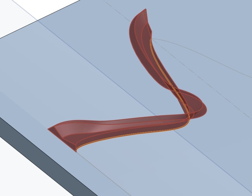

Hi,
Why can't I sweep the figure of sketch 3 along the path in sketch 2?
In the image the result of my sweeping.

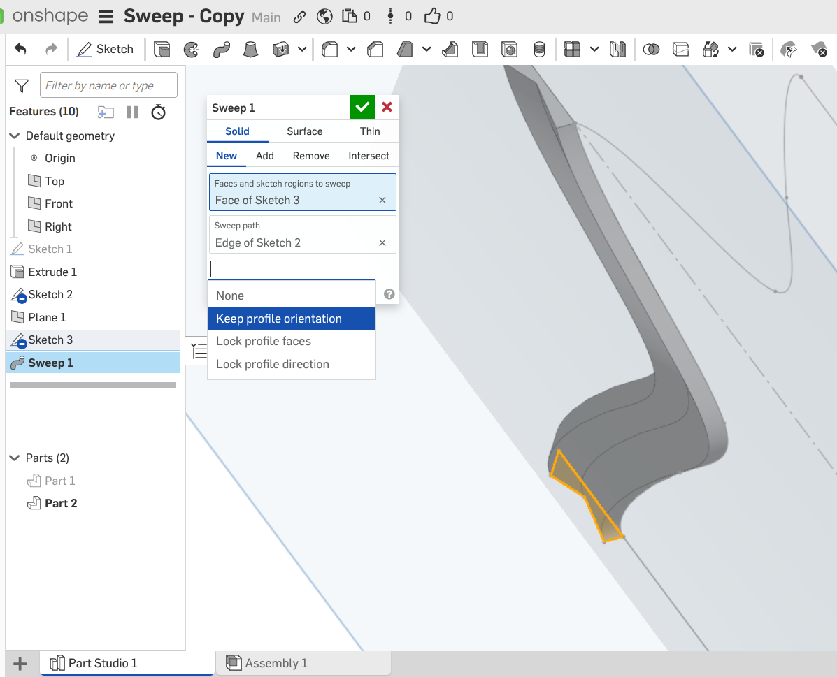

  • CADNurdCADNurd Member Posts: 59 ✭✭
    'Keep Profile Orientation' option

  • ProApeProApe Member Posts: 230 ✭✭
    I don't understand where and why!
    In Part Studio 2, I made another sweep that worked.
    But what do I have to do to make the start and end points perpendicular to the line?
    edited February 5
    "'Keep Profile Orientation" helps, but although I have chosen that option, as well as modified the figure and the path, I am blocked at the corner in the middle.
    https://cad.onshape.com/documents/9eade1081f2f93fb75689bbf/w/27f7c9b248a69cc1018262df/e/701771031e6e40053d0beae5?renderMode=0&uiState=69851a804a5334ffe3da3060

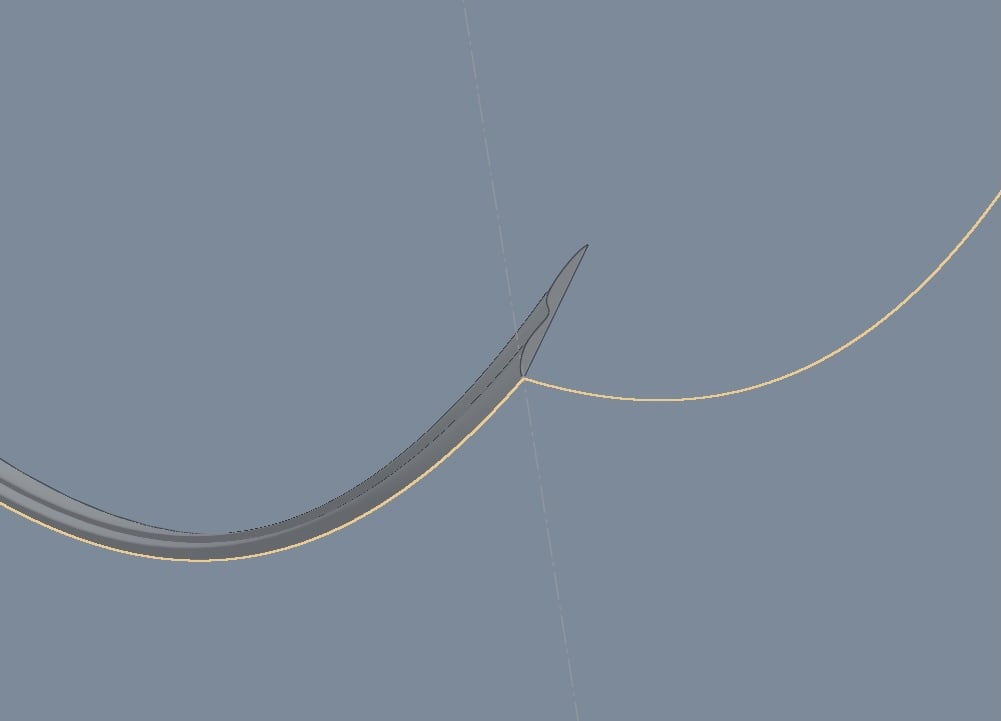

    After some playing around . . . try to make sure your profile sketch is 'normal to' the start of your path. Done using - https://cad.onshape.com/help/Content/PartStudio/plane.htm#CurvePointD
    Also, don't forget you can locate a sketch using a mate connector, and if you hover over the end of a spline you can usually select a 'normal to' one.
