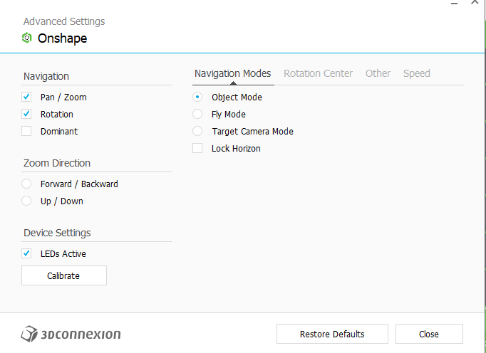

• Secondly, I use a 3DConnexion SpaceMouse, and all is good except left-right panning. Updated the driver to latest, verified hardware performance with the manufacturer's app (all good), tweaked 3D Connexion advanced settings, and tried a different browser (Chrome) over what I prefer (Vivaldi) but the OnShape result is equivalent: left-right panning seems dead, everything else works just fine.

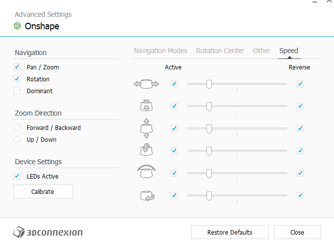

    So the left-right pan issue described above disappeared using this 3DConnexion SpaceMouse configuration.
    Reversing the actions (under 'Speed', see 2nd image) along with 'Object Mode' selected here results in 'helicopter joystick' behavior, familiar to gamers everywhere.
