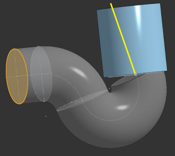

Hello there,
I am facing a problem trying to sweep a profile. I could probably make the path sketch a bit different using tangency or adding a straight line where the path meets the existing part (blue) but since this is an exercise i dont want to come up with a different result. I already did it with 3 different loft's (and the shown sketches where i also tried connections) but that doesnt seem like the way its supposed to be designed. How could i made the end of the pipe mee the existing part in an alligned way and make it perpendicullar to it so the meet perfectly? The Lock profile faces + lock profile direction do not seem to help although i might be doing something wrong. Thanks for your time :)

Not sure if you figured it out yet, but just looking at your image, it looks to me like the end of your sweep is not tangent with the central axis of your blue cylinder. It seems to be tangent to some other random line which would, if it existed, look like the yellow one I have created below . . .
Solution: Create a central axis construction line, if none exists, and make the end of your sweep tangent to it.

This seems to be the obvious solution.this is the actual view of the exercise. the instructor while in solidworks has a selection of "align with end faces" and "merge with end faces". I guess this is how it is supposed to be made but without the automation inside the sweep command solidworks offers.
