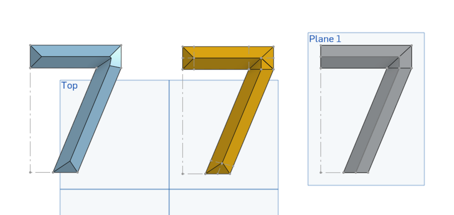

I've linked 3 different attempts I've made at this. The first one just does a draft angle which is easiest but doesn't quite get it right.

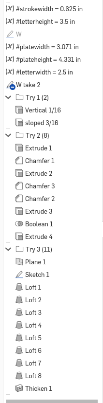

The second one builds and chamfers 3 different extrudes which are then boolean joined, but the chamfer on the upper right of the 7 isn't quite right and fiddling with decimal places to get it "close enough" is not a fun workflow.
The last one uses lofts and thicken but requires an offset plane and projected geometry and a whole bunch of lofts because if I try to chain them it gets curvy and I want them straight walled/triangular..

Less lofts are possible, but since you will inevitably get self intersections in the tighter corners, you will need to stay in control and that requires a certain number of steps, be they lofts or anything else. The "draft" on such type of letters is not constant, so that is not an option. Lofts work on a point as one profile, but not on points as a part of one profile, so nothing to gain here, too. Since your main control is via the footprint and the ridgeline, I'd approach this by creating exactly the control elements, define an offset variable for the ridge heigt and then specify the ridgeline right in place, then loft or otherwise connect it to the simple extrusion of the base.

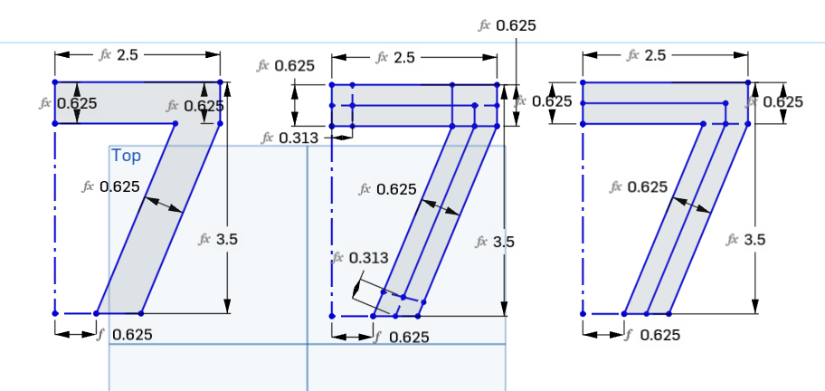

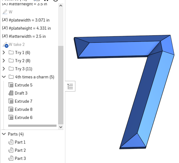

Not sure what the ultimate goal is but with a little bit of math you could make this workflow work and be parametric that you can adjust the height of the ridge if needed to work out perfectly. I just tweaked the Draft 2 angle and the move face 1 (actually a rotate) angle to get close to what you want. Ooorrrrr…. you could use this 5 feature workflow in the 2nd pic and skip the math.. 😉
