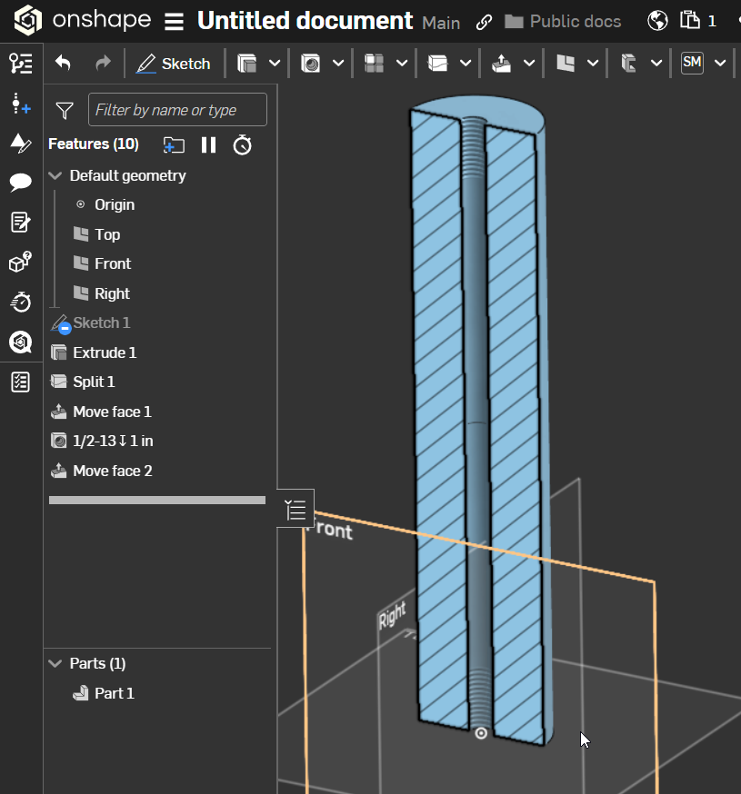

UPDATE, this doesn't exactly work.
offset face in → tap → offset face out causes the visual threads to disappear from one end of the hole.
Creating half the part and then mirroring the part, also causes one end of the threads to disappear. below is mirror-new vs mirror-add.
mirror-new → boolean union does the same thing
even though the visual threads are gone, the hole callout in drawings is "correct", however, it is actually wrong, because we do not want or need any drilling operations, as the hole already exists in the stock. any way to get rid of that, or create a library of custom callouts?

I think adding a split in the face in the middle would allow threads to show at both ends?
https://cad.onshape.com/documents/ec7c90893bd97bfc6d8b6152/w/6c8ee8bb48923930500e3857/e/386f9e04f6372bf223d30ffa?renderMode=0&tangentEdgeStyle=1&uiState=6994a07a5118515c48cbbb0f
There was also a "tag hole" FS somewhere
yes, I added a split, but it seems like that part of Hole is buggy. also, the visual threads change depending on where you place the Z of the hole location mate connector. not the start plane, the location. this also seems buggy. and beyond that, it feels like a huge deficiency that you can't tap an existing hole.

EDIT: I found tag hole and simply tagging a hole is 1800 lines, wow. I need to find the core of it and just make a "tap 10-32" and "tap 1/4-20" which is 99% of what we use.
