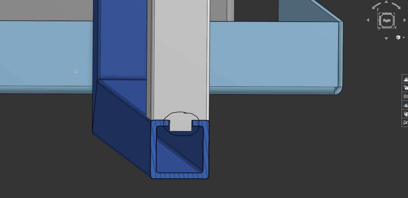

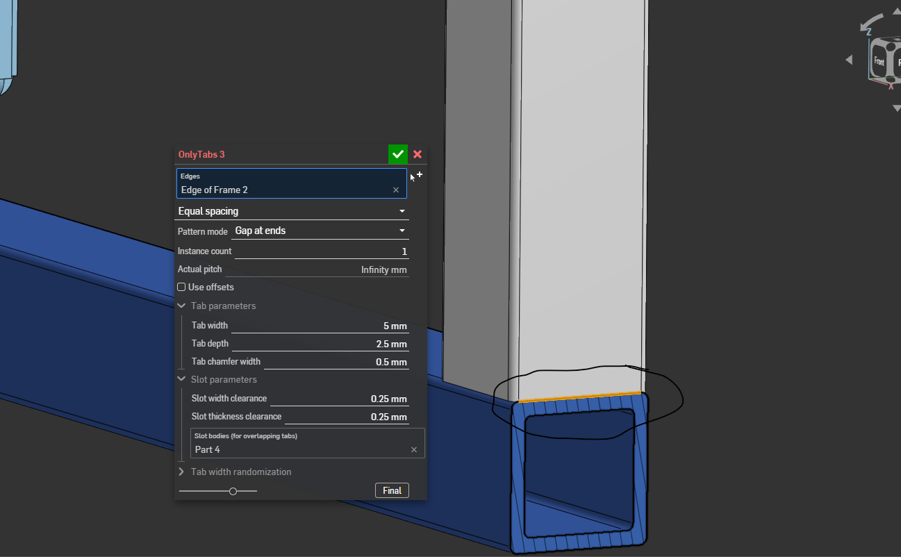

@Derek_Van_Allen_BD Thank you for developing this amazing feature. I started to test it out on several examples and I wonder if I can use it in standard tube profile frames this feature as shown. It is a "frame on frame" tab and slot. This is super helpful for frames assembly and weldments, especially that nowadays these standard tubes are usually cut using a rotary laser machine.
I have been trying to use OnlyTab to execute this feature on this 2mm thickness standard square tube but it seems to give me an error, not sure if I am doing something wrong, Thank you in advance.
At this point in time the feature is only designed to work on sheet metal bodies and not frames, due to the unique architecture of how sheet metal works in Onshape it was necessary to specialize the workflow and focus on that first. Frame tab and slot is 100% a feature I am interested in writing, though, and will follow up when that implementation is ready.

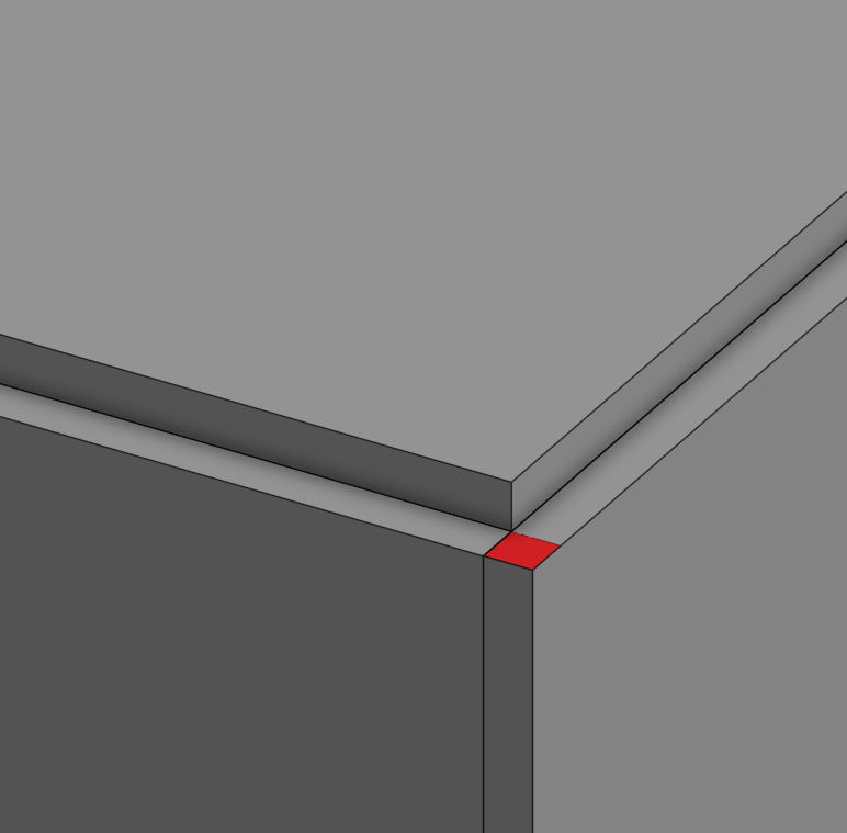

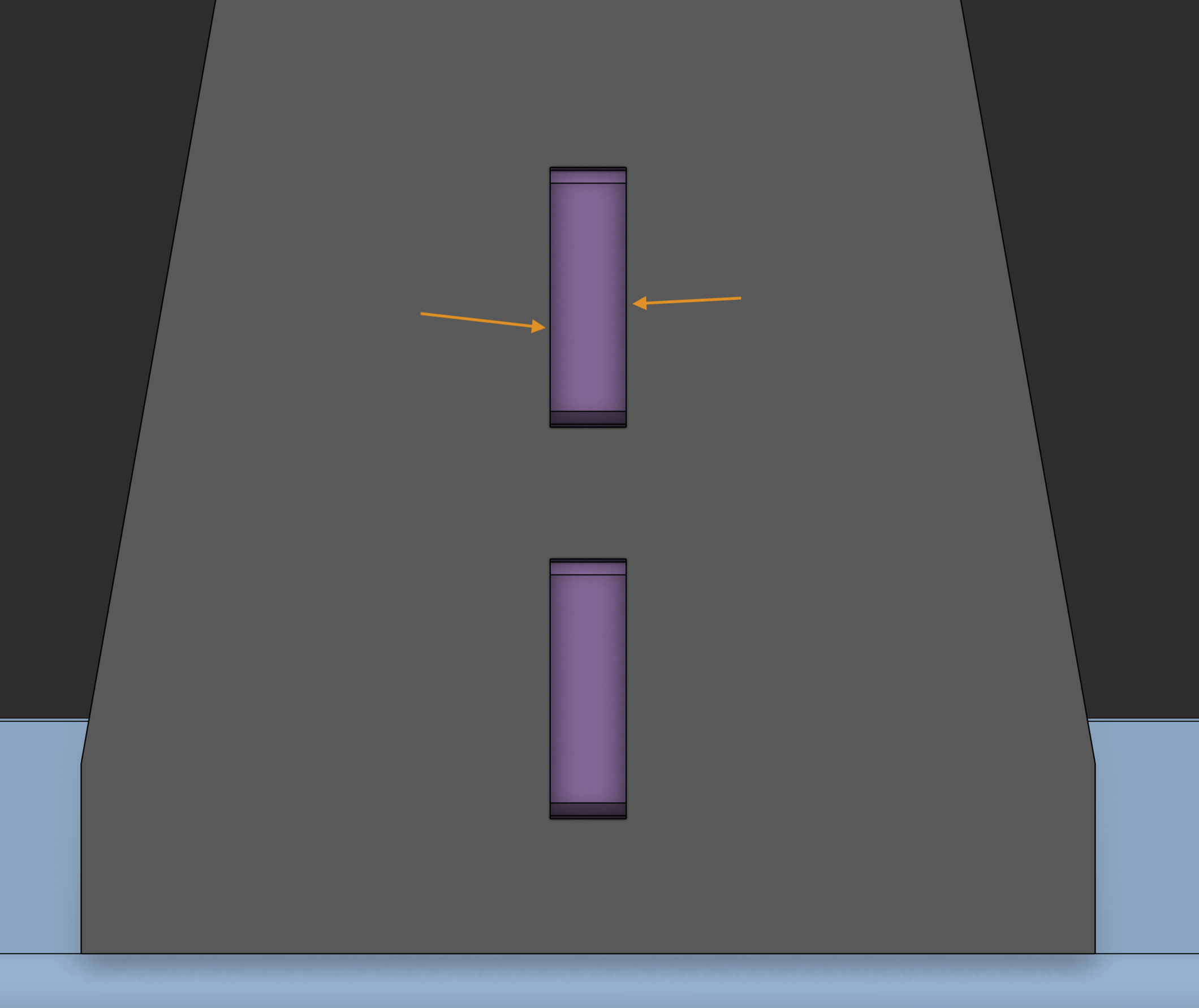

Derek Van Allen | Engineering Consultant | MeddlerHey @Derek_Van_Allen_BD just reconfirming this. Did the recent rework to Move Face break funcitonality for OnlyTabs? What's the fix for it?
Ramon Yip | glassboard.com
Move Face should play nicely with OnlyTabs as of the recent update but if you have a broken case you'd like to share with me I can help diagnose.
Derek Van Allen | Engineering Consultant | MeddlerYeah, I just tried it again and I'm not sure what the deal with Move Face is. It's leaving these weird tangent faces that seem to break OnlyTabs. I tried it on a separate part studio and it works, so I'm not 100% what the voodoo magic behind it is.
Link to doc: https://cad.onshape.com/documents/8b337f412ad76d2daab01d99/w/4797c1ddcb0ab81bbb89ae8f/e/610e32cc74039646a5cdce07
It seems to work if you Move Face all of the edge faces of that part, but I definitely have test cases that should have covered moving a single edge for tab and slot. Time to roll back to older sheet metal versions and investigate.
Derek Van Allen | Engineering Consultant | MeddlerOkay I've discovered that adding thickness clearance to the slot generation does fix the problem as well. That means there's something in the logic of sheet metal generation that doesn't like surfaces from the same master definition touching when doing a sheet metal rebuild if there are shared joints across the rest of the object. I'll have to think about how to architect around that without forcefully adding minimum clearance values for the user.
Derek Van Allen | Engineering Consultant | MeddlerAh interesting. So it doesn't like when I expect perfection and don't account for totally reasonable real-world clearance needs?
Only if you're tabbing a single joint. If you use reasonable real world half-lap joint geometry on all of the sides of the panels to remove all the rip associations and not rely on your welders to try to float panels together on an infinitely thin knife's edge of geometry then OnlyTabs has no problems delivering your most unreasonable zero tolerance geometry needs.
