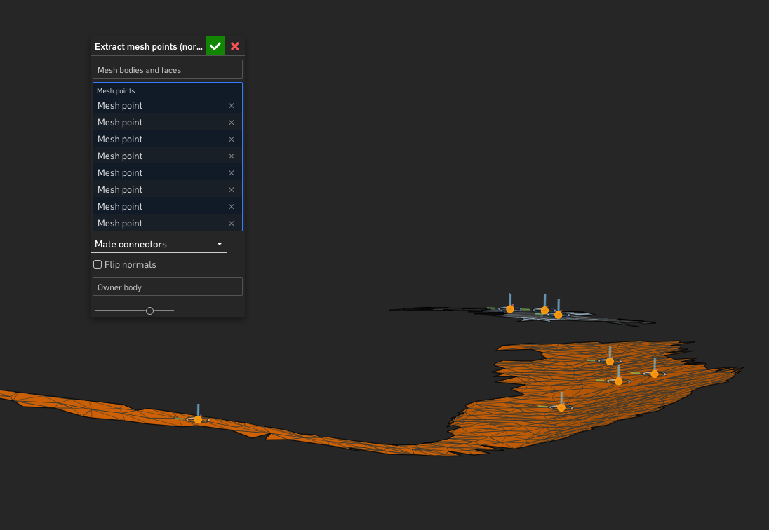

    @EvanReese, as always, your FS are so useful. Thank you! I expanded your mesh points to return normals as well to help guide Constrained Surface more.

  • EvanReeseEvanReese Member, Mentor Posts: 2,847 PRO
    Thanks @armandoRR That's a good idea and I'd love to fold that change into the feature! However I'm seeing this when using it. Shouldn't the MC z axis be normal to the mesh?
    I also updated the input type to a horizontal enum at the top and made it possible to pick meshes as owner bodies for the MCs

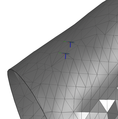

  • armandoRRarmandoRR Member, pcbaevp Posts: 33 PRO
    @EvanReese Strange, when I test it, it is normal to mesh, but I've not tried it on closed mesh bodies. Will have to test this out. I'll switch to horizontal enum as well.
    Those all look vertical to me in the screenshot fwiw. Test by transforming the mesh and rotating at an odd angle and trying it again. I really like the idea though!
