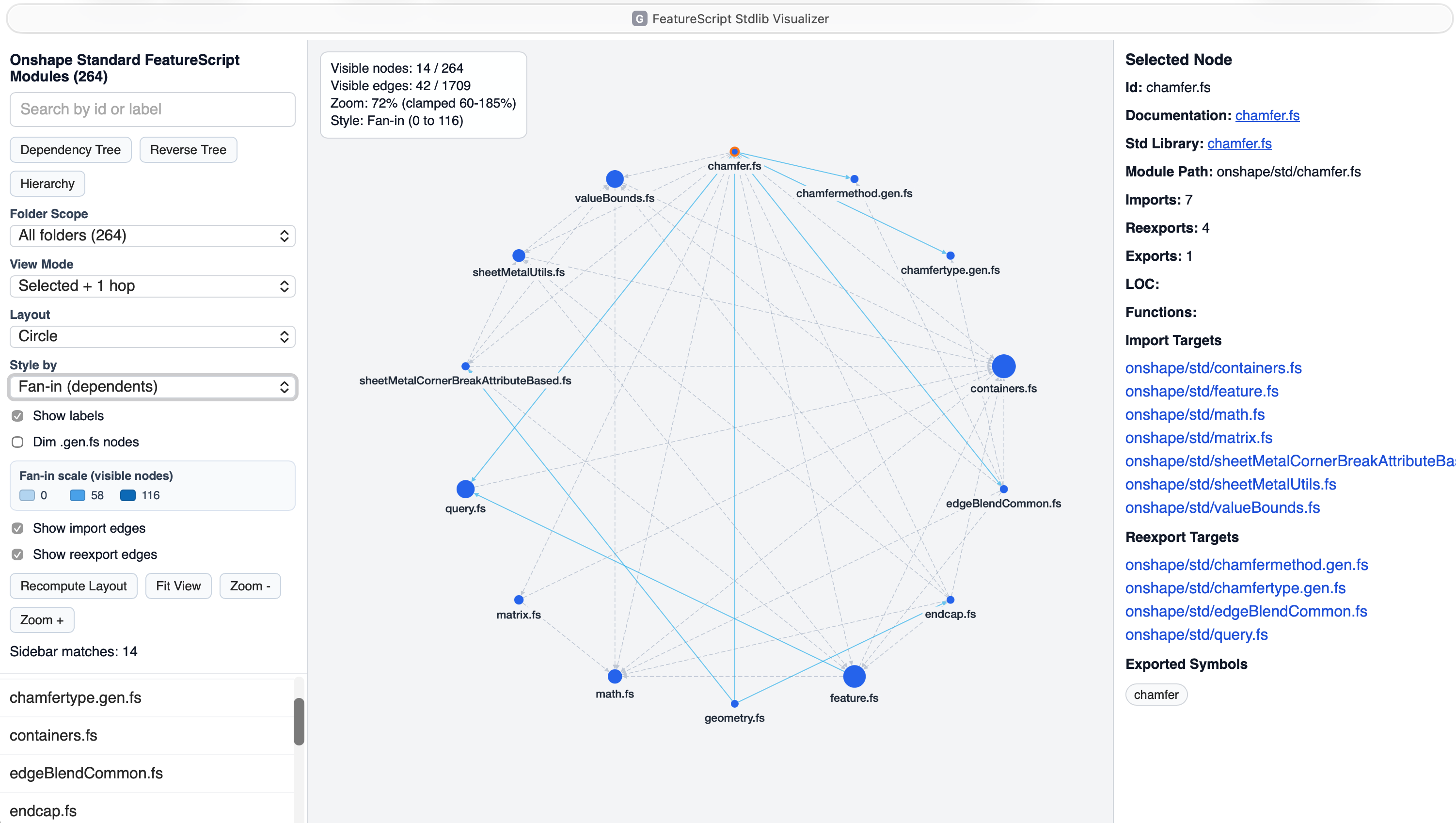

I built a tool (or more accurately vibe coded a tool) to visualize the Onshape Standard FeatureScript library. This is very new, and I'm sure there are some weird things about it. Let me know what works and what doesn't. For each module, it shows what's imported/exported, a link to the documentation, the cad.onshape.com link to the module, and lots lots more…

    After that, there was a lot of dialing in of UX/UI, and adding the links to the docs and codebase, but surprisingly easy. Part of a day's work.

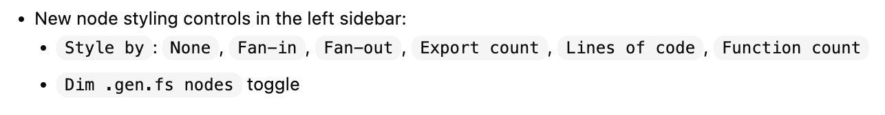

    I updated the site to add node styling options for various metrics. Basically it can scale the dots by various attributes.
