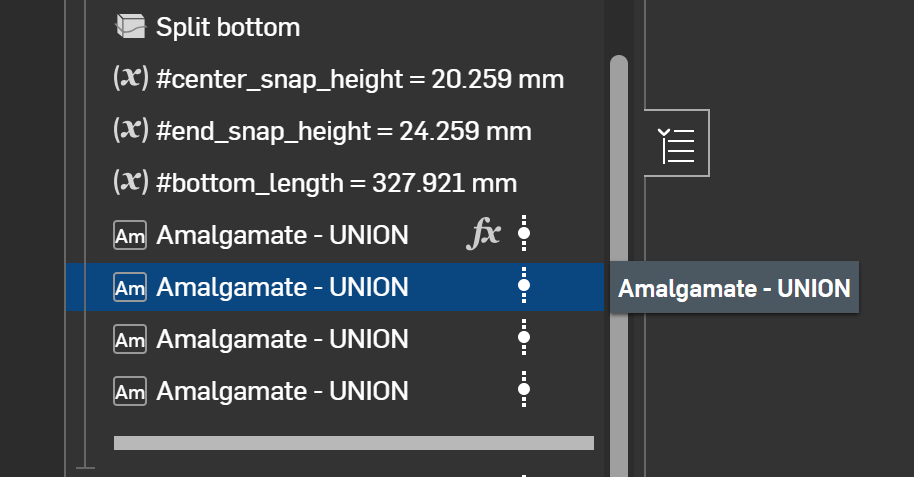

  • jason_ryan337jason_ryan337 Member Posts: 71
    Hi @Derek_Van_Allen_BD. The new update that has the spin feature is nice! It seems like I have lost the ability to rename the feature to anything other than "Amalgamate" though. Not sure if it's a problem just on my end.
  • Derek_Van_Allen_BDDerek_Van_Allen_BD Member Posts: 783 PRO
    @jason_ryan337 yeah that's a breaking change that I made so that the naming happens in the tagging step. An unfortunate but necessary sacrifice to allow computed properties into the naming field to allow you to control the amalgamates at the source. The only way to get both the ability to rename the feature and allow computed property naming simultaneously is if I re-declare the feature itself as either hole or routingcurve explicitly because those are baked into the Onshape UI at the global level. It would require a change by the developers at Onshape to allow this for other custom features that don't have one of those two feature declarations. @ilya_baran
    Deleting and reapplying the tag and amalgamate features will allow you to take advantage of the new ability to store names in the tags and drive them with variables based on the part configuration.

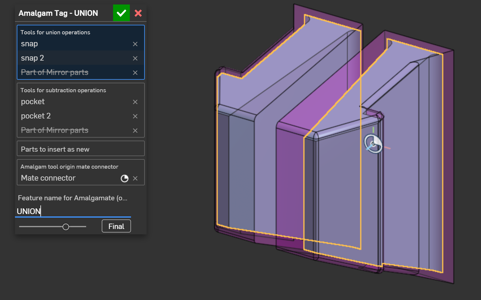

    Gotcha. So the naming convention can change dynamically from the source side. Like the length/width of features can be pulled into the name? I tried using a # in the optional name, but it didn't seem to allow a variable though.
    I am not sure about others, but I have a lot of instances were I have more need for discernment on the destination side than the source side. Often I might need to apply a feature differently to the right side of a part than a left side. I'm not sure if there is a good way for me to discriminate.
    Two ways to go about it, you can either set that field to evaluate as an expression, which I did in my screw thread sample to check that it even works, or you can drive the field with configuration settings which works well enough for parts where you've only got a few dropdown options and you don't feel like wrapping your head around expressions logic.
