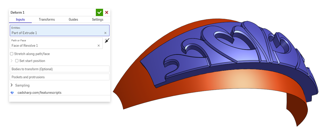

 CADSharp & RENDERCAD have sponsored a new custom feature:
Deform
It deforms a parts and surfaces via profile sections or lattice grids along a path. Useful when you need to bend, twist, and scale parts after they have already been modeled.
Note: It is still a work in progress but I think its good enough for first release.

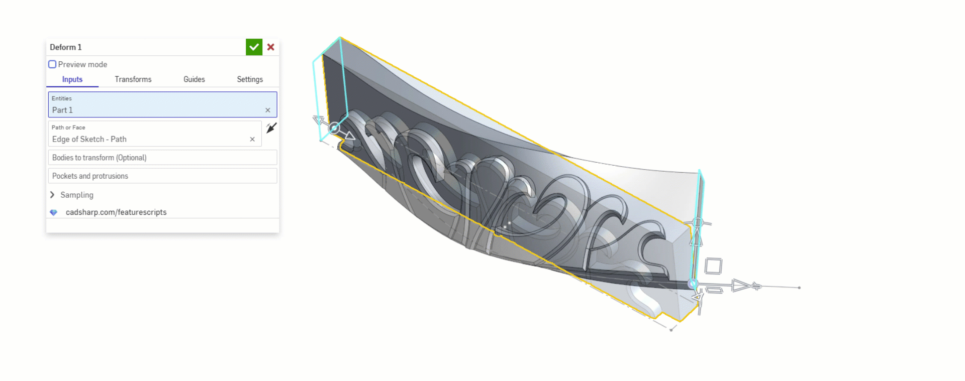

@Derek_Van_Allen_BD It seems to do ok with main body protrusions but has difficulty with small protrusions and pockets or large pockets.
Almost got the acanthus leaf test studio to work and then it digressed again and looks like it does now.
Either way, this is at least a starting point (or a black hole) and the closest thing I've seen so far to a full deformation feature.
