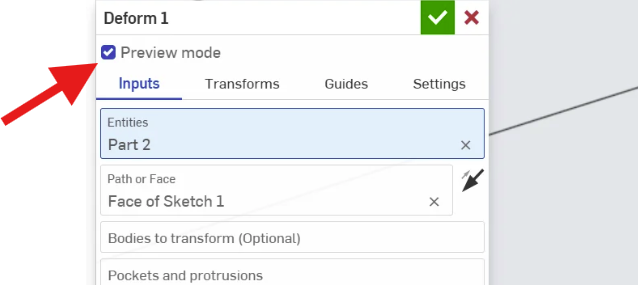

    mehmet_ali_canpolat Member Posts: 3 ✭
    First of all, thank you @MichaelPascoe for your contribution to the onshape environment. I have an issue about this feature, I am getting this message whilst performing this feature below;
    any idea to solve that problem?
  • Nameorus
    Nameorus Member Posts: 56 EDU
  • MichaelPascoe
    edited October 19
    the black box is an approximate deformation so that you can use manipulators to adjust before you commit to waiting 5 minutes for the feature to calculate.
    when you have adjusted the black box to the general deformation you like,
    then uncheck preview mode like @Nameorus suggested.
    gpt must have generated that hint. I should re-word it to "Preview mode: ACTIVE"
