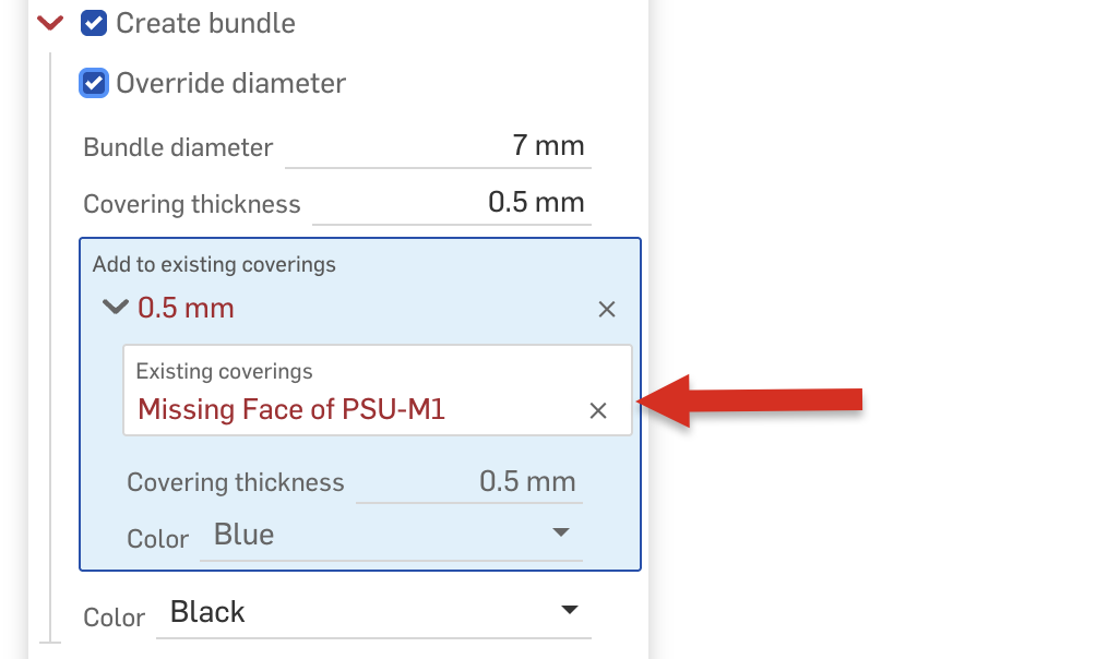

    Changelog for release 1.221
    ⭐️ Fixed bug preventing clip directions from being flipped
    ⭐️ Fixed wire length bug on single routes with "Follow first route" enabled
    ⭐️ Fixed numerous bugs in all areas to improve robustness and speed
    ⭐️ Modified how cable and bundle diameters are defined
    When adding wires/cables to existing bundles, the bundle diameter value has now been replaced with covering thickness (since you can only add to the existing bundle diameter). This may require existing coverings to be reselected.
