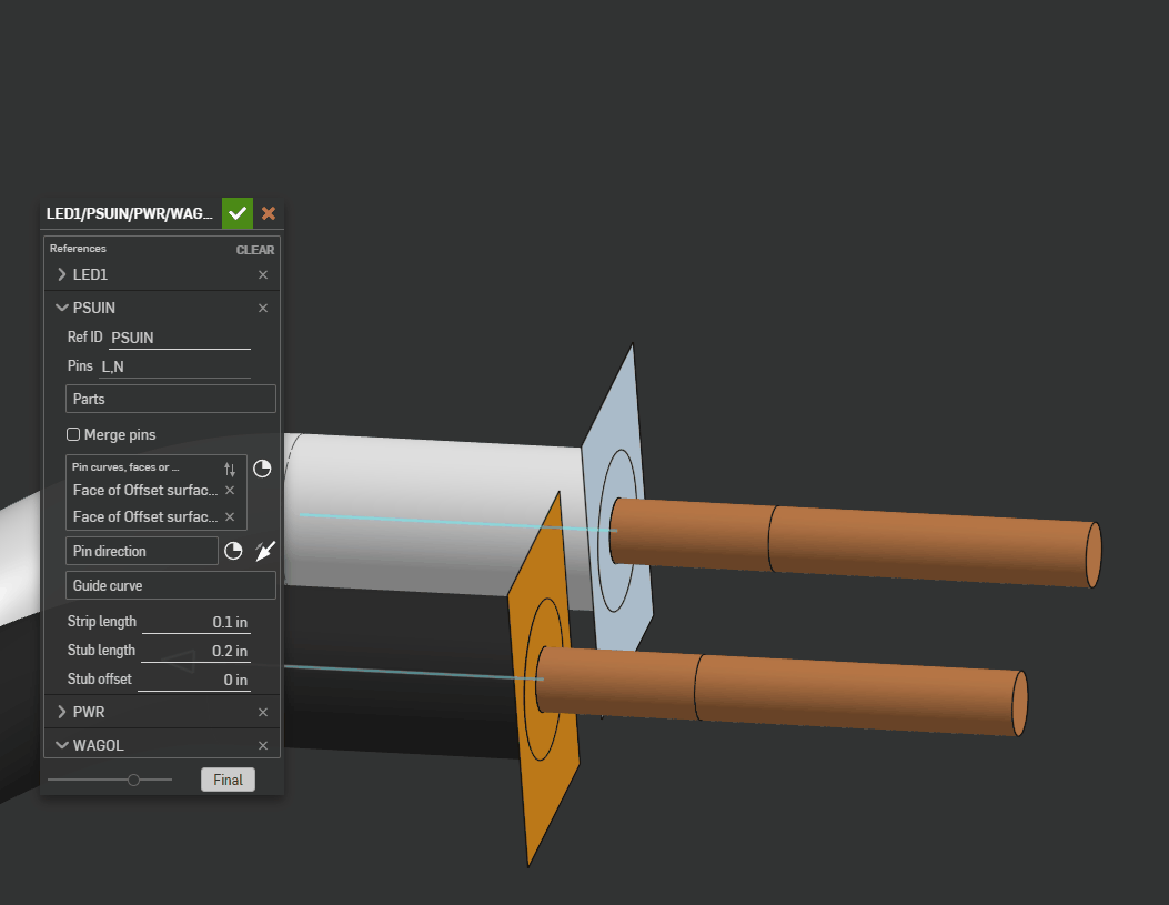

    Still working on resolving this, I just realized that the extrudes for both stripped ends are created on the same end of the wire. Also a strip length set to 0 causes an error (extrusion fail in the console).

  • NeilCooke
    @eric_pesty thanks - I did encounter that recently and fixed it in my test examples - let me look again.

    I'm also having the same issue, but it looks like you are on it. If it's helpful info, the extrudes both appear on the "To" end of the wire

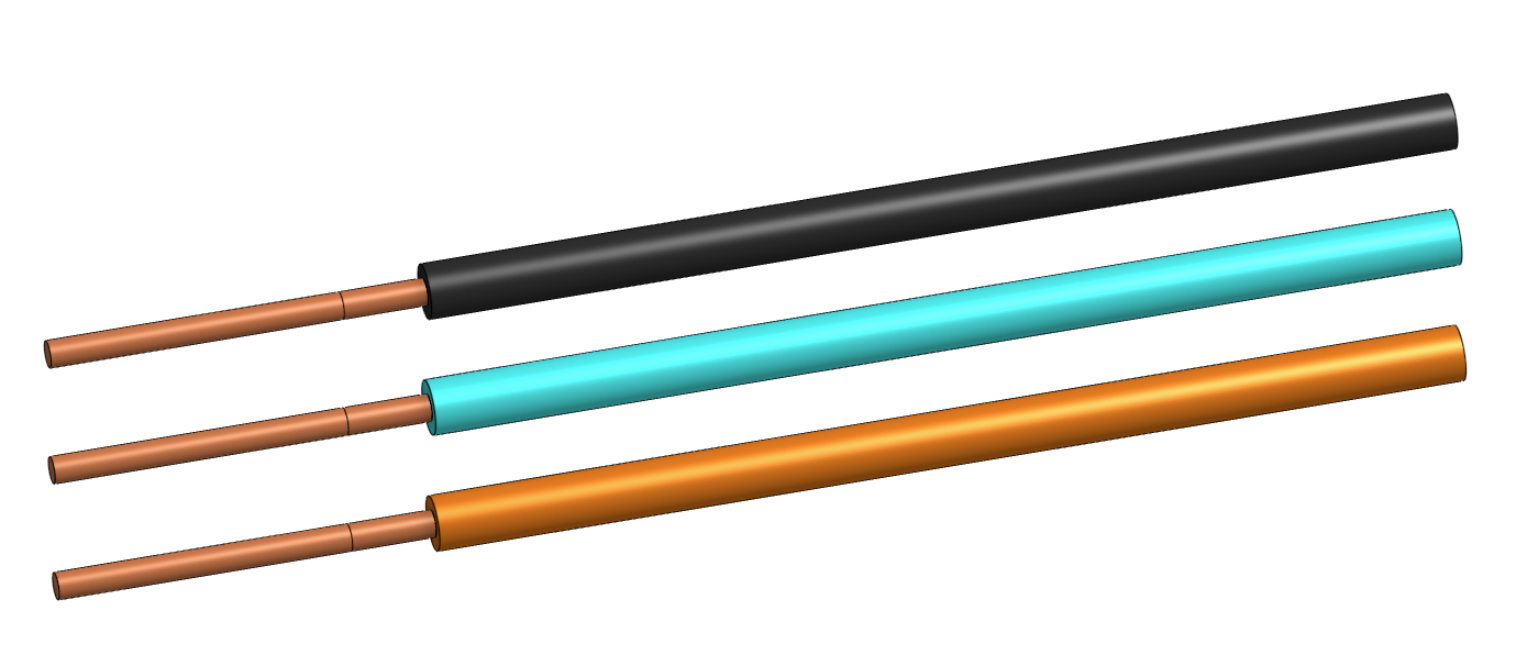

    @eric_pesty @Matt_NC I have just pushed an update to fix the stripped end appearing on the same end of the wire - the logic that was there for years had no right to have ever worked, but now it should be fine.
    @eric_pesty The "connector requires library update" is a catch-all. In this instance, your WAGO connectors are essentially splices (or daisy-chained connectors with more than one wire attached) which is not currently supported. I did mention it in the video but did not point out that this also includes splices. I am currently working on this, but it is a challenge.
    I also fixed the zero length strip value which ended up being a typo in a variable name.

    Thanks for the quick update, the stripped ends are back where they should be!

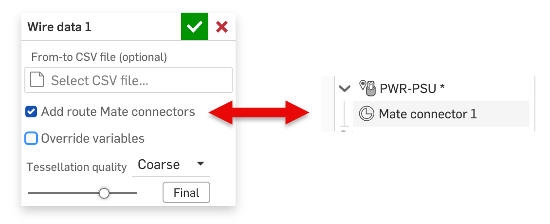

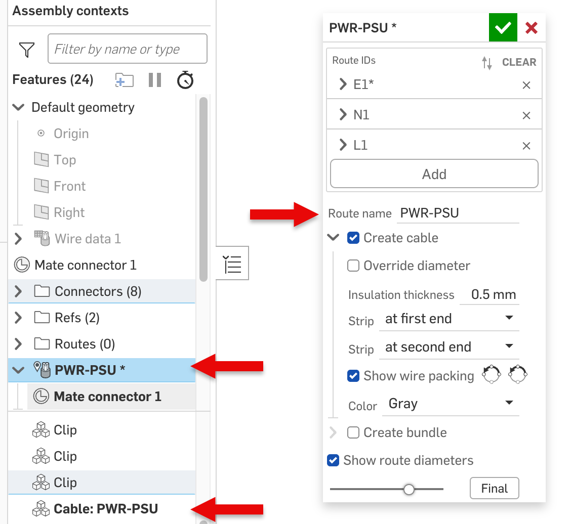

    Changelog for release 1.220.0
    ⭐️ Added Mate connector option for each route in the Wire data feature to make it easier to position individual wire routes in the top level assembly.
    ⭐️ Renamed Cable name field and moved it to the feature level to override Route name in all locations.
