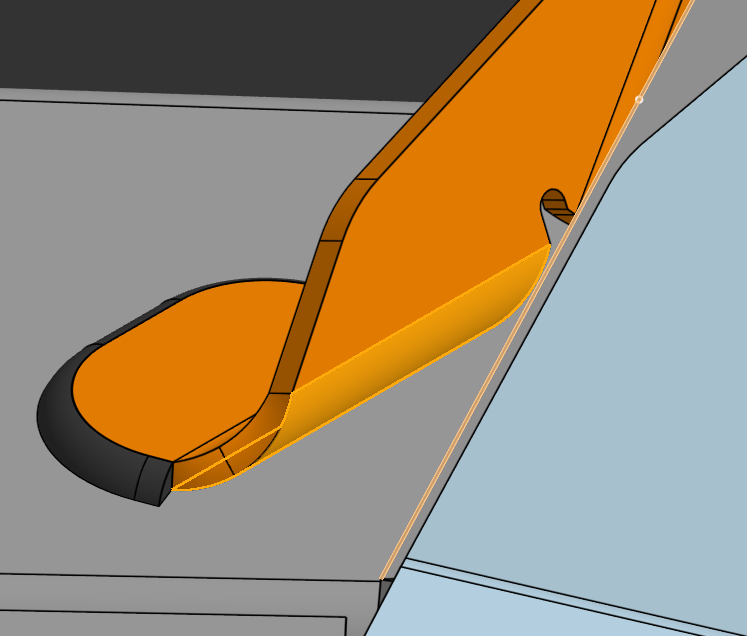

  • HARDWOODFP_ENGINEERING
    HARDWOODFP_ENGINEERING Member Posts: 42 PRO
    I love this feature! It`s really well done.
    The only think I`s add is the possibility of using a cilindrical face. For exemplo if I want to weld a planar face into a filleted face, like in the picture attached.
