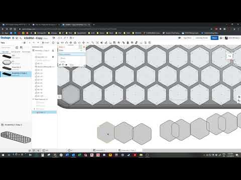

    Check out the "replicate" feature in the assembly.
    The icon looks like a lego brick.
    Also I believe you want a slider mate not a revolute.  (Unless I'm missing something the shape prevents rotation.)
    Cheers, Owen S.

    It didn't like replicate..
    it gave 300+ parts stacked on each other and with broken mates.
    I would recommend using a pattern and suppress the unneeded parts.
    Otherwise mate each one individually if you need independent movement.

    I tried to replicate and Onshape got confused with the truncated fillets etc. It basically glitched from the topology and gave me over 300 parts all with broken mates.  It also took a couple of minutes to calculate. So I would avoid it with your geometry

    I was assuming the fillets were part of the replicate error.
    because there are some instances where the hex cut out is not completely within the top face (see  image below)
    If you want the hex pieces to float independent, then you will need to replicate or manually mate.
    Replicate is nothing more than a quicker way to copy a part and one mate to some geometry.
    The result of manually mating will be the same in the end. It is all a mater of effort.
    A pattern as I have shown will make all the parts move in unison, and is far simpler to edit if you add/remove hexes, or change the face geometry by adding or removing fillets later on.

    The mate connector will try and divide up the faces/edges of each part as you see it in the assembly. Then it gives you an option to select one of thoes reference points.
    If you make a change to the geometry, and it deletes the geometry you referenced. Then your mate will break.
    So it is best to completely finish your model before assembling it. (As much as possible to keep up with design deadlines etc.)
    Otherwise you may end up fixing mates over and over.
    When you have fillets upsetting the face you are mating to as shown in the image above. That is concidered a very volitile face to mate to.
    A small change in anf fillet radius, or the hex size could break many of your mates.
    At that point, you may want to mate to a layout sketch instead of the final geometry.

    You will need to "insert" the honeycomb sketch into the assembly and mate it (group mate most likely) to the honeycomb part.
    then mate each hexagon part to the center point of each hexagon in the sketch

    I don't think replicate will work with a layout sketch.. at least I haven't had luck with it.
    But this will give a nice large target to mate to, which is unlikely to change with model updates. So it is by far the best practice in your situation.
    It helps if you copy/paste a hand full of parts at a time, then mate them all up pressing shift+enter before confirming the mate.
    Here is a quick video showing how quickly this is. Replicate would be nice, but unfortunately you will need to do this manually.
