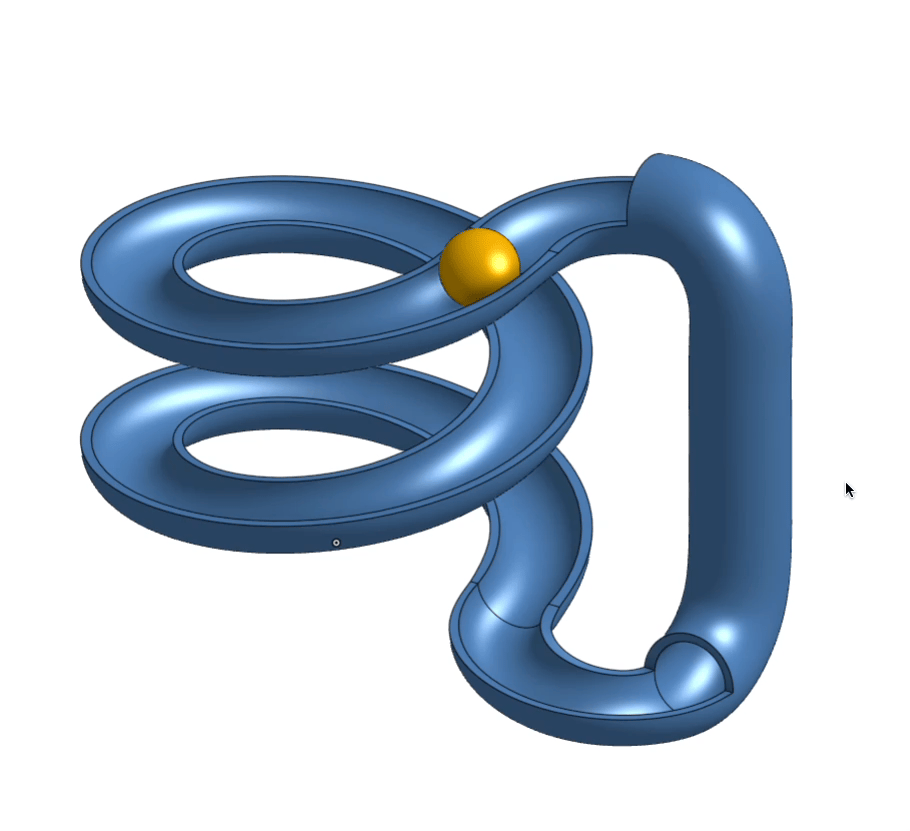

I am trying to make an infinite marble track. My goal is to have a ball roll down a spiral then roll back up.

    you can make it tangent (tangent mate -although Ive never tried to mate a sphere..?) to your track, and then drag it along.  No "gravity", or interference although they would be nice.
     Don't think animations are a focus for the OnShape team right now.

    What you can try is a slider mate if you are ok with the ball not looking like it is rolling

    @zelig_medsa … make it yes….. animate it, a bit more challenging!

    There is an older thread in which I demonstrated a rolling ball:
    https://cad.onshape.com/documents/71fc008d9243a885635708b5/w/0cf8076d68a685a48318f84d/e/d594d6ffb37f162ea7ea0e58
    That was on a stright guide, though, but the mechanism that makes the ball rotate could be adopted.
