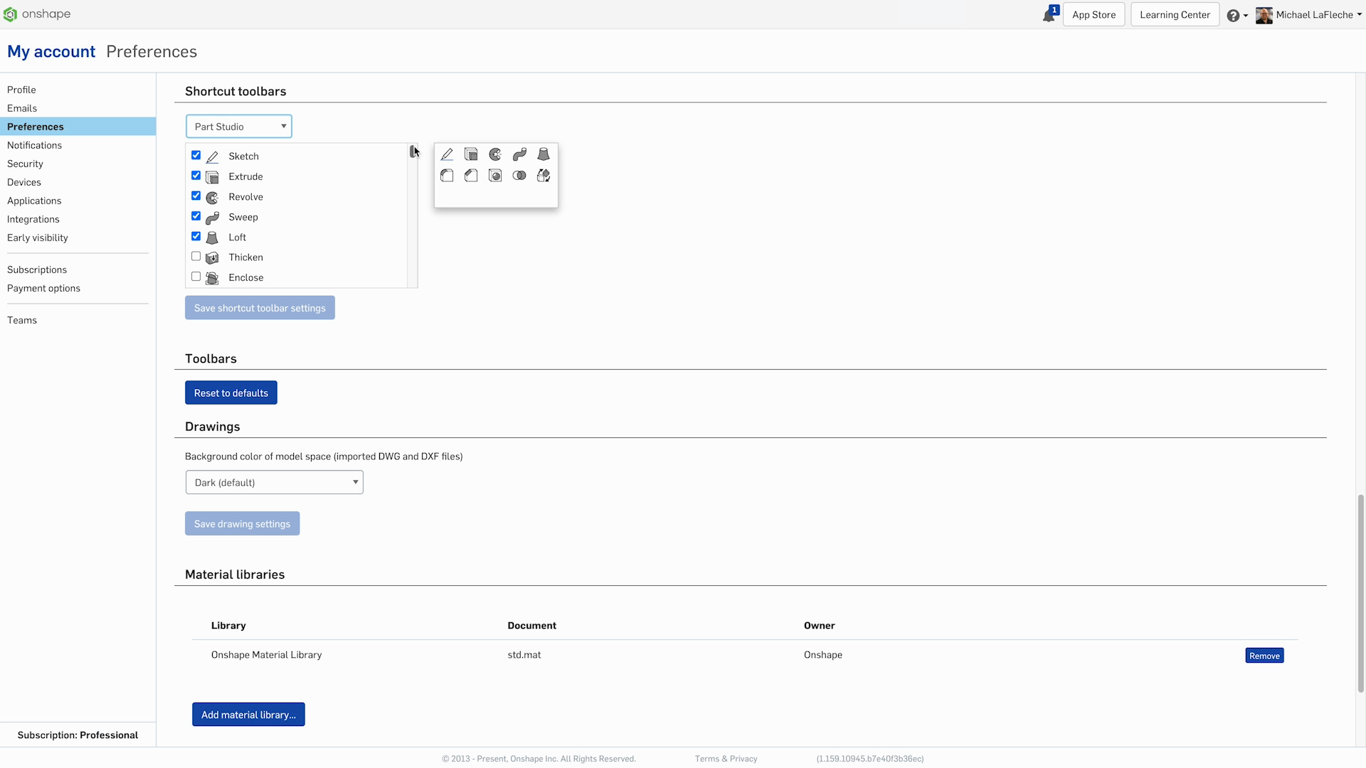

    About the only thing you can do at the moment is add a subset of the custom features to your shortcut menu.
    Improvements to Onshape - February 3rd, 2023 — Onshape
