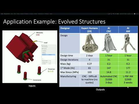

    Using a lot of Generative Design at NASA using Fusion 360. Hope OnShape puts forth a good offering. Here is my ASME talk for reference. We've come a long way since then, especially with Generative Design for CNC. https://app.webinar.net/YJ1a6DYBMzl/on-demand

    I have been building and testing many Generatively Designed parts using Fusion 360 for NASA. They are primarily CNC machined.
    We can go very quickly from requirements to parts. 10x faster and structure performance is ~3x better.
     See: https://youtu.be/t_h_WmBhRXA?si=1nWZR1Ffi4qGfzP2

    @Ryan_McClelland nice presentation, I watched the whole thing. Question, how did Fusion end up with the best generative design (I assume that's your opinion)? Fusion is Autodesk's low end product. I'm just curious.
  • Ryan_McClellandRyan_McClelland Member Posts: 36 PRO
    I've benchmarked every tool I know of, and Fusion's is the best for our needs. It is the easiest to go directly from requirements to manufacturable parts, even for very complex design problems. They have just invested more into it. Otherwise, I don't use Fusion for general CAD. I often create the preserves and obstacles in OnShape before setting up the problem in Fusion (step import).
    Fusion has a robust algorithm, doesn't require a starting design, allows for remote mass representation, has CNC machining constraints, and robustly creates a BREP CAD model, not just a tessellated solid.
    I can't wait to see what OnShape comes up with!
    Thanks! The CAE industry is experiencing rapid innovation these days. We now have a system to design structures such as those in my presentation with a text description only, input them to an algorithm, and output CAD and FEA analysis. We are using a low-code tool called Synera.
