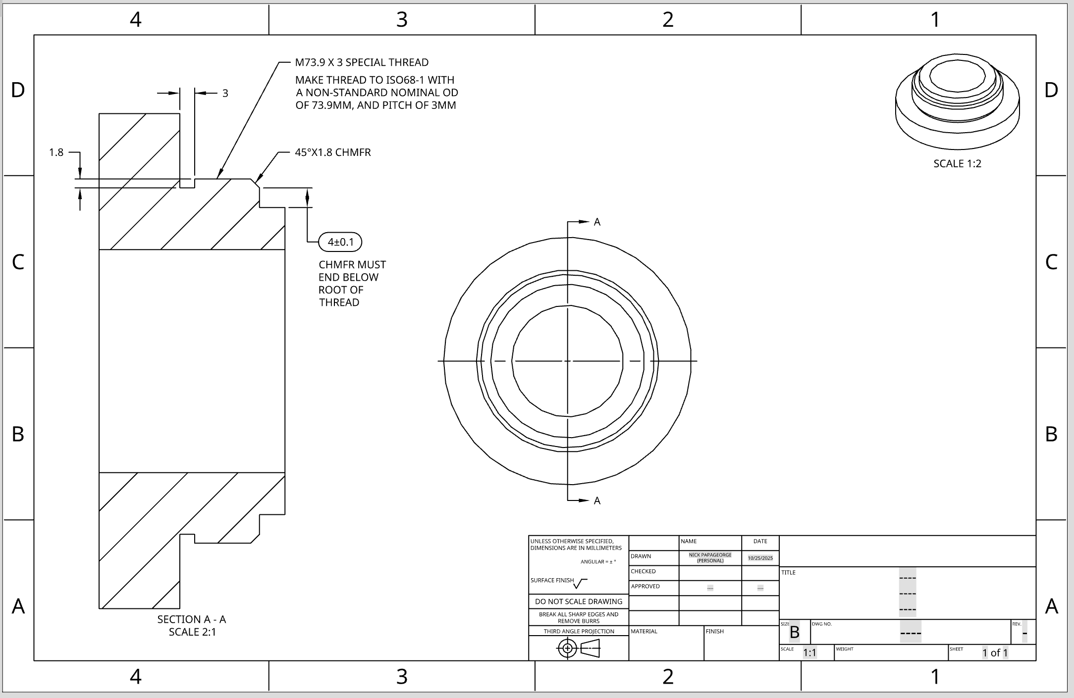

I'd do it like this. And I'd communicate with the vendor on the phone/email/website your thread and chamfer intention.
The OD of the thread in the model is drawn at 73.9. The thread depth of a 3mm pitch thread is 1.62mm, so the chamfer and the thread relief are both drawn at 1.8mm depth to get under the root of the thread slightly. The only thing missing is the class of fit. Class of fit is often left off the drawing, but since you are making a bastard thread, you might want to look into it and include it. You can read more about metric thread profiles here: https://en.wikipedia.org/wiki/ISO_metric_screw_thread
That said, I'd recommend redesigning your part to use a standard thread. Bastard threads are the whole reason thread standards exist today.
The more I think about this, since it is a bastard thread, you might get a part back that doesn't fit the mating piece. How are you making the mating piece? You're asking for trouble IMO.

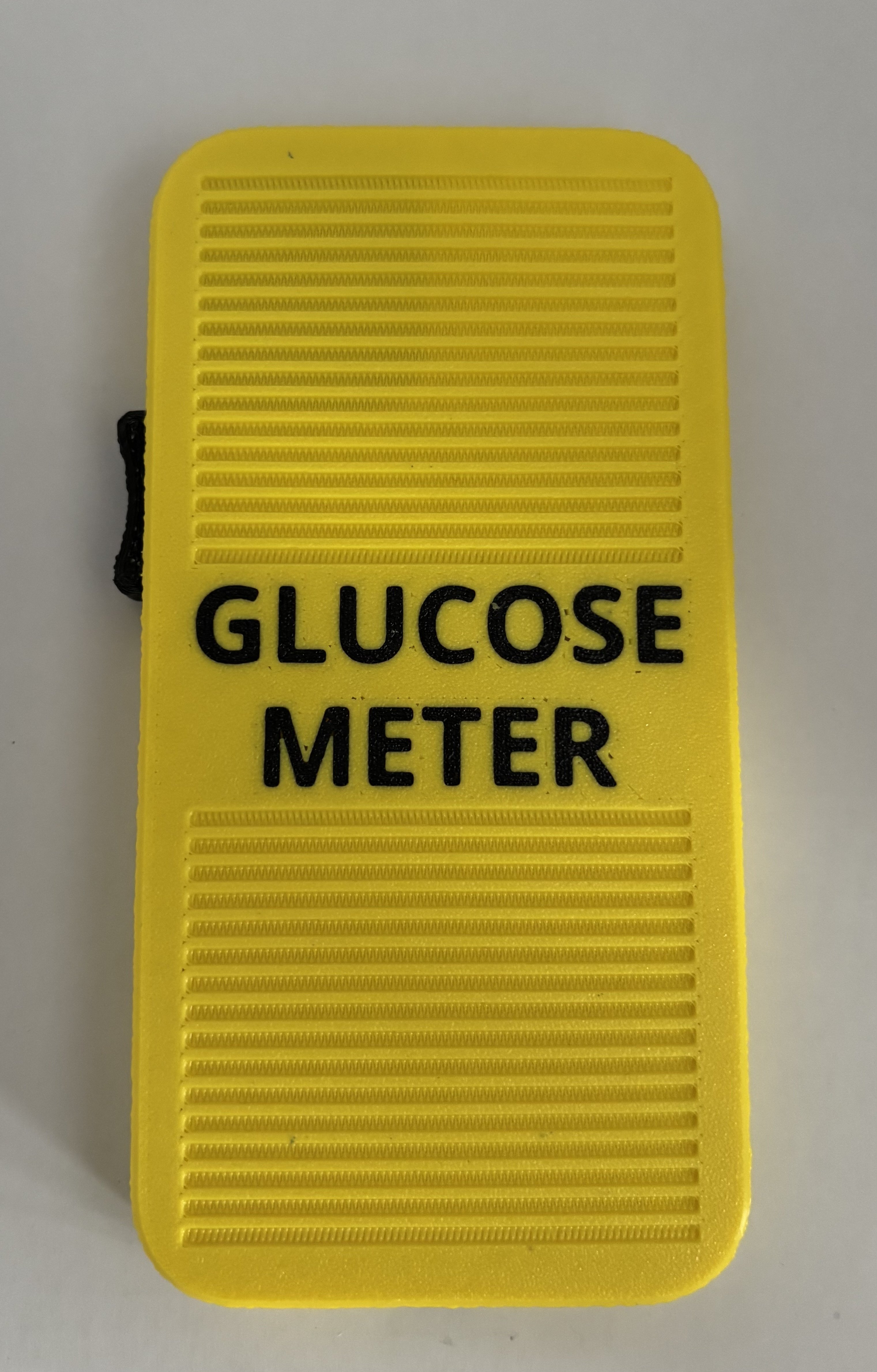

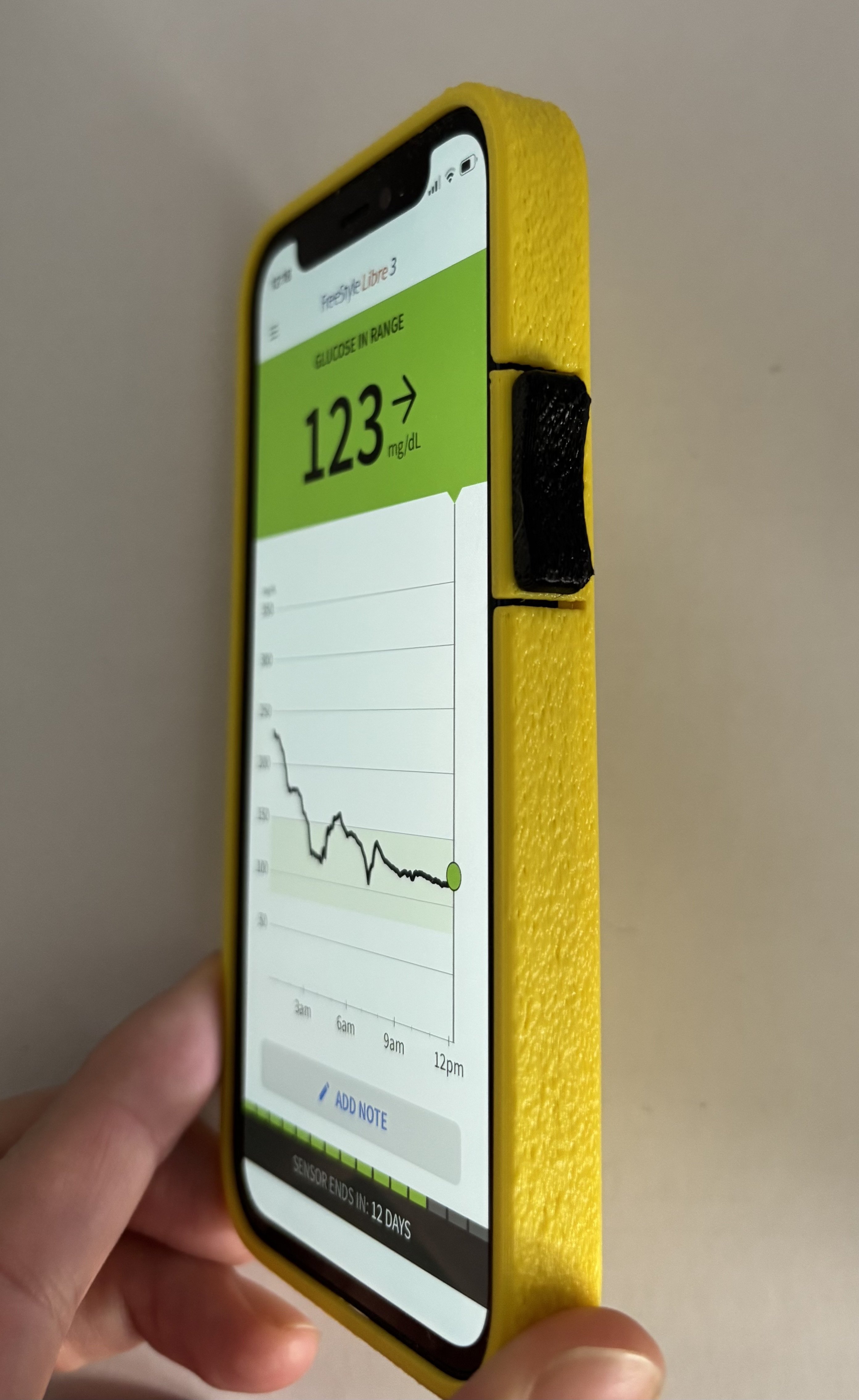

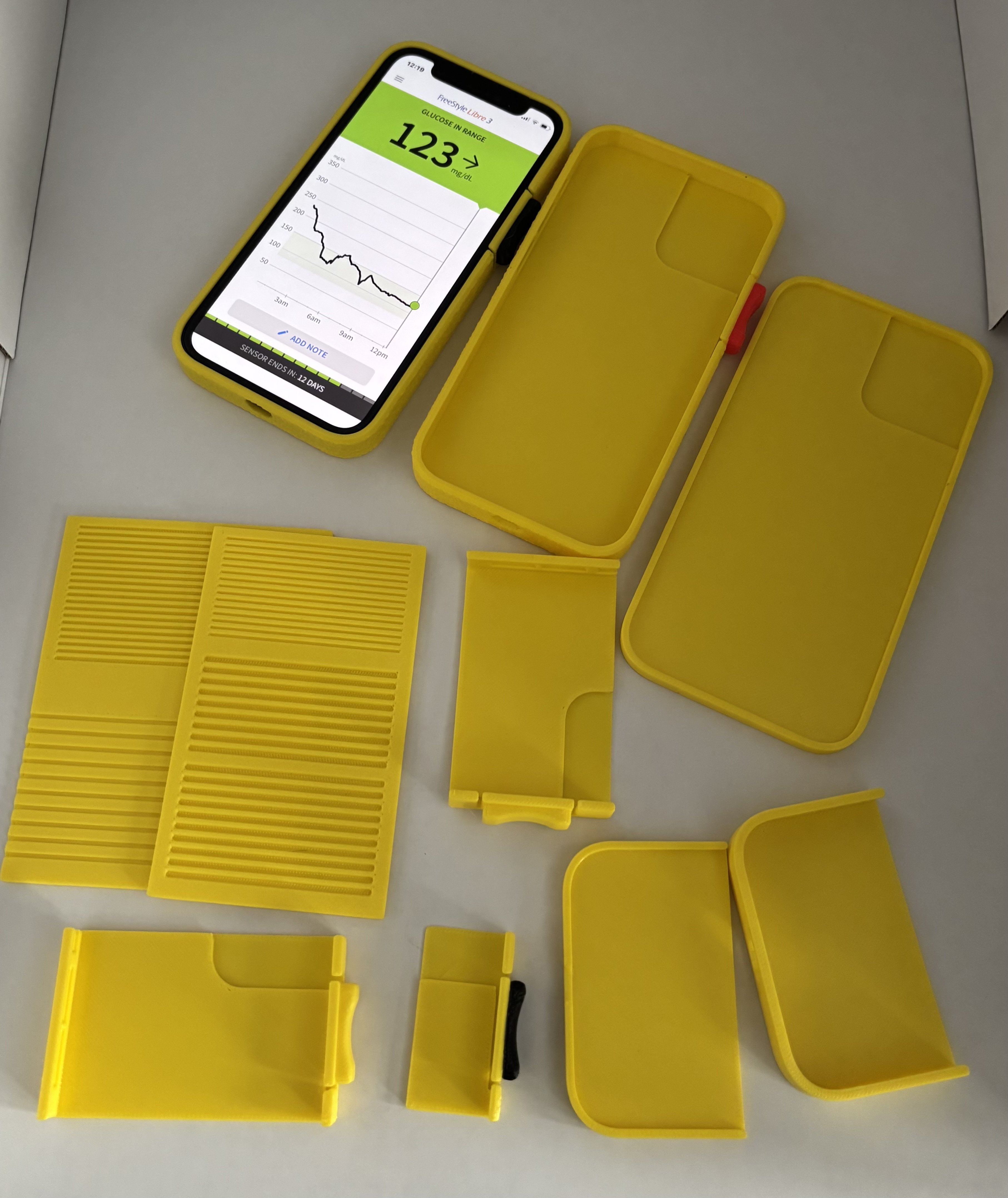

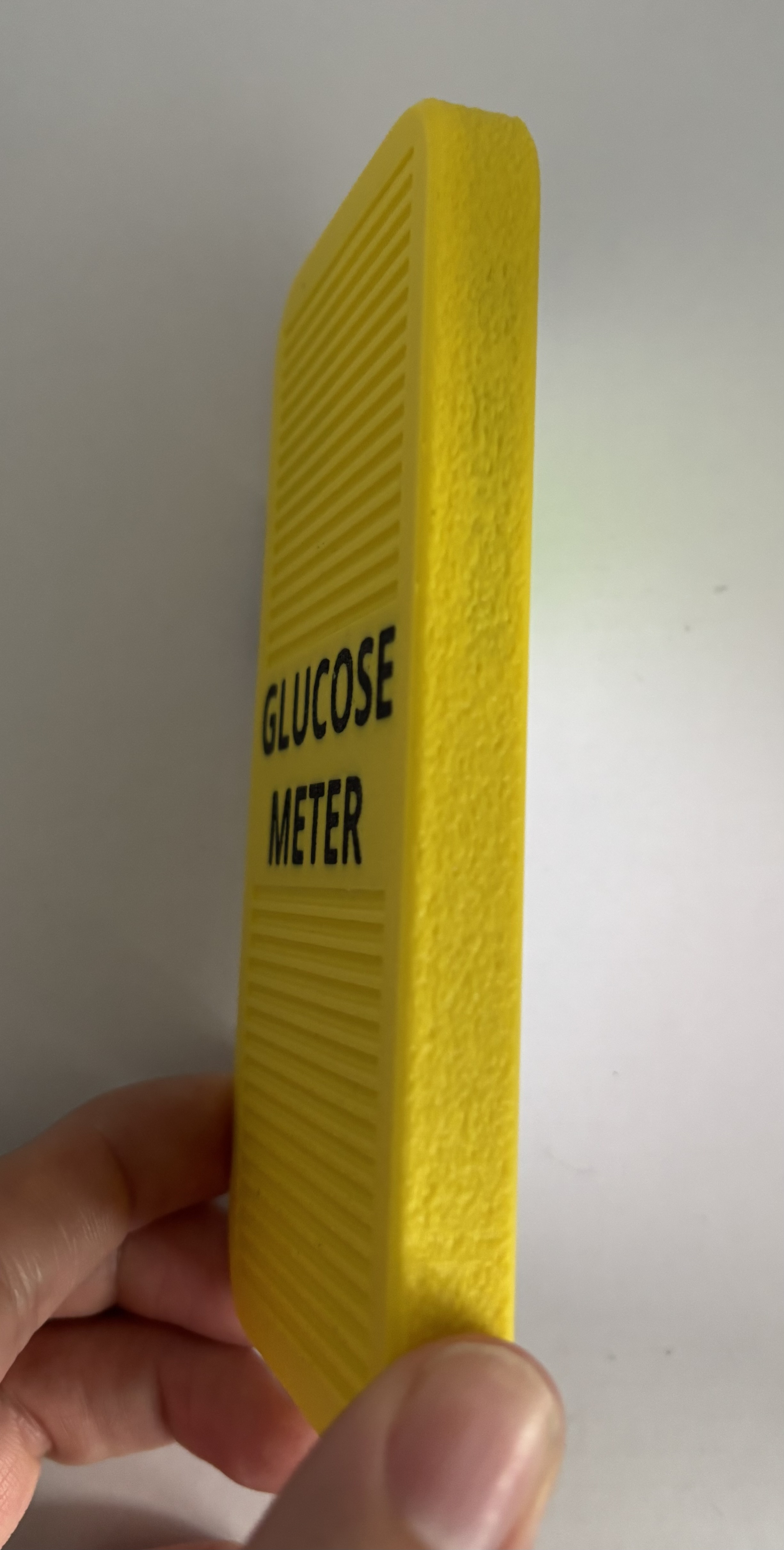

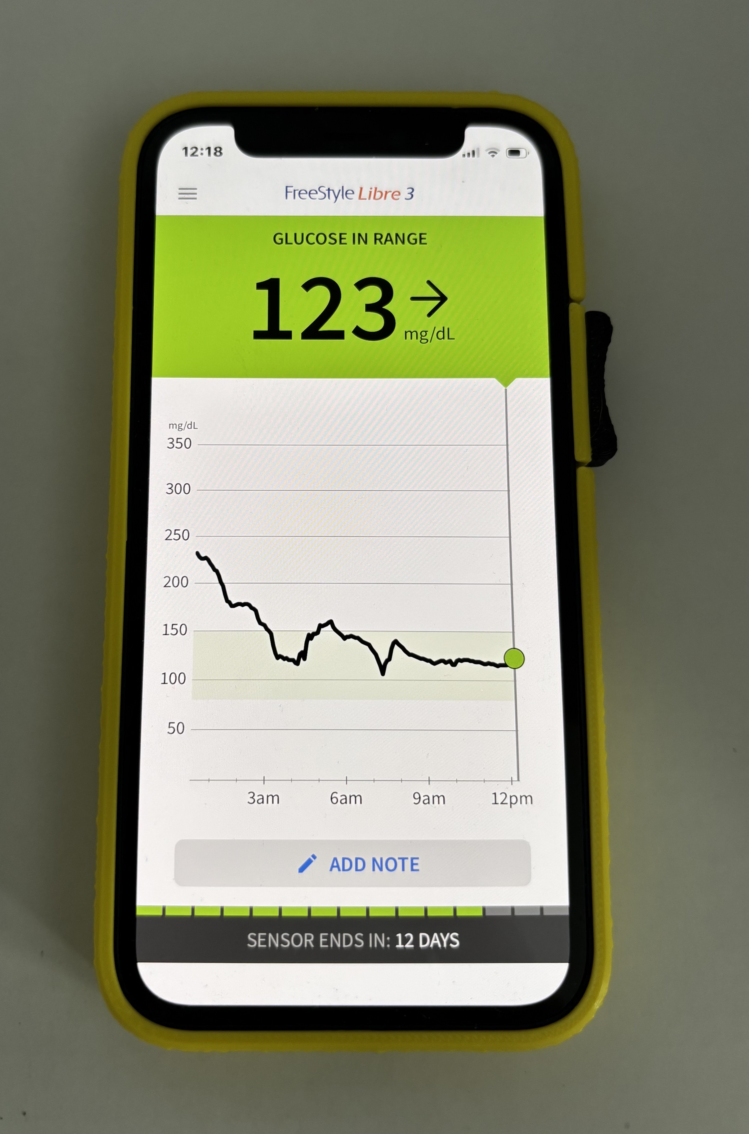

I switched my dad to a new glucose meter that is phone based. The phone in normal mode is too difficult for him to use (he's 91 and has memory issues). I made a case for my old iPhone 12 Mini with only a singe button, and programmed the phone so that when that button is pressed, it shows his glucose level, and the button doesn't do anything else. All the other buttons are blocked.
Link:
https://cad.onshape.com/documents/d374847f1f65f74720caca79/v/a66e4541502ea9045e2dd60f/e/c09557342429defa31403ec6
Grooves added to the back for a non-slip surface. Text added as it doesn't function as a phone if anyone comes across it. Also for dad as he forgets what it is sometimes.
Fuzzy skin added to sides for better holding.
Button works on a living hinge.
