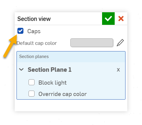

You need to enable "Caps" in the section view dialog.
A few notes when using this.
Caps use a fixed diffuse appearance of the specified colour (you can have one colour for all caps, the default, or change per cap). You cannot use a specific appearance on the caps.
If your geometry sits on the ground and you have the ground turned on then you'll want to adjust the ground height a little or the model height a little so they are not perfectly aligned since this will interfere with the section plane.
Coplanar geometry will confuse the capping mechanism and potentially make it looks like you can see into the model still. In those case very slightly overlapping the geometry will usually fix the problem (you can apply transforms in Render Studio so that you don't need to change the Part Studio or Assembly.

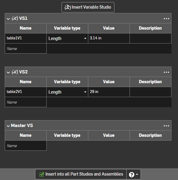

One thing you could do is to move it a different variable studio (i.e. duplicate the variable studio and delete what you don't need) but "insert" it in this variable studio. This way you don't edit them here but you can use them from inserting just this one variable studio in your parts/assemblies.
Basically you can create a bunch of separate variable studios and insert them all into a "master" variable studio that you insert where you need it.

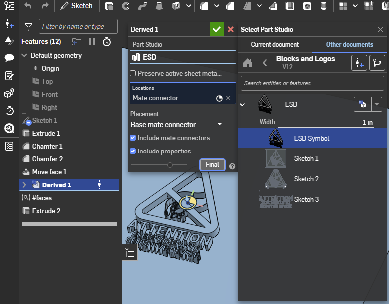

It would help to understand what you are trying to do as there might be different workarounds depending on the application…
For logos, my preferred workflow is to create "zero offset" surface(s) and create a closed composite of that. I typically include a configuration variable to scale it to the desired size. Then you can derive it in at the desired size and extrude or whatever the faces of the composite. If the logo has a lot of separate elements, using a query variable might be worth it to use for an extrude. (and the "Query variable +" FS allows importing query variables so I would definitely do that going forward!)
If you are looking for moving things around at the conceptual level, you can create assemblies of sketches and use mates on these.
Here's an example:
