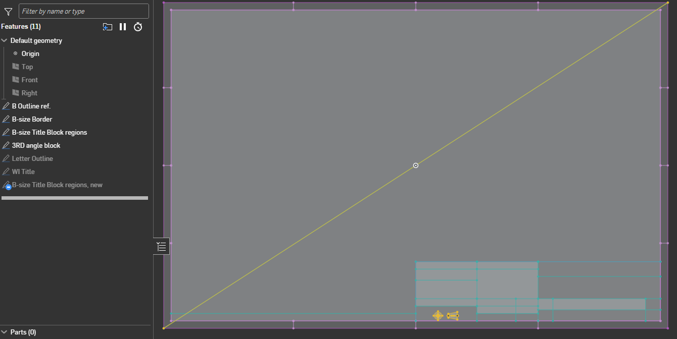

    I throw in a diagonal line in the sketch that locates things nicely in the drawing template (bottom left at zero, zero) and delete it after importing in the drawing.

    I was surprised to see you had a whole drawing title block in your sketch in a part studio. But now I see why.

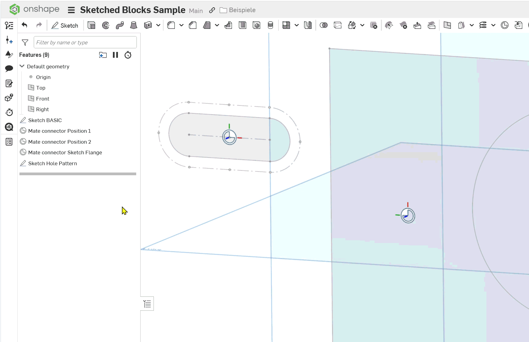

  • martin_kopplowmartin_kopplow Member Posts: 1,303 PRO
    If I plan to move sketched geometry around, I usually sketch on mate connectors. These can then be used as reference points to align or otherwise manipulate these sketched 'blocks', even in 3D, which traditional sketch blocks would not allow.
    There is one thing, though, that I miss: The ability to use the built-in OS transform tool on the MC. The lack of this limits the possibilities to editing the mate connector's coordinates manually, without any of the useful helpers like 'translate by line' or ' any method referencing existing geometry, let alone constraints. If we had this, I'd be completely fine without sketch blocks.

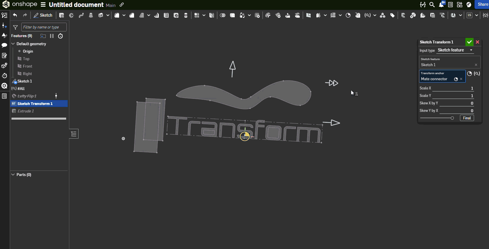

  • Derek_Van_Allen_BDDerek_Van_Allen_BD Member Posts: 836 PRO
    edited February 16
    So it turns out you sort of can use the opTransform functions in Onshape's featurescript to do sketch manipulation but it comes at the cost of stability for complex regions and doesn't support decals. It's probably why they don't have a sketch bodies input in the default transform feature. I was able to vibe code a buggy feature in 5 minutes to prove the concept but it has regions which become invalid for the later extrude operation in the tree.
    Here's the doc if anyone cares to get invested in making it a better feature than my non-attempt. Personally I'm sticking to resolving my geometry as surfaces before doing other stuff with them because it's more stable.
