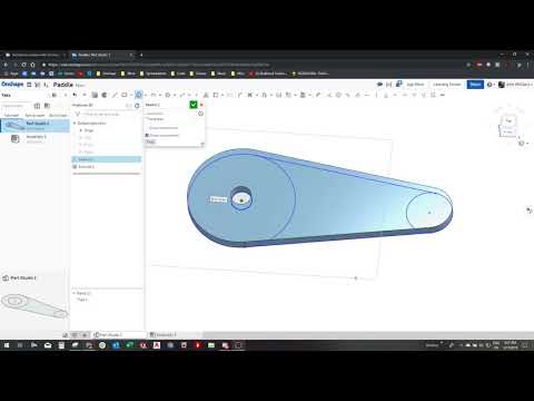

    I suppose it depends on what skill the teacher is trying to show you.
    From the first image it looks like you want to start with a piece of material, then cut away the paddle from it.
    In that case you are almost there with your sketch, you can do an extrude command with the intersect option, using the paddle sketch as the master.
    But to be honest, for this it is far simpler and more true to how it would be done normally if you were to skip the square block and just extrude the original sketch.
    It doesn't appear obvious at first because the entire shape is dark gray, which usually means that is the area to be extruded.
    but when you have another "closed area" within a larger closed area, it becomes "negative" which will not be extruded, hence the free hole.

    I start with the circles, then create lines coincident to the circles, then use tangent to smooth them up.
