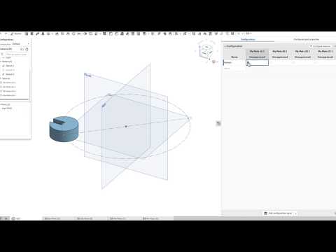

    @Fda
    Is this how you expect it to work:
    https://cad.onshape.com/documents/1002ce69245ea445611e4980/w/f52429a498b020c73540b506/e/08e27852c7e1888489504652
    I did a couple things:
    1) I switched `moveFrom` and `moveTo` (as I mentioned a few comments up, but forgot to do when I copy-pasted your examples later)
    2) I added a qSketchFilter in "B" to stop the sketches from moving.
    3 ) I deleted C and D, since A and B represent the two options I am trying to show you.
  • Fda
