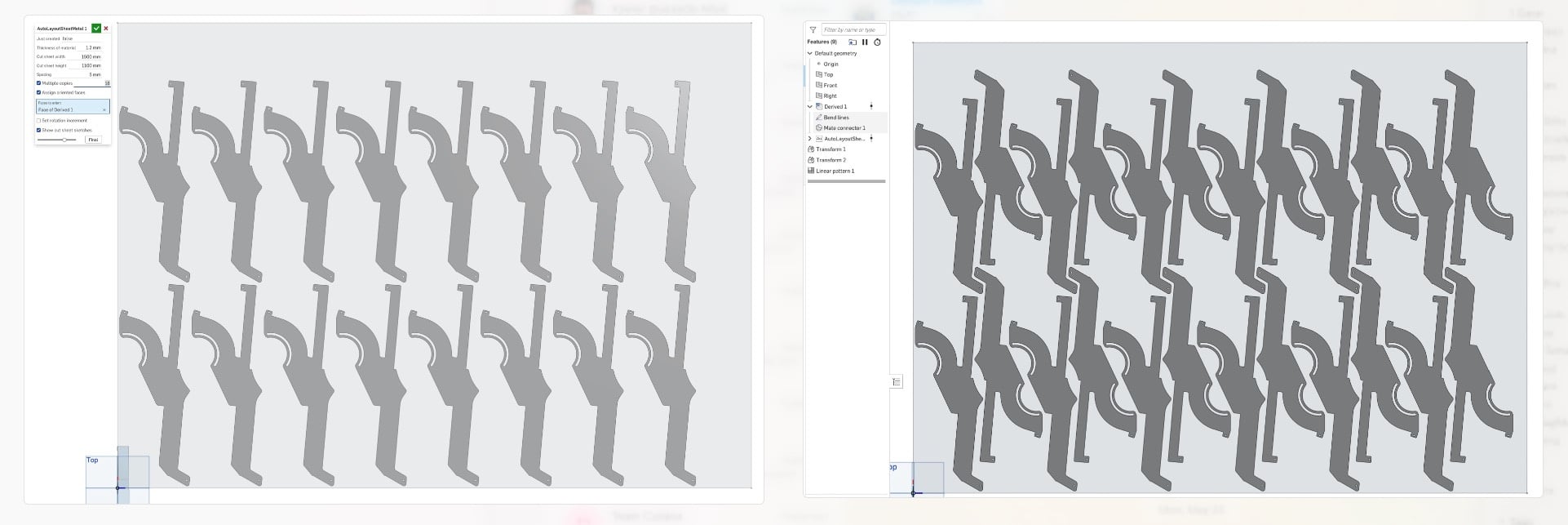

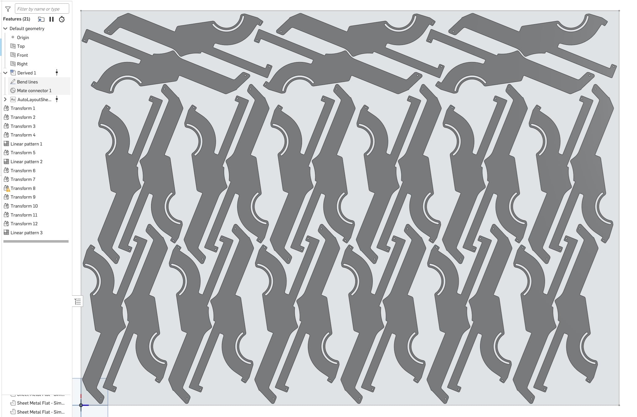

  • hoolito
    hoolito Member Posts: 55 PRO
    edited June 16
    This is indeed awesome! Thanks @lemon1324 and also @eca_elioac refactor very handy.
    I think the real strength of this feature is arranging pieces of irregular shapes in a square surface.
    But what about multiple copies of the same shape?
    As far as I understood it, there's no option to clock a set of instances or offset them, right?
    That would be in order to make the packing more efficient (right picture is made manually with transforms)
    Am I right that the FS doesn't can't produce a more efficient layout than the left picture?
    Iterating once more, I brought it to almost double:
    Since I have insufficient FS knowledge to build this myself, I'm throwing the idea to the community of how I would replicate this algorithm in a custom feature:
    A user would procedurally "stack" geometric operations on the fly within a single feature dialog box using an expandable array panel.
